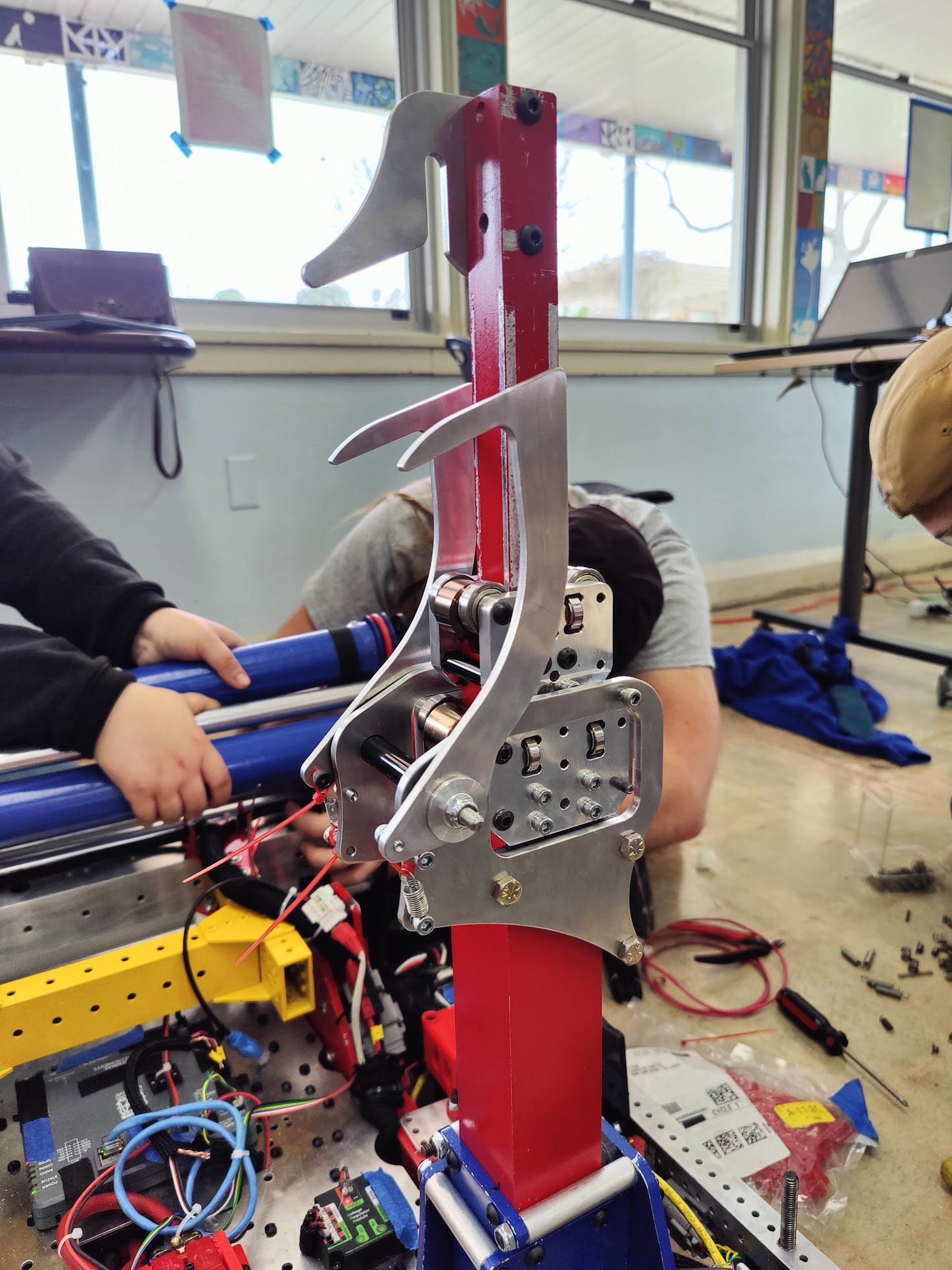

Very interested in this latch mechanism you are mentioning :eyes:

Hook brings the chain down, the latches on the non-moving stage of the elevator are spring loaded and rotate out of the way when the chain is pushed down into it, then once the chain is past the latch, it snaps back over it, and holds it from going back up.
