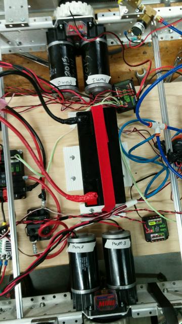

This is a picture of our test. Hopefully you can make out the controls.
