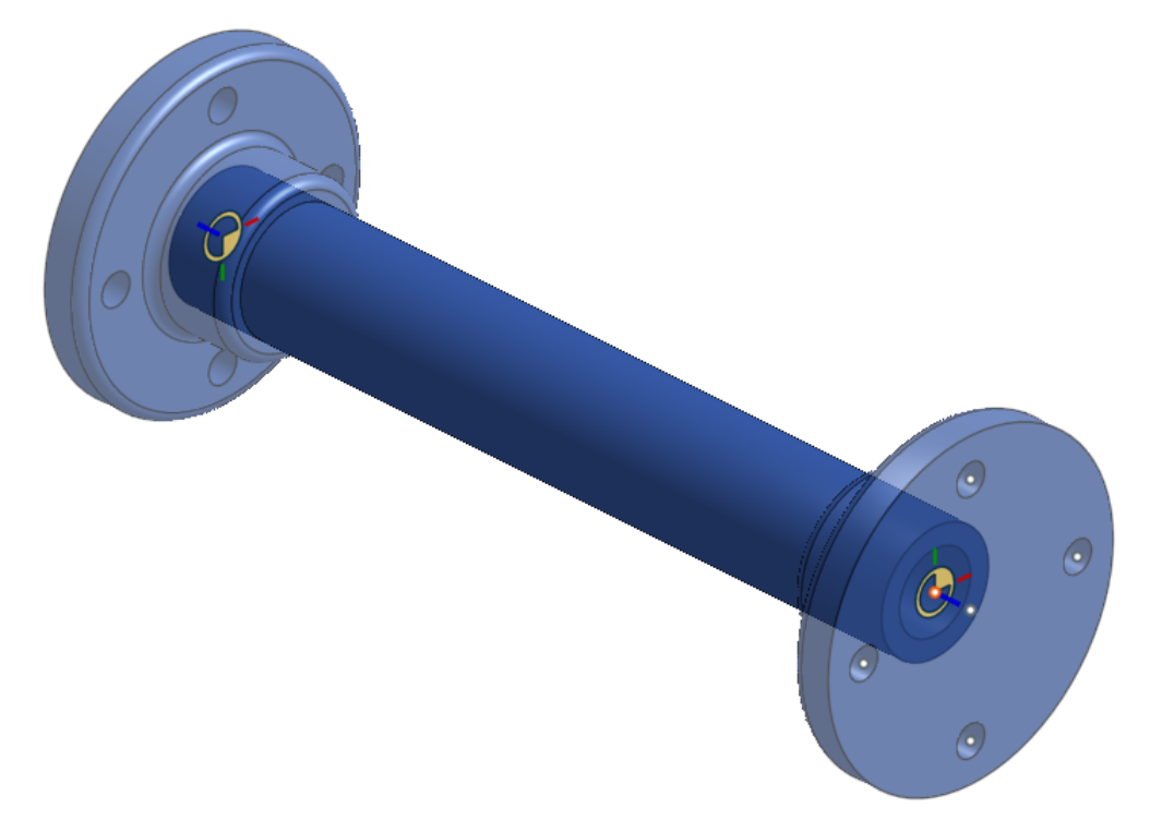

The Point derive feature is a powerful variant of the Onshape Derive feature which allows users to specify locations when deriving parts. Point derive also automatically converts mate connectors attached to parts which are being derived into selectable points, making it easy to derive and use standard components.
A part studio using Point derive to derive two pipe fittings:
A pipe fitting set up to be derived with Point derive:
