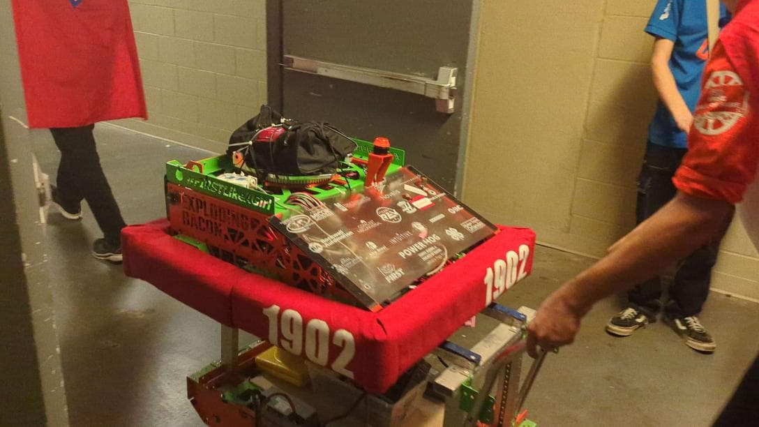

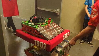

1902 through quals and elims match 1 of Orlando:

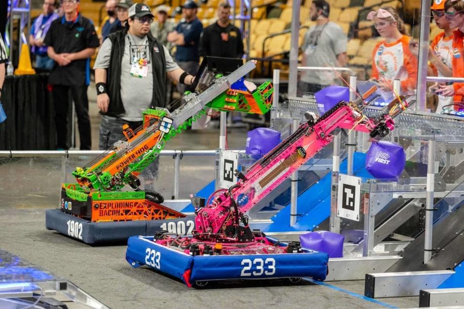

1902 through the rest of elims in Orlando:
Before we selected 1902 we went to them and asked if they would be willing to remove their elevator and add ballast. We received confirmation they would from both their lead mechanical student and mentor in the pit (it is important to get both because sometimes the adult you talk to will say yes then you get upset students who have no idea there robot is about to get a brutal haircut, or sometimes you get enthusiastic students who just want to get picked and mentors will say they can’t/don’t want to due to something in that system being way more complicated to reattach/make work for their event that starts the following week).
We went to several teams asking them how much they weighed, would they be willing to add ballast or remove components, or ziptie something to no longer move. Some people were like 1902 and were 100% whatever we asked. Some were ok with adding ballast but not removing components, and others were not ok modifying at all. We didn’t try to sway anyone from their choices and we adjusted our picklist based on the robots that those teams were willing to field.

After a selection is done we do a deeper dive into the alliance partner and we have never gotten any pushback or people upset at us for either re-routing wiring (you can see 1902’s radio was on their elevator so that needed to be moved) or just using a liberal amount of hot glue on their electronics. It is about 50/50 on us asking for this or doing it ourselves and it has always been up to the team in question who does it. We have also had teams ask us to help them revert their changes after elims and so long as the venue is not upset (we are always done well before the field is done being broken down) we will accommodate.
