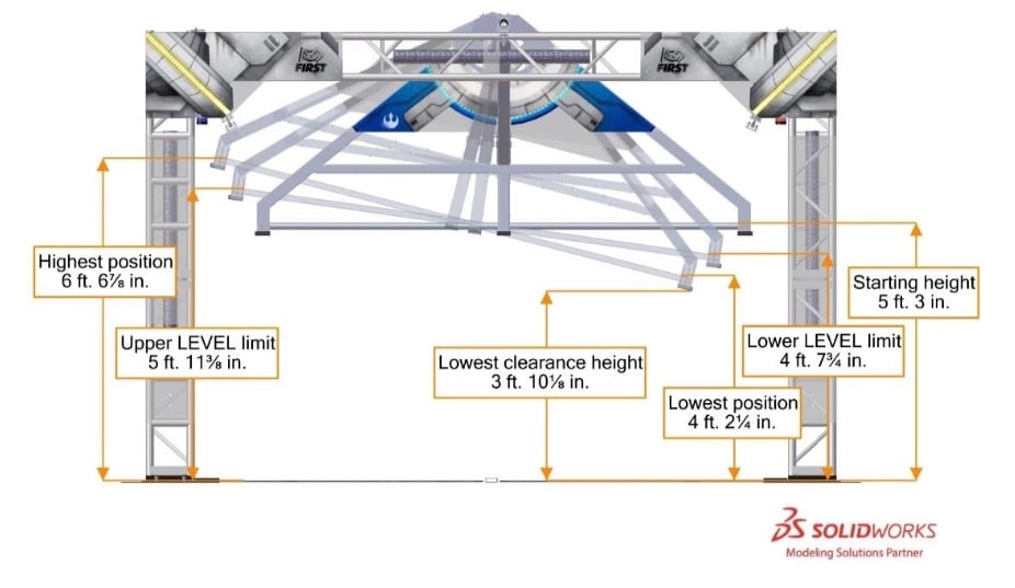

We are trying to come up with an alternate way to build a field element for climbing. We do not have a permanent place to store the element as designed.
Our field build team would like to ask if anyone can share the high and low points of the bar and angle for the Field Generator grab bar? Big Thanks!
Page 16 of the manual. Max off balance is 14.5 degrees from horizontal.

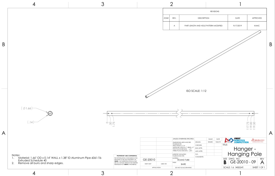

What is the actual field spec for the bar? I know the practice field is for steel.
I haven’t found it yet actually. Looking at past field setup guessing extruded alum. tube but don’t no for sure. It will make a big difference if you plan to move or even stay in place if bar is tilted.
The field uses Sched. 40 aluminum pipe, 1-1/4" nominal, so it’s the same 1.660" od and 0.140" wall thickness.

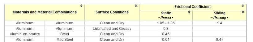

And this is why it might matter.
That’s what i saw when I read the manual (section 3.3.2).
Doesn’t that mean if you practice on steel it will be harder for your robot to stay still (assuming you have an aluminum mechanism)?
Probably harder, almost certainly measurably “different”. That might be good or bad, depending on what your team considers hard.

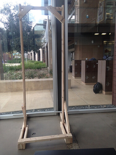

OP, I’m planning to recommend local “low resource” teams use the back side of the shooting goal for climbing practice, with the 3 heights & angles you’ve suggested.
See if you can link up with a higher resourced local team to try to dynamic balance, but you don’t “need” your own to get 95% of the way there.

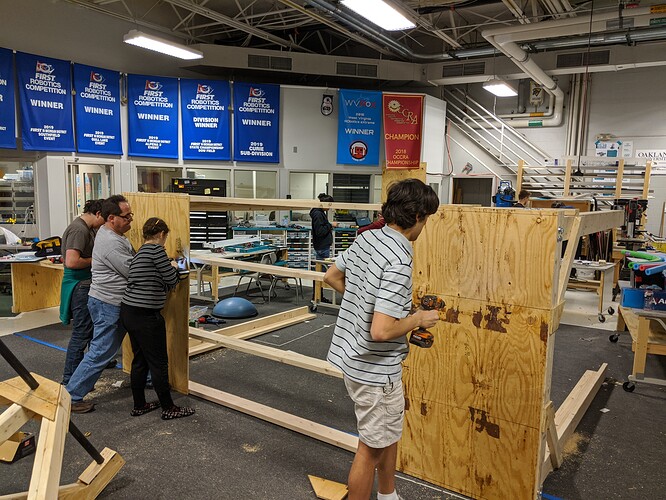

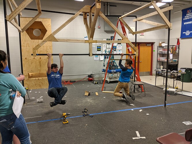

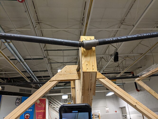

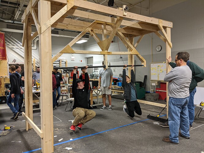

Slightly off-topic since it’s the opposite of what the OP is looking for but we built two alternate configurations, let me know if you want any more details. We thought we were being clever with the pipe version, but it broke exactly where you might expect. So we scraped it and built a wood version.
[Edit: Uploaded images here directly…]
Google Photos Album
You’ll need to change your Goolge Photos settings for those to show up to allow public sharing / anyone on the internet to view

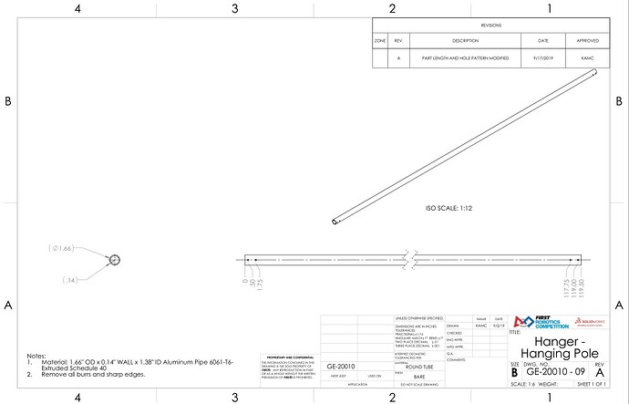

Just to confirm the pole material on the “real” field drawings, it’s aluminum, Sch 40, 1-1/4" nominal.
It’s also defined in the game manual:
From the Arena section 3.3.2:

We made an alternative adjustable climb element for prototyping (it has various holes at the right locations on the side planks, and we stick the aluminum bar in the back through them):

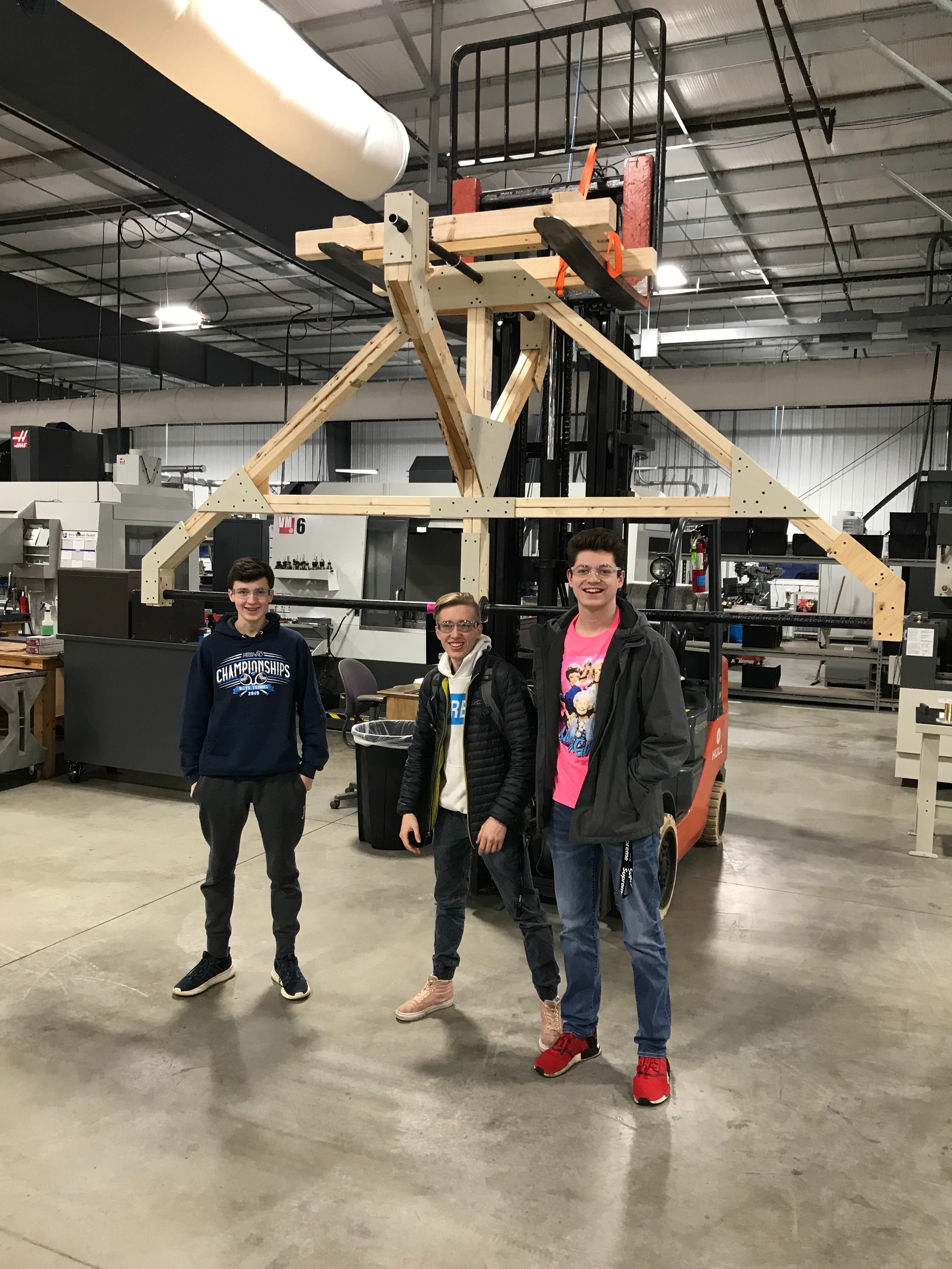

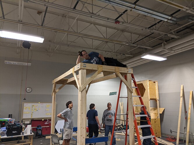

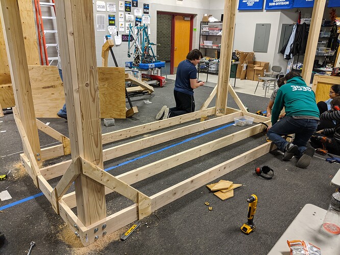

We went a little different direction on the generator switch.
We build at a local manufacturing company, one of our major sponsors. One condition of this set up is our utilized space has to contract at the end of build time to allow for their daily operations. The shield generator is BIG. To minimize our footprint we decided to not build the entire structure. We have enough carpet to replicate one half of the field, this year we have it set to 15 x 60 and roll it in every night, we park the switch next to the carpet to practice our climb.
