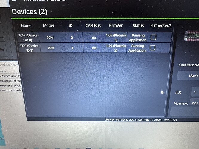

After quite a bit of testing, I think we need to replace our pressure switch for our compressor to turn on. We manually tested our system by connecting it directly to the 12v battery and we were able to confirm our system holds air, all gauges are working, and we can manually fire our pneumatics cylinders. One we connected to the robot using the CTRE pcm, we can’t get the compressor to turn on. We used the phoenix tuner and to update all firmware, we also updated the PCP and roborio. I think it’s gotta be the switch. Anyway, I am looking for a cheaper, quicker option than studica. 44$ plus 25$ to ship.

The PCM has to be sustantionated in code (or whatever the right word is.) Make sure than canbus address in code is the same as the physical one. WPLIB sort of assumes it is 0
Define at one soleniod variable to be safe.
Once the PCM is talking it the code. The compressor runs automatically. You can force it off by code, but you don’t have to.
