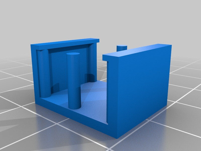

3D print them: Powerpole Retention Clip for 1327 Housing by qwertpas - Thingiverse

We tried 3D printing some clips last year but they were quite weak and easily broken, so they never made it onto a robot.

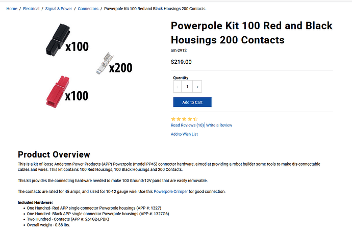

A similar kit (with 30 amp metal contacts instead of 45 amp) is 113$ at robobitz and it actually shipped faster to Texas despite being located in Canada than Andymark did.

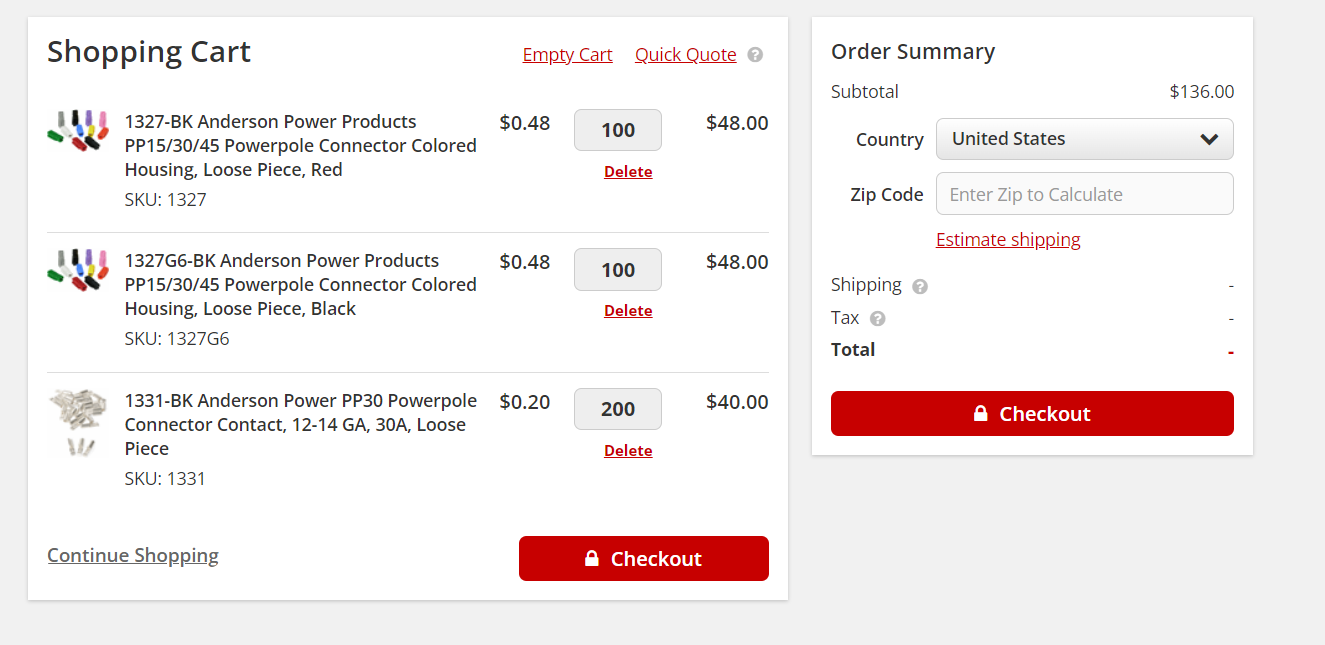

Where are you pricing those from? Buying from powerwerx is about 40% cheaper than that.
Those really aren’t that expensive when you consider the costs of what goes on our robots.
Price what it would cost for wago 221s. Or what a spool of 100 feet of pure copper wire costs. Or one kraken motor, or one neo with speed controller.
Their post with the price being referenced was a screenshot of AndyMark’s website.
Yikes.
Unless I’m missing something obvious, the housings are $0.48 a piece from powerwerx, and the metal connectors are $0.20. Much cheaper.

I’ll second the Powerwerx suggestion. We never buy the connectors from anyone else.
We 3D print our own clips.
We print these, we’ve used them the past few years. Made some in PLA and some in ABS. Specifically the file PP_Clip_90. We break those little pins off in the middle because they’re pretty useless but these do a good job at holding connections together
Their purpose in this design is to confirm that the connector is fully mated, not to provide strength.
(Edit: and they’re actually redundant, see below, I didn’t see the feature on the side at first)
We’ve done zipties and the injection molded ones, and the zipties will probably win this year.
I should have clarified better, but we do it because they’re so thin they bust immediately when we try and put the connectors on so we don’t worry about it. The grooves on the sides only lock in correctly if it’s aligned correctly, so not a big deal
