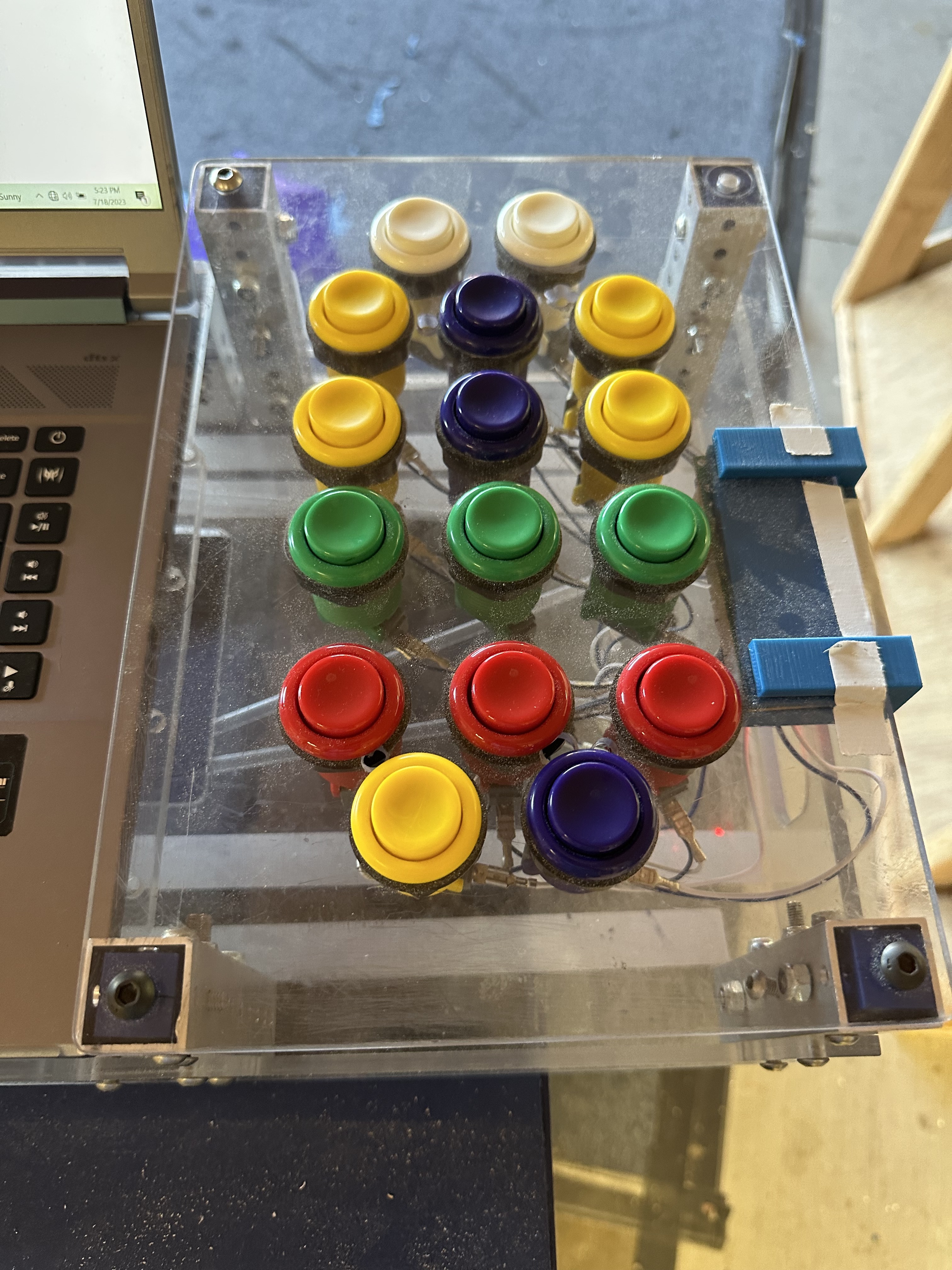

We used a generic USB Game controller connected to 30mm Arcade buttons bought off of Amazon.
Code linked here.

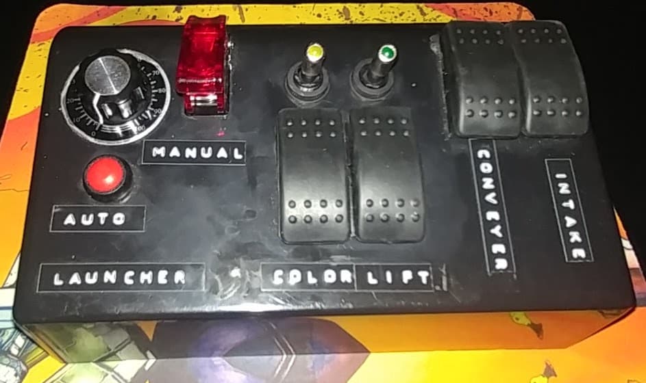

Game-Specific custom controllers can be fun to design/build. This one was for the 2020 game Infinite Recharge, and was our 2nd driver’s controller for manual/override control of our intake/launcher as well as the controls for our color wheel manipulator and end-game climber mechanisms.
This was built using an Arduino Pro Micro board emulating a joystick/gamepad. Here is the code for the Arduino, which is pretty simple, and the robot side is done the same as any other USB joystick/gamepad.
We also used Google Drawing to design the layout and eventually use that as our drill/cut template, just printing it full size and taping it on. Here is a PDF export of that document. (some of the labels are different as after playing with it physically it was found our driver preferred a few of the control placements swapped)

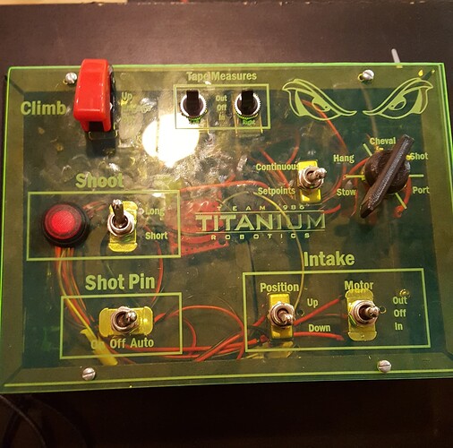

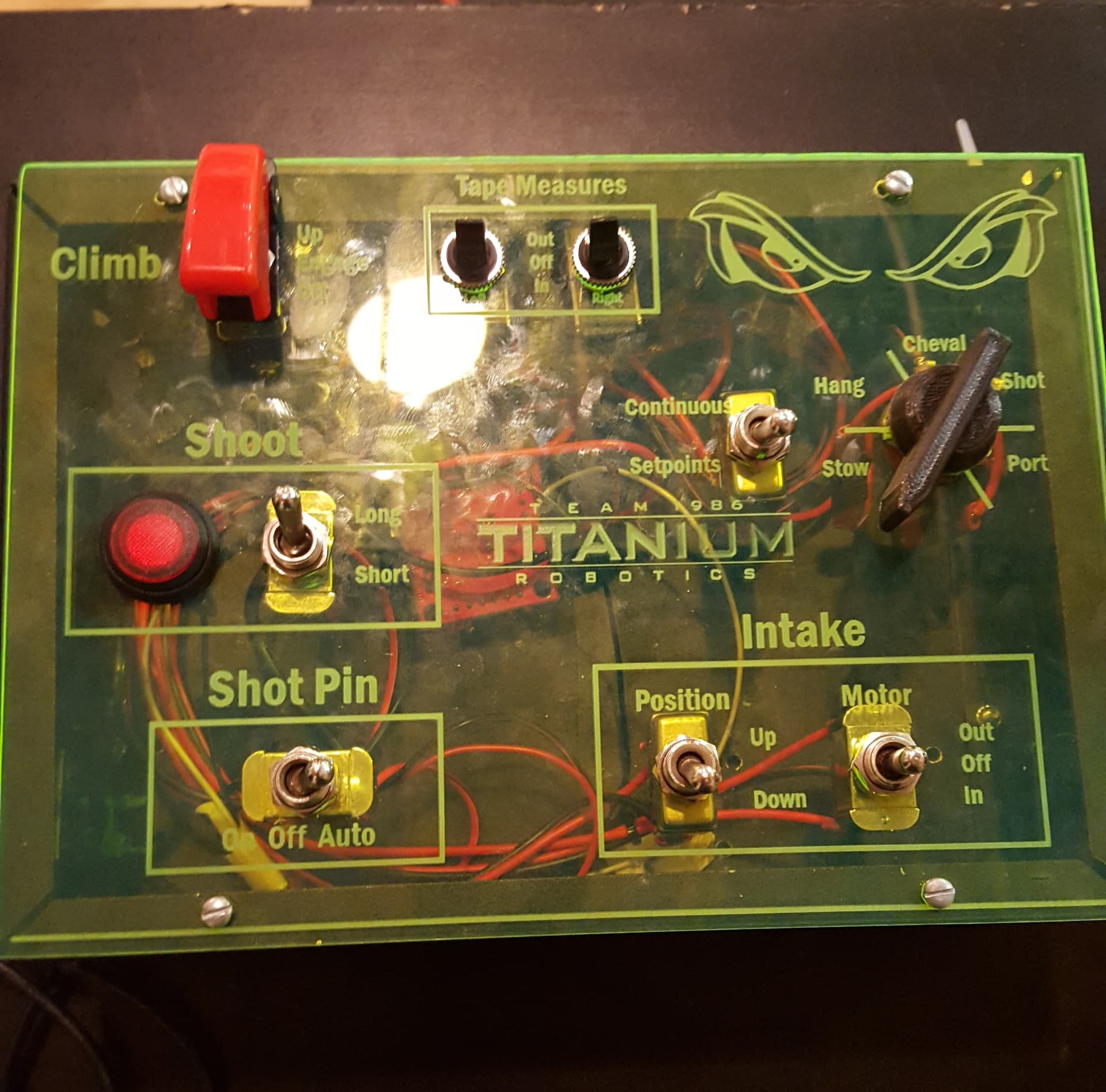

We used to use the CCI board by Estop Robotics (no longer in business) to make a custom control box each year. It worked as a USB joystick without any code.
This was the controller for 2016:
