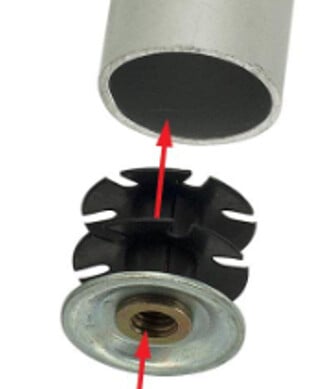

Do you want this kind of thing?
Yes, i am asking for an alternative of this.

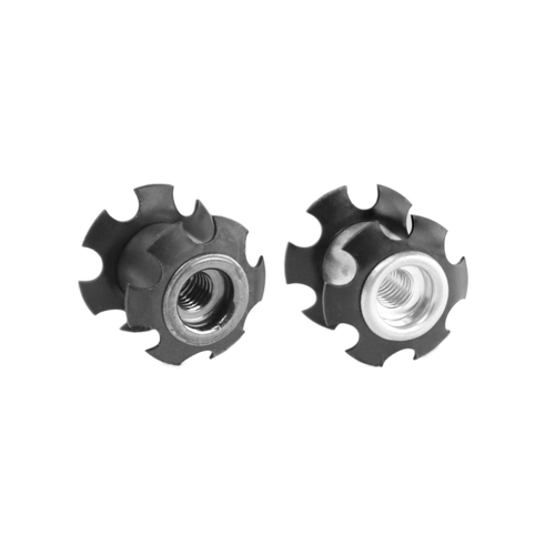

Can you place orders with Rev? They started carrying tube nuts this season.

They should work fine on a 16mm ID tube, is safely within the effective range. But I totally get that you would prefer a metric option, you’d have to mix in 10-32 bolts. And the shipping is less than ideal too.
I bet you’ll be able to find metric tube nuts on Alibaba, you may need to buy a lot of them though.
Of note is that this style is also known as a “star nut” which may also be a useful search term if you haven’t tried that.
Star nut is what they are called for bicycles and they are commonly used in the head tube of bikes using metric thread sizing. Have you considered trying a bike shop?

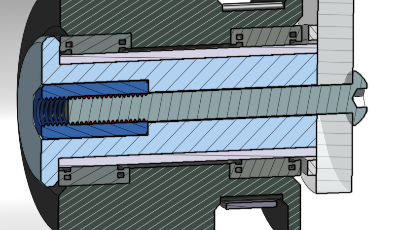

Depending on the application 3D printing a holder for the nut is an option:
No, but it makes sense. Thanks for the mention.
