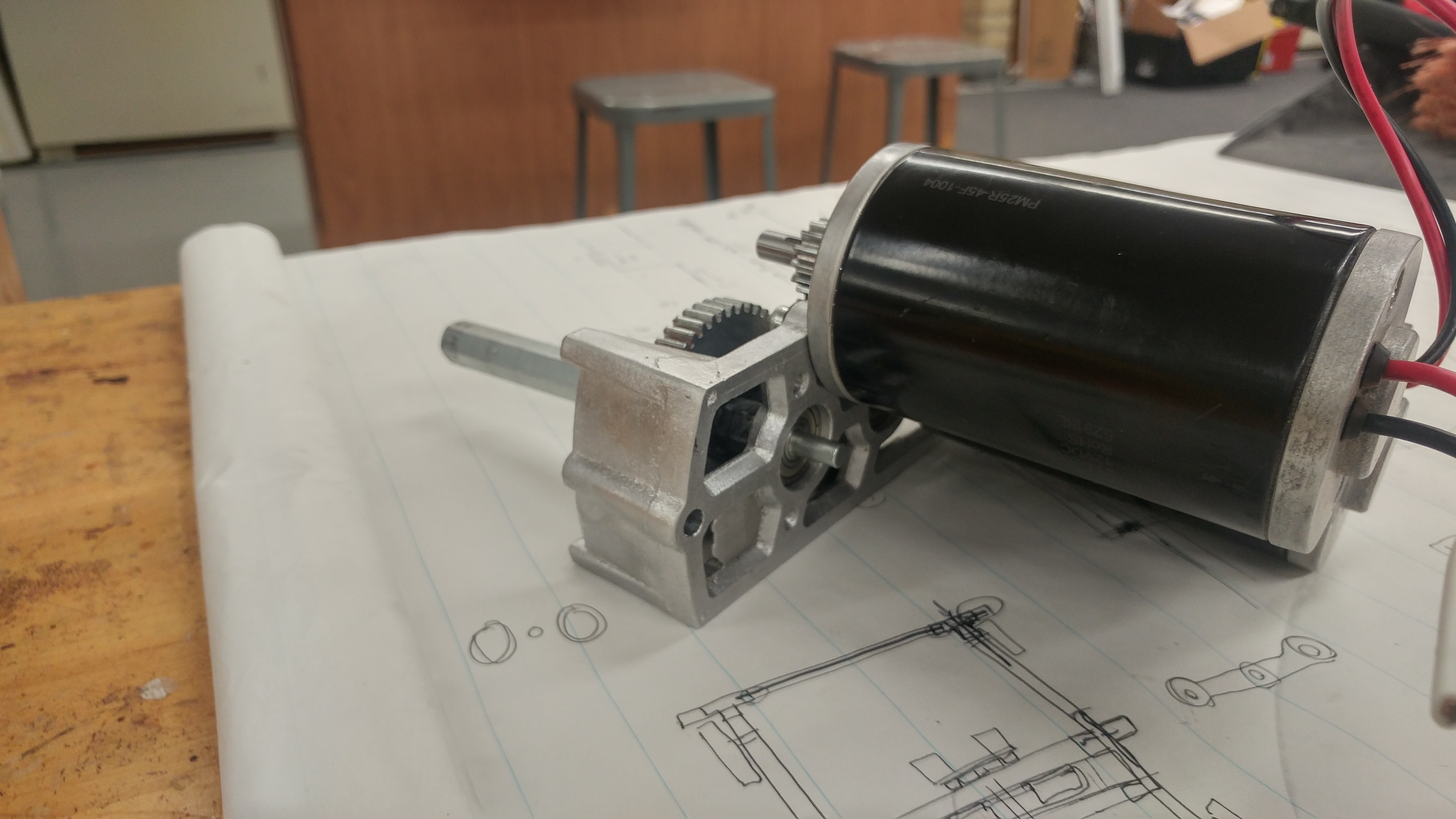

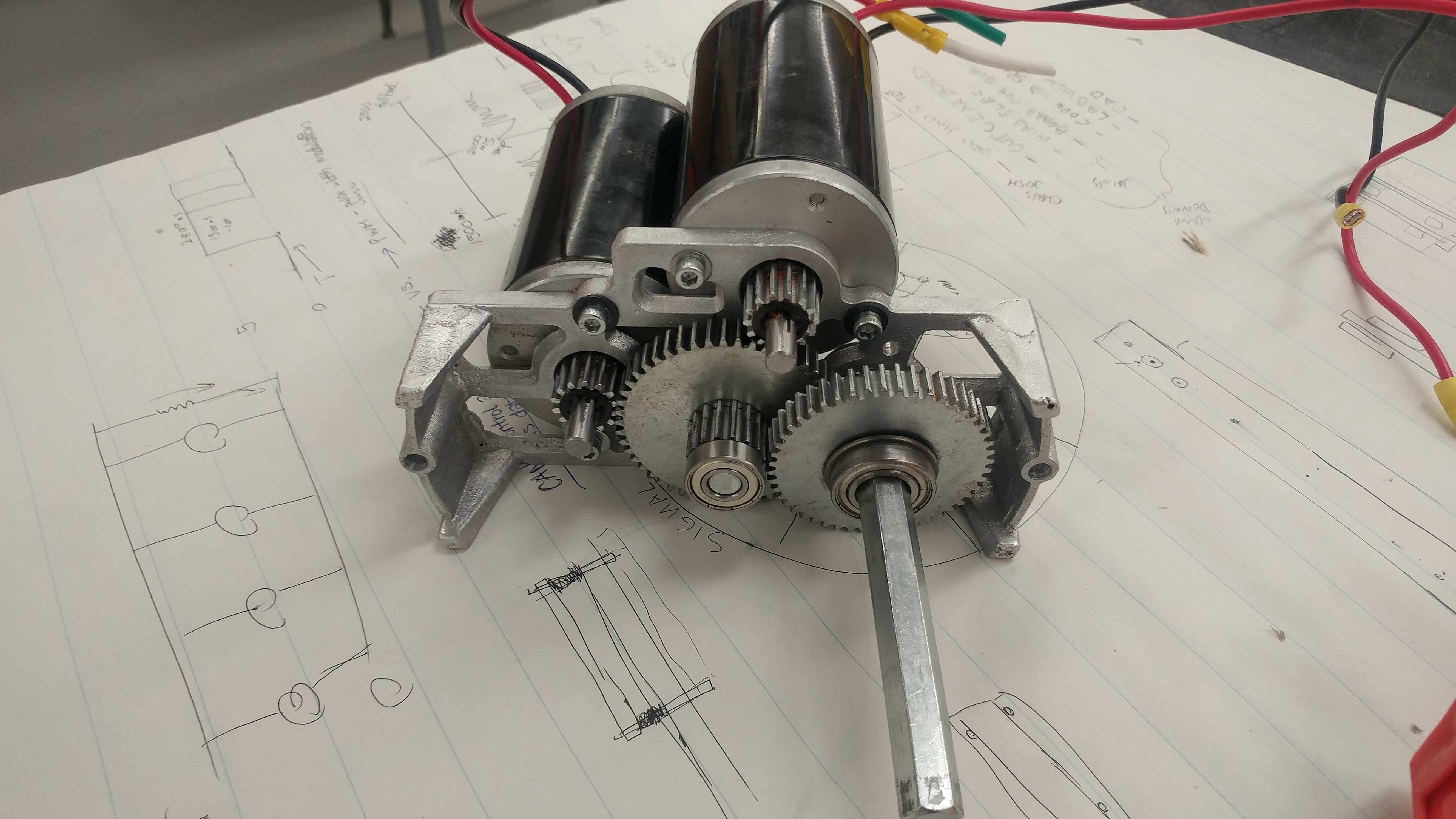

I got obsessed with making a one piece gearbox housing that could bolt to a section of 2x1 box section. Not because we really really need it but more or less to go through the process:

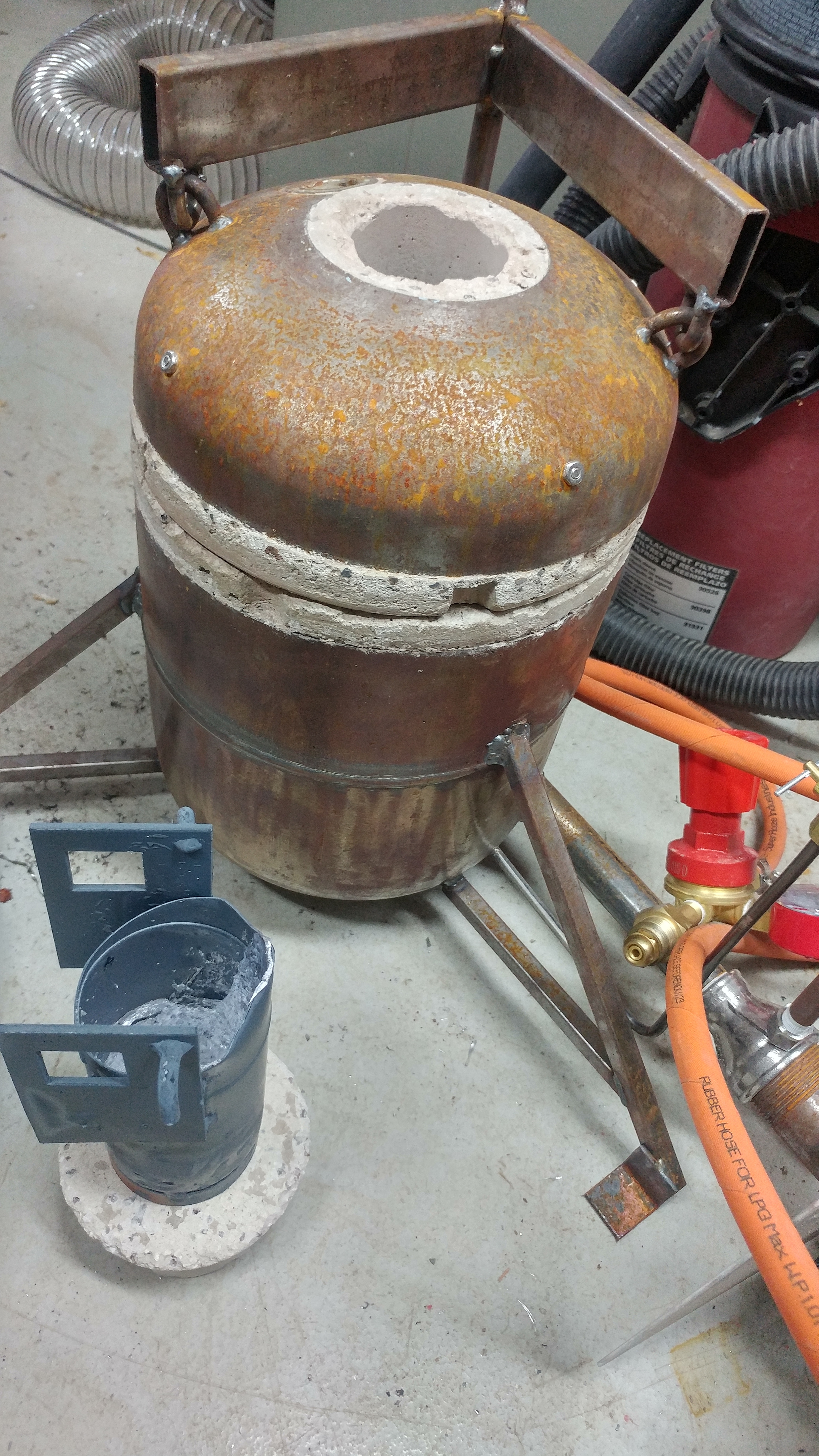

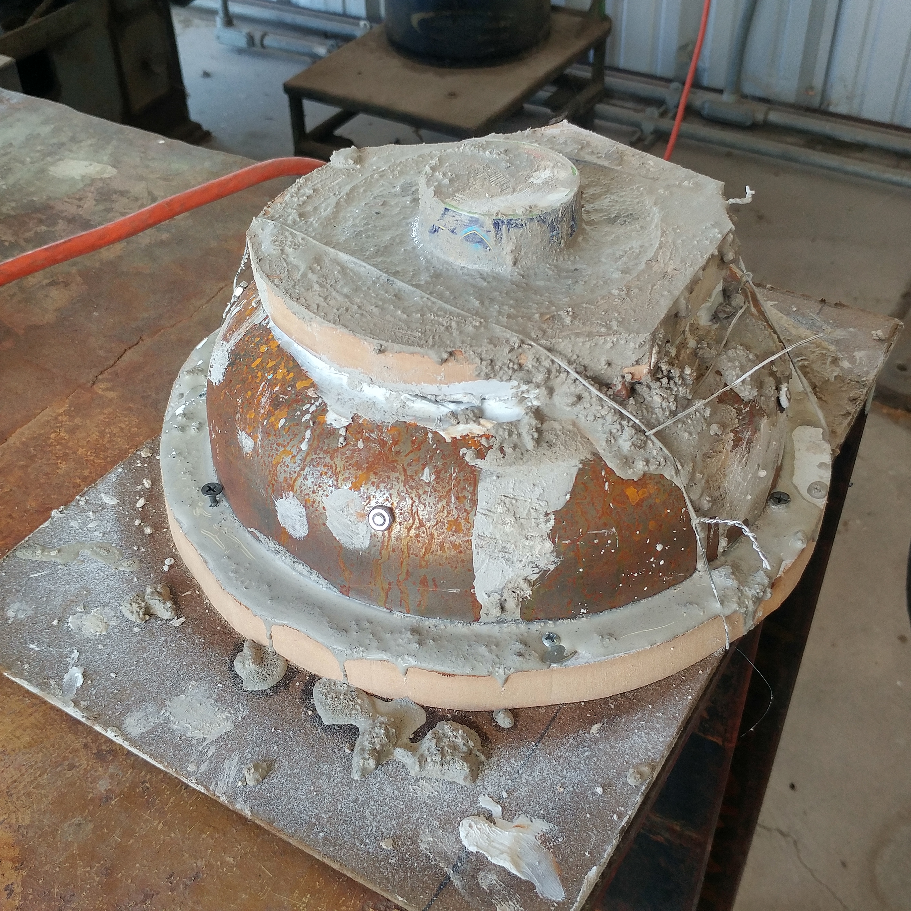

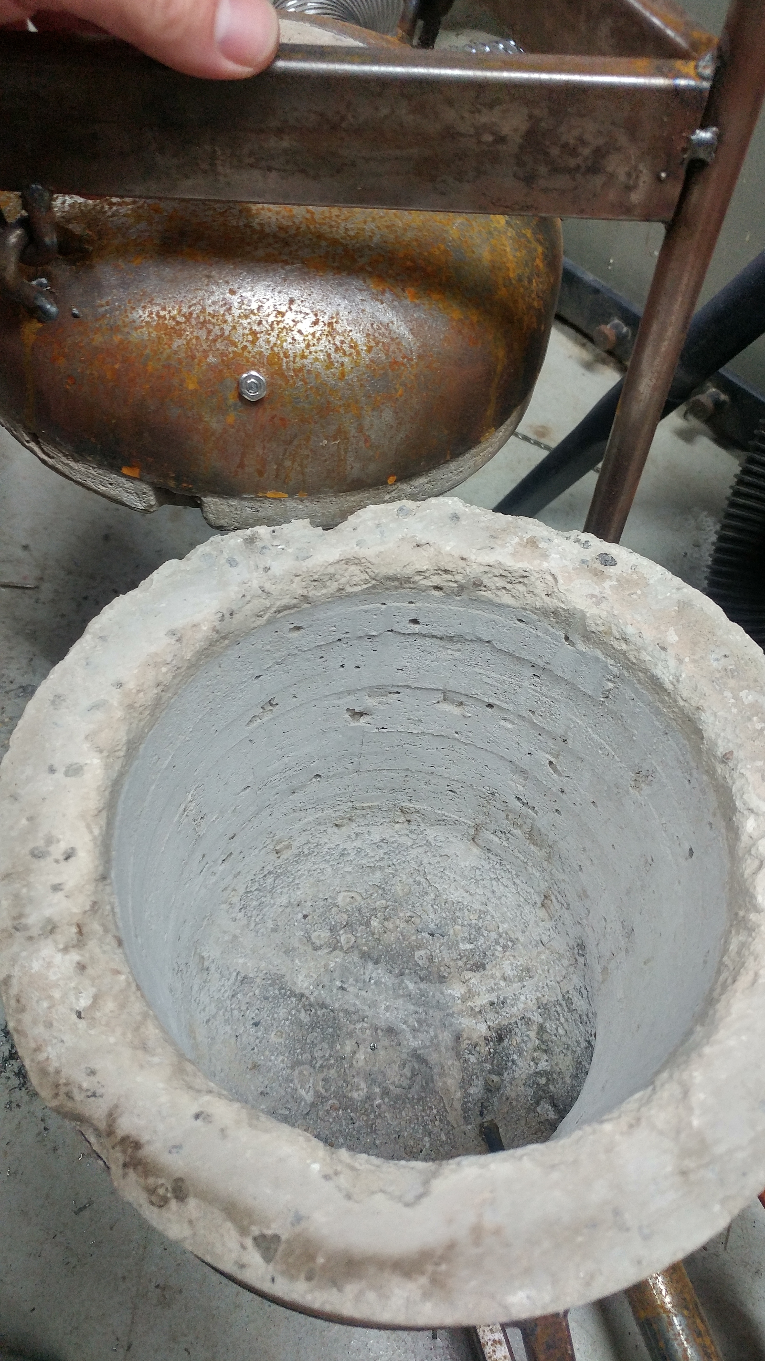

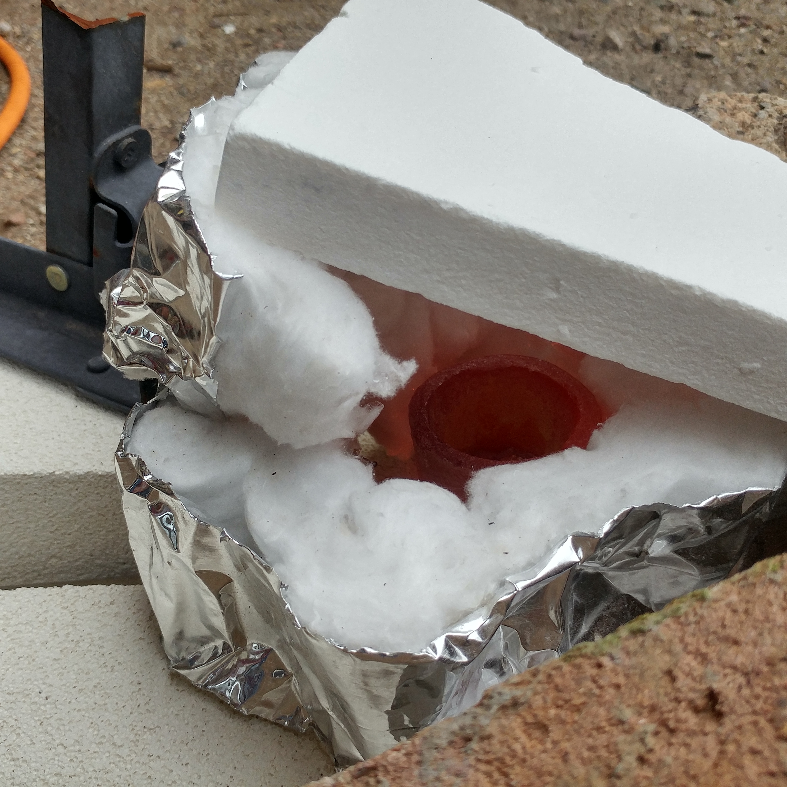

First I started by figuring out a furnace:
I Did some super crude tests with my students regarding how hard it would be to melt aluminum: Result even with the shadiest furnace ever aluminum melted very easy with propane and way faster than we all expected:
I was pretty grossed out by some of the furnaces on Amazon with Kaowool insulation and wasn’t too interested in having the thin fibers of it going everywhere. I found an old empty R134a tank and some castable refractory from Skyline Components in Tucson, AZ. We cast a small furnace. It was pretty easy to work with and has held up really well to multiple firings, no degredation and minimal cracking:

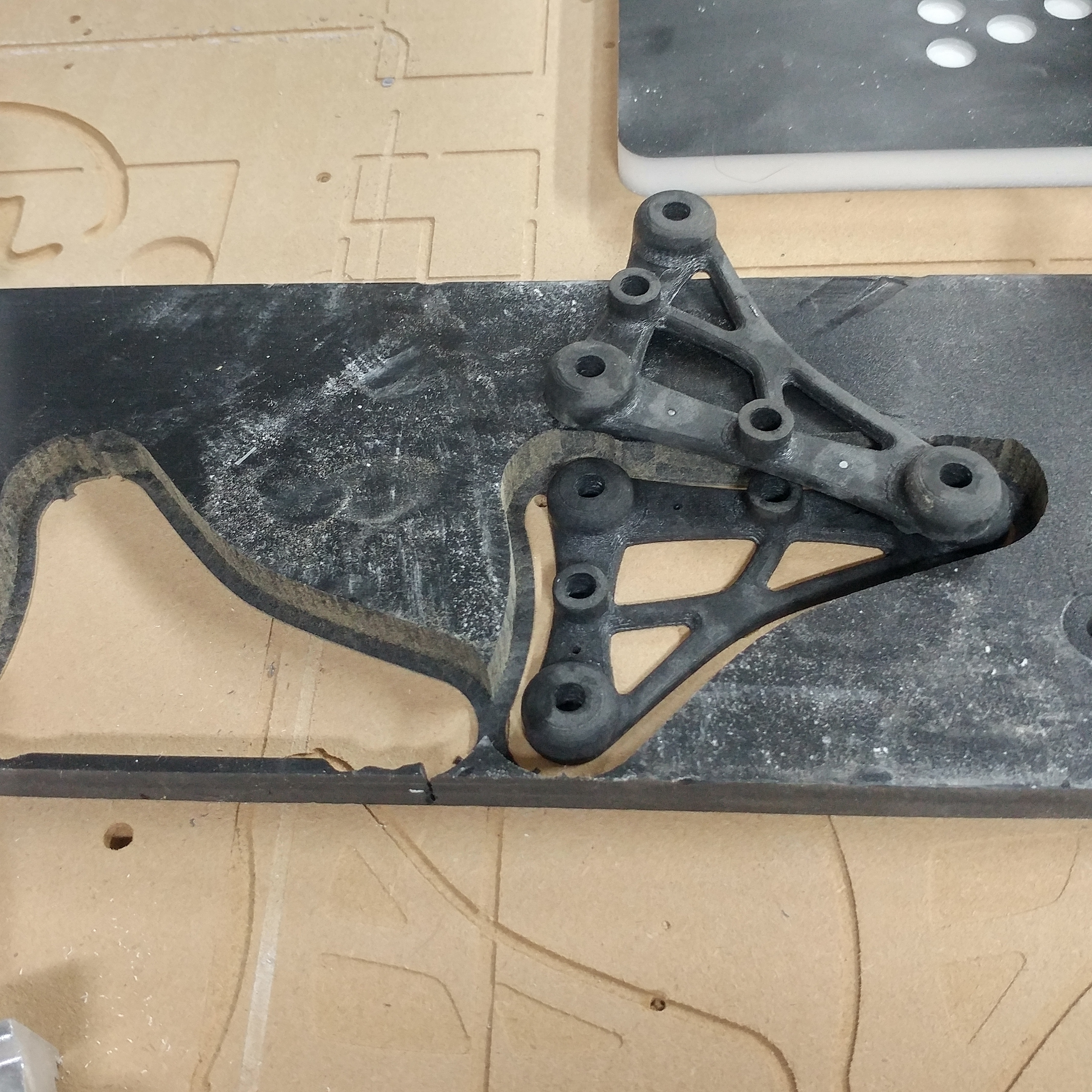

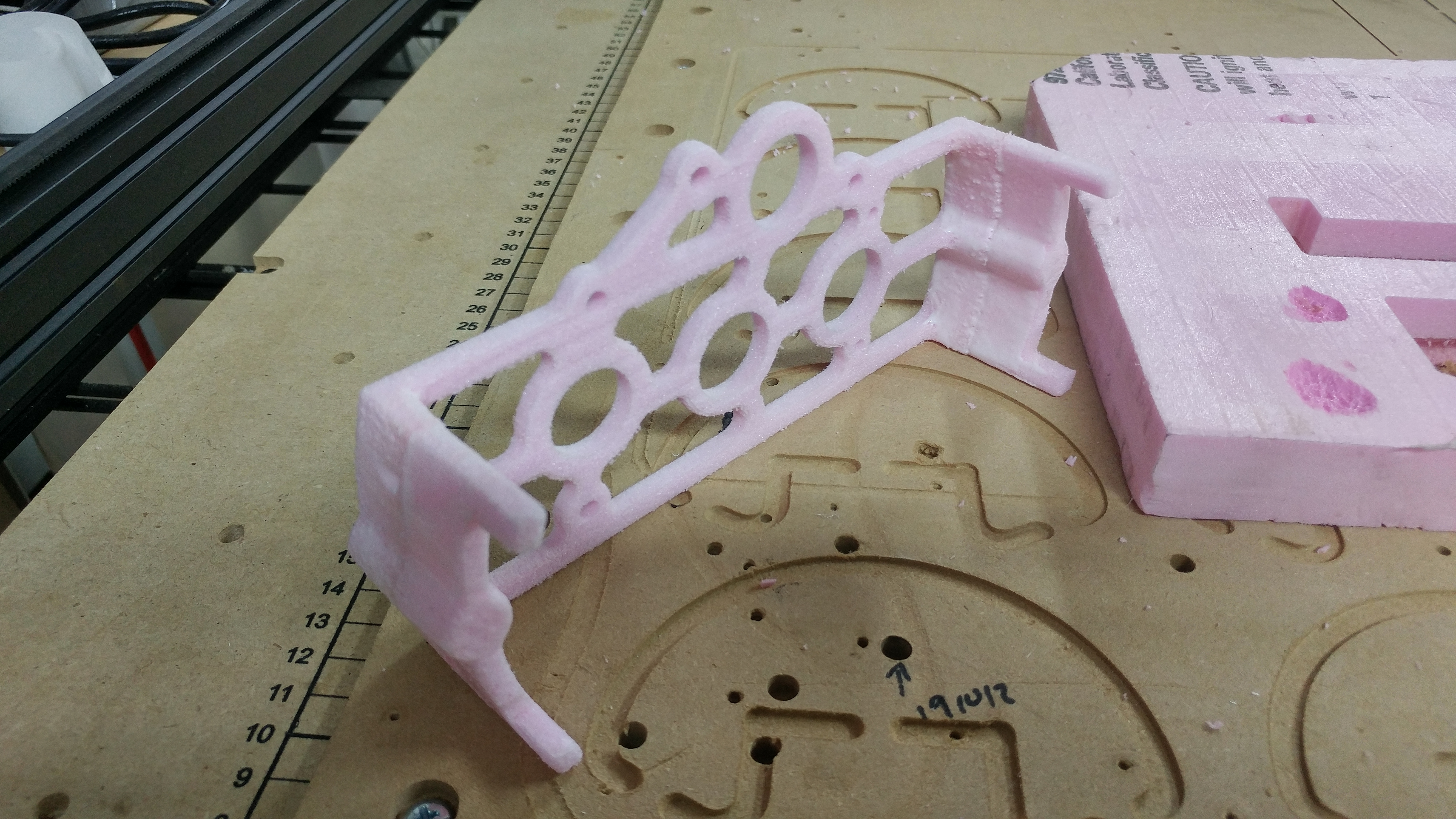

For my first test I made a really simple bracket with curves and shapes that would even be a pain to make with a CNC mill. I cut parts out of foam on my router in 2 halves. (cutting these parts took the longest out of this whole process:

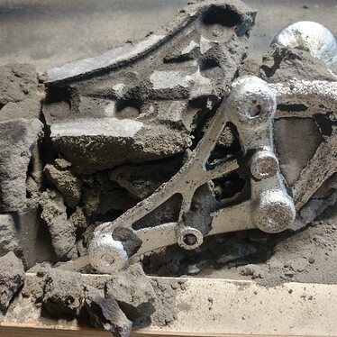

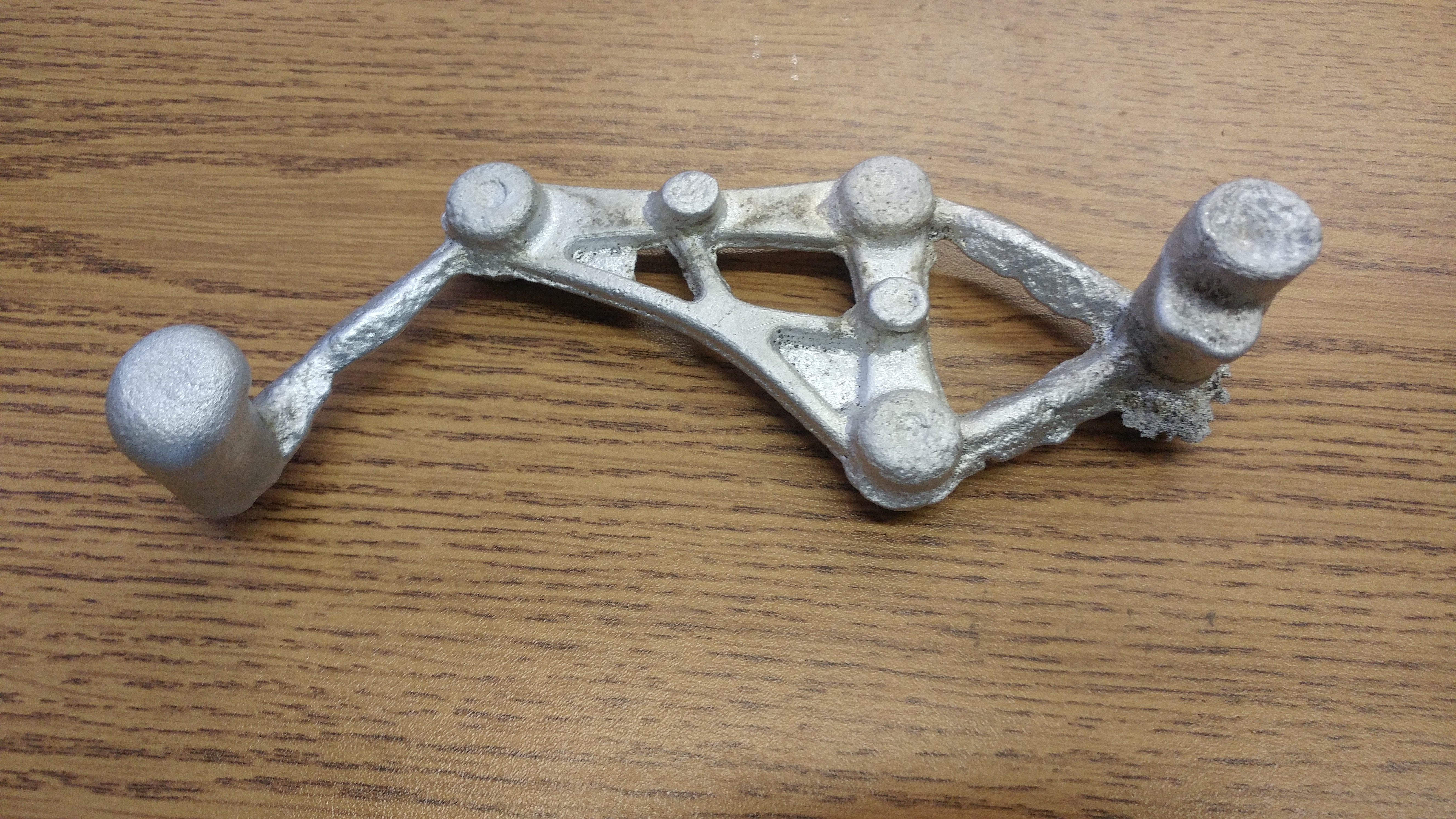

This first bracket was cast using green sand. It was alright. the weather was pretty dry so i was struggling with the sand drying out and things kind of falling apart. This first test I went pretty fast and didn’t sweat so many details. I totally expected it to be a failure. But to my astonishment it worked… even with such small passages (though barely):

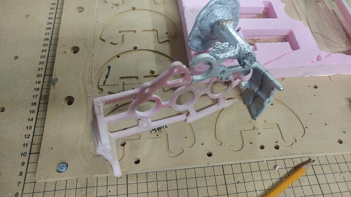

I tried the lost foam method in green sand. It was a lot of work with few good things:
  • The foam isn’t exactly my favorite thing to machine as it is very flimsy
  • Surface finish is garbage
  • Tons of nasty fumes probably took a few years off my life
  • The positive is consumed
  • The aluminum didn’t penetrate very far

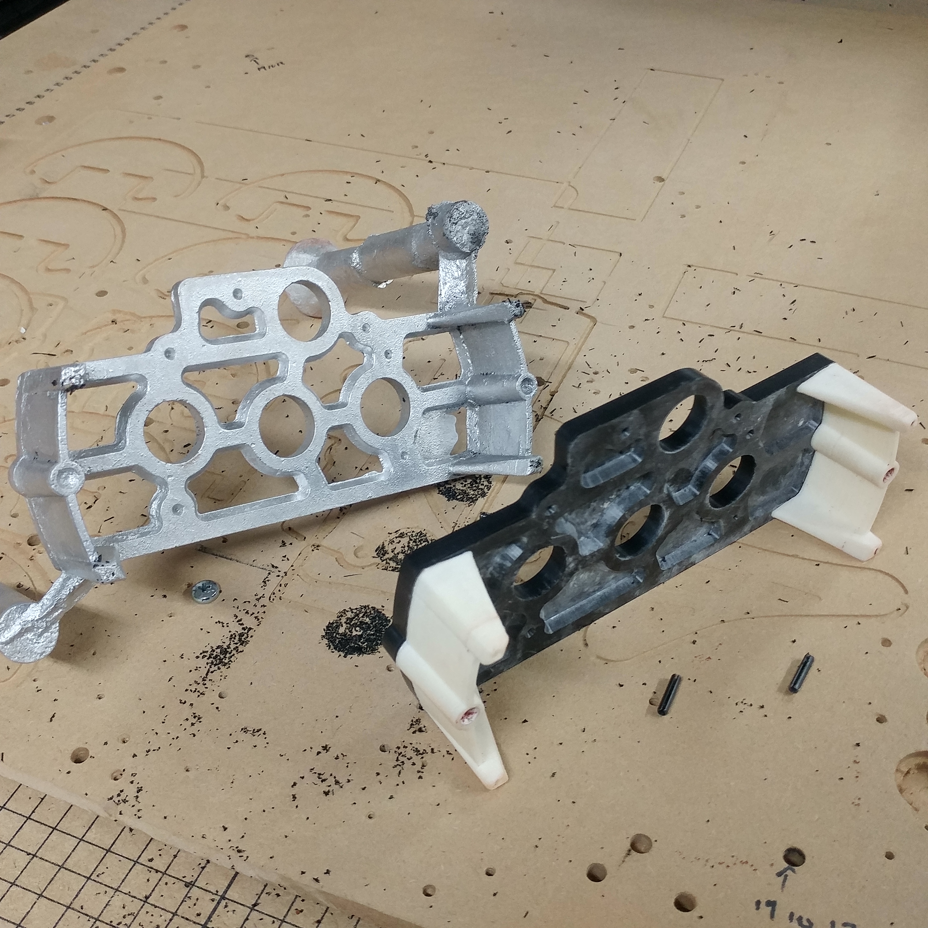

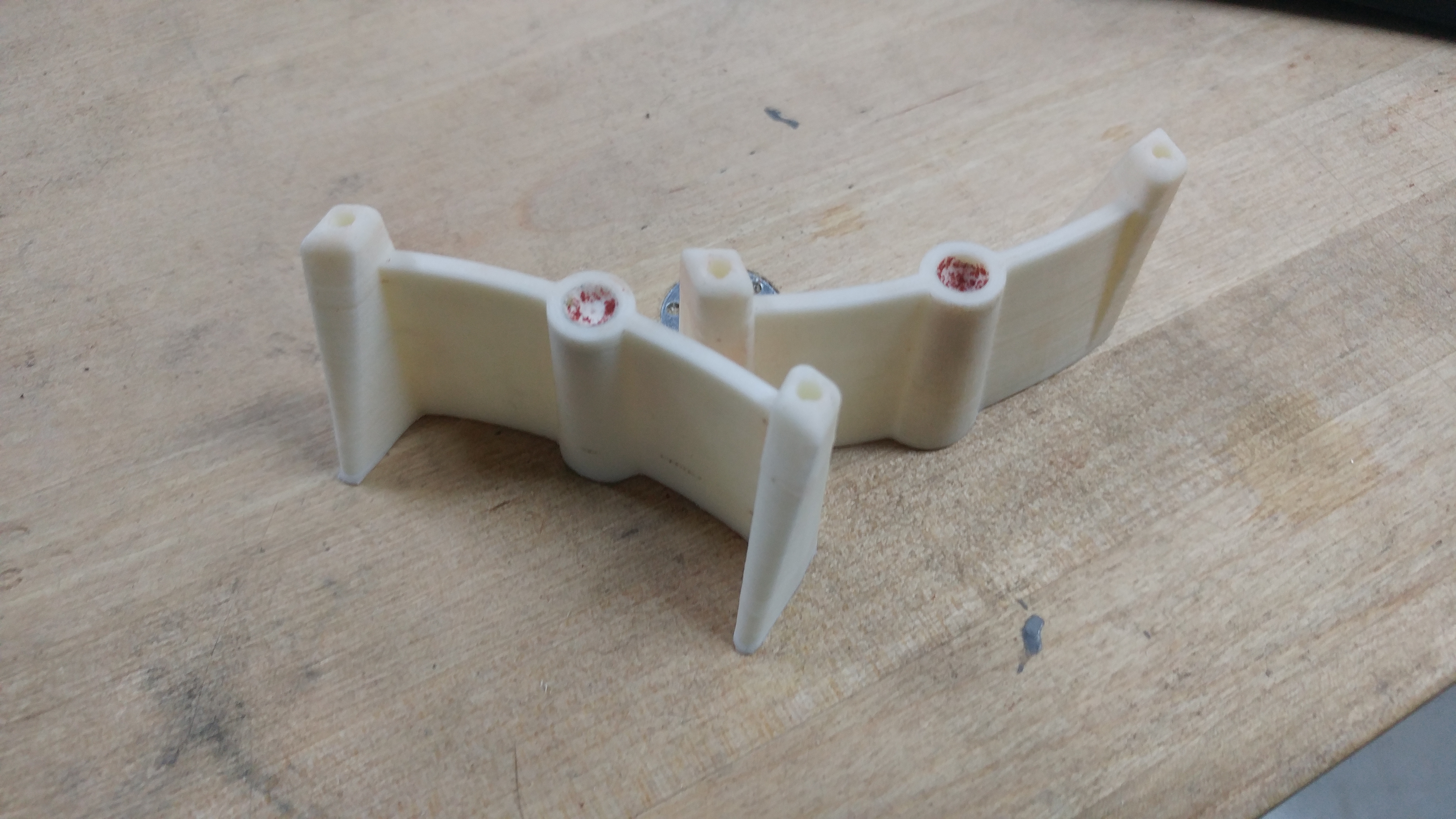

I tried cutting the positive out of a chunk of HDPE. Throughout this whole time i’m constantly tweaking the design here and there trying to make it more reasonable for casting. I initially had an idea of having a center positive then spacers that I could put on either side to make it a right or left gear box. I learned the hard way about ALWAYS having draft on the edges I wasn’t able to get a cast from a positive with straight sides. I thought that it was so thin i could probably get away with it… nope.
At this point ive spent a lot of time routing out positives and way more time than i would like trying to cut out the spacer sections that lock onto the aluminum tube. All i was getting was garbage then something happened…

One of my students had recently pulled the moth balls out of one of our 3D printers and offered to 3d print the part I was struggling to cut cleanly with a router (Anyone else out there do front side and back side 3d contours in 2 ops on an x-carve? yes it does work you just have to plan steps ahead for your Z0) I was schooled the 3d printed part worked perfectly.

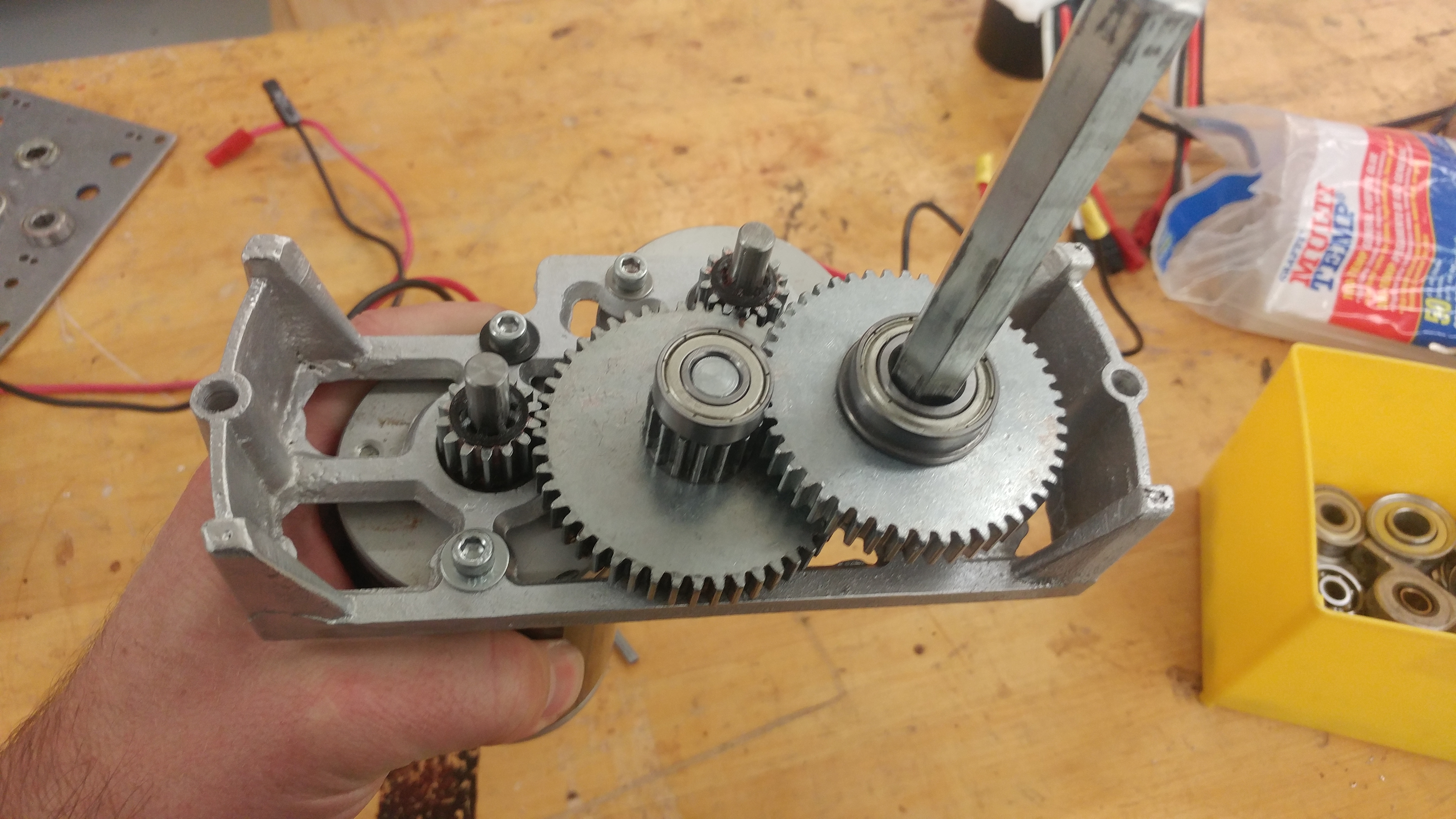

One trick I came up with along the way is to make a thin wall where you want holes. In this first successful casting i made my life a lot easier by not packing Petrobond through the entire frame. the sand just formed a 0.030" void between the parts that the aluminum just didn’t flow into:
Holes were then chased through on a mini mill but you could probably use a drill press. I intentionally gave the task of drilling it out to a super new member just to see if it would still work. Fit was alright. A smidge tight for the lower motor but bringing the bolt holes up from a snug fit to a free fit fixed it:
Yes there are 4 holes that have to be in just the right spot on the box section to make this work. We plan on making a template that we can just clamp to the metal and chase the holes in with. we’ll start with an 1/8" pilot then just chase it with a rotabroach hole saw.
So long story short a 3D printer and casting old aluminum off cuts is pretty promising:

How did you attach the 3D printed parts to the HDPE chunk to prepare for casting?
Looking at your problem with Lost Foam Casting I think that could have been solved with an entrance and exit port.
For example this video: https://www.youtube.com/watch?v=9bYVQ8ypHss

The 3d printed parts had location pins pressed into them. the hole in the HDPE is drilled out a few thou over so its a nice easy fit. I actually kind of switched up my strategy and ended up 3d printing the entire half of the mounting side with the spacers in it as one part. (See the Grab Cad Link) I think it’ll be easier to keep the spacers in the correct orientation when packing. The original way i did it i felt that the sand was pushing them in or out as i was packing them together. If they are integrated as one part i think it’ll be easier to keep them in a more precise position.
I kinda didnt go to crazy talking about how i went to a fully 3d printed positive because I havent actually tried casting with it yet.

What thermoplastic for the side positives did you use? Basic PLA or ABS or something else?

The white sides were made in ABS but for no other reason than we have a bunch of ABS filament. I’ve since made some more positives in PLA. I think all that really matters it that it is easy for you to print.

We had success with lost PLA, but you will need a lot of venting and also you will need to pour hot and from multiple sprues quickly. It actually looks like our lost PLA went a little smoother than your lost foam pour. Burning out the pla with a furnace would yield much better results than the direct pour we tried.

Cool! What was your gating system like? Seems like there are portions in your lost foam where having additional gates and sprues could have been helpful in getting a more complete cast. If you can, maybe do something a little more traditionally lost-wax and dip the pattern into a fine sand slurry so you can get a more desirable surface finish.
