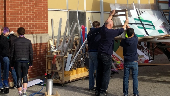

We built the attached cart, which holds stock of different lengths vertically. Works well as long as you’ve got enough ceiling height.

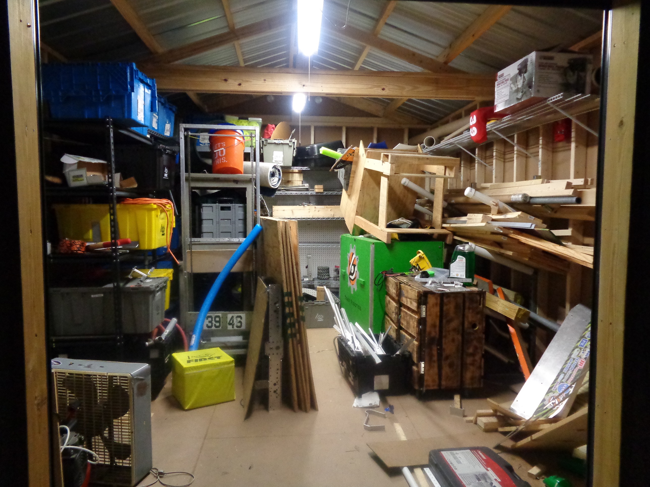

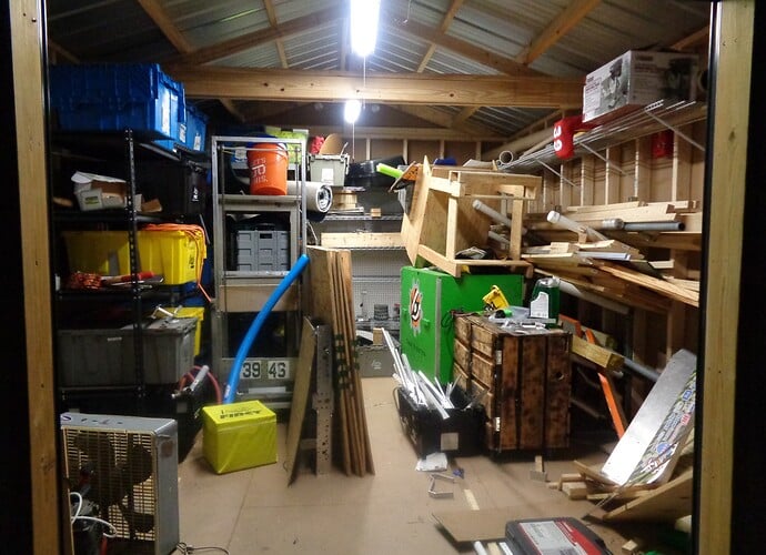

3946 has some custom-brazed unistrut “stock storage racks” inside the storage shed. These were originally built for the on-campus portable building we were using in 2016 and 2017, and moved over when we relocated to Ninth street. These feature three “arms” sticking out at about 30 degrees above the horizontal brazed to uprights, which are lag-bolted to the 2x4s in the wall. The arms are covered with PVC pipe for reasons I never really understood. You can see them along the right wall in the attached picture, holding up a lot of wooden and aluminum (and a bit of steel and PVC) stock. Pieces shorter than 8 feet are stored vertically to the right of the long stock racks; that is almost entirely polycarbonate tubing, and aluminum tubing, channel, and angle.
The big rolls of carpet are stored at floor level under these racks when not in use for practice (this photo taken 1 Mar 2018, between bag and competition for POWER UP; we had another garage set up as practice space at this point).
Edit: The solutions above or for pieces more than about three feet long. For medium-lengths (1-3 feet), We have cut 12" lengths of 1-1/2" to 4" PVC pipe and stood them up in an open tote (not the KoP/Rush totes; these have vertical sides), larger pipes to the back, and used that as an organizer. Pieces shorter than a foot have been stored in shelf bins (~6" wide, 15" deep) and in relatively flat boxes/trays at different times.

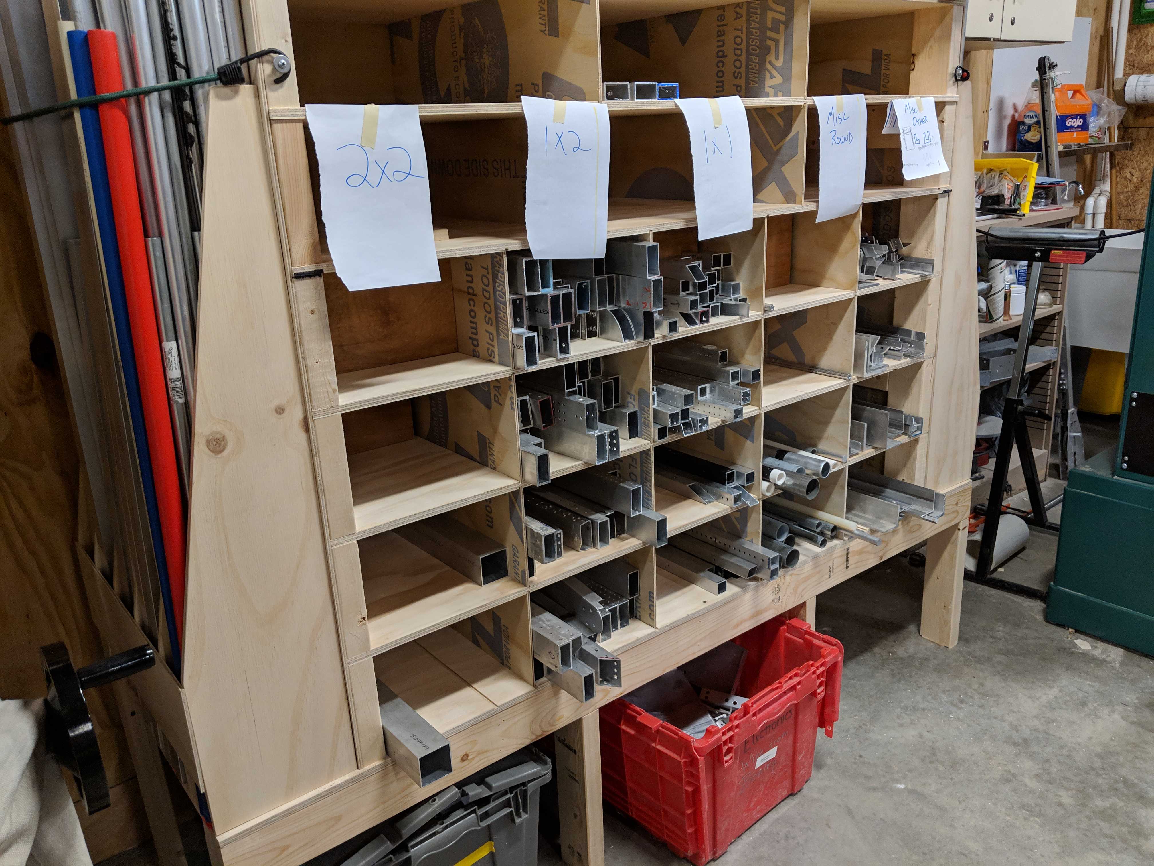

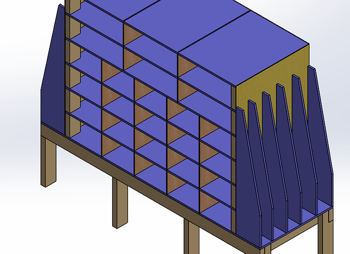

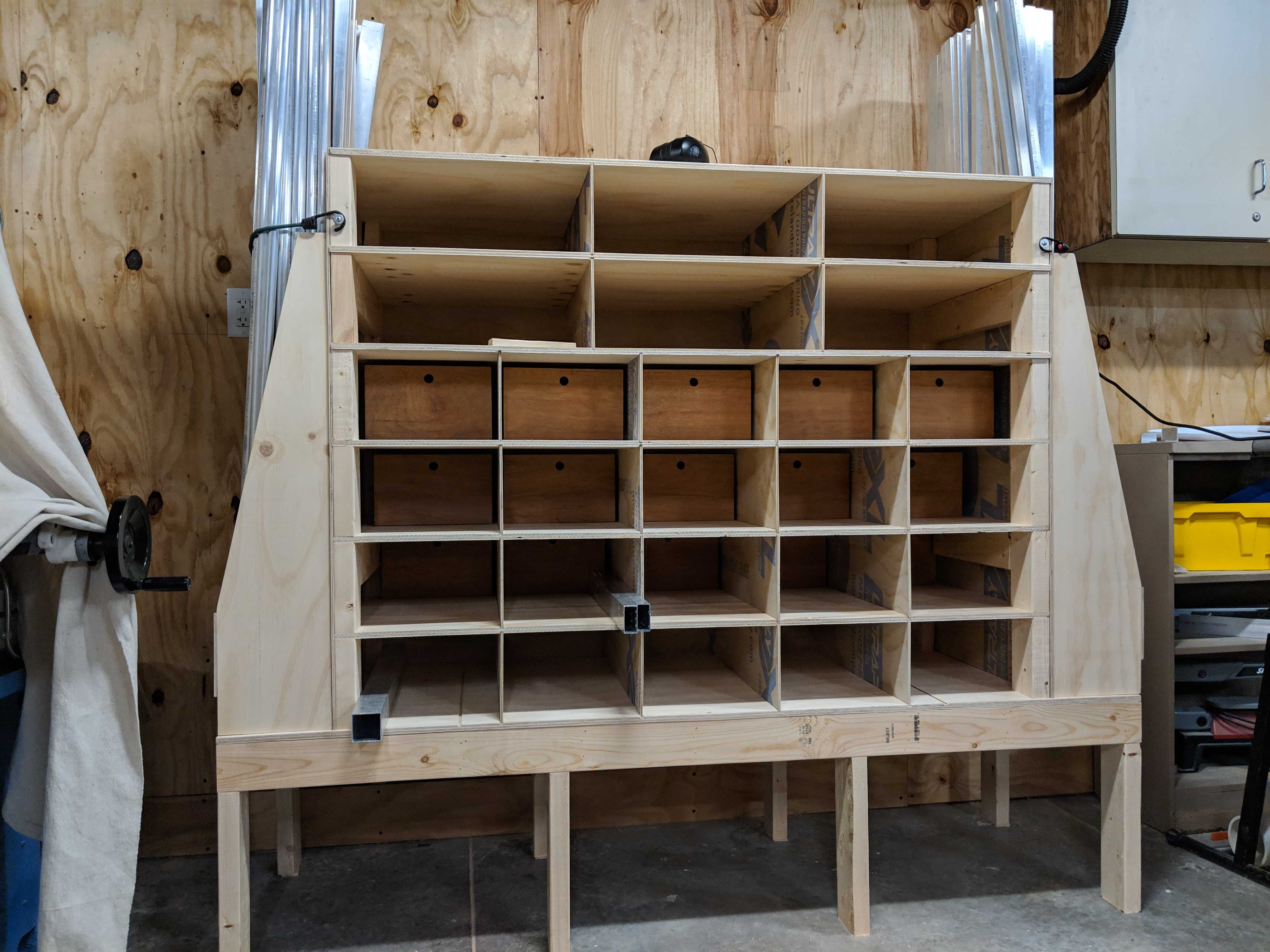

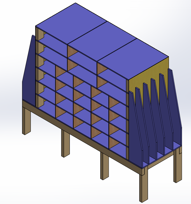

We recently built a new metal storage rack, mainly for tubing/extrusion in our shop and are in the process of doing something for larger flat stock closer to the router.
This design allows us to:

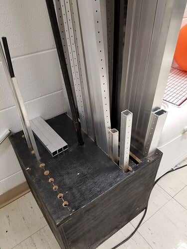

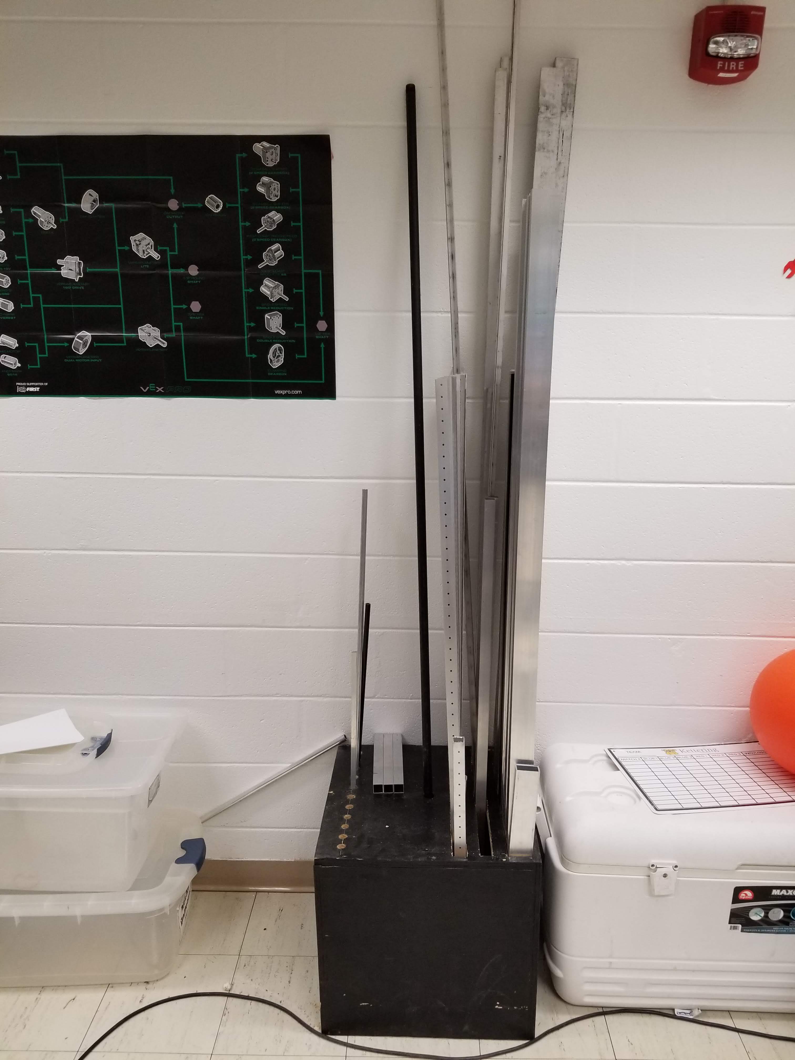

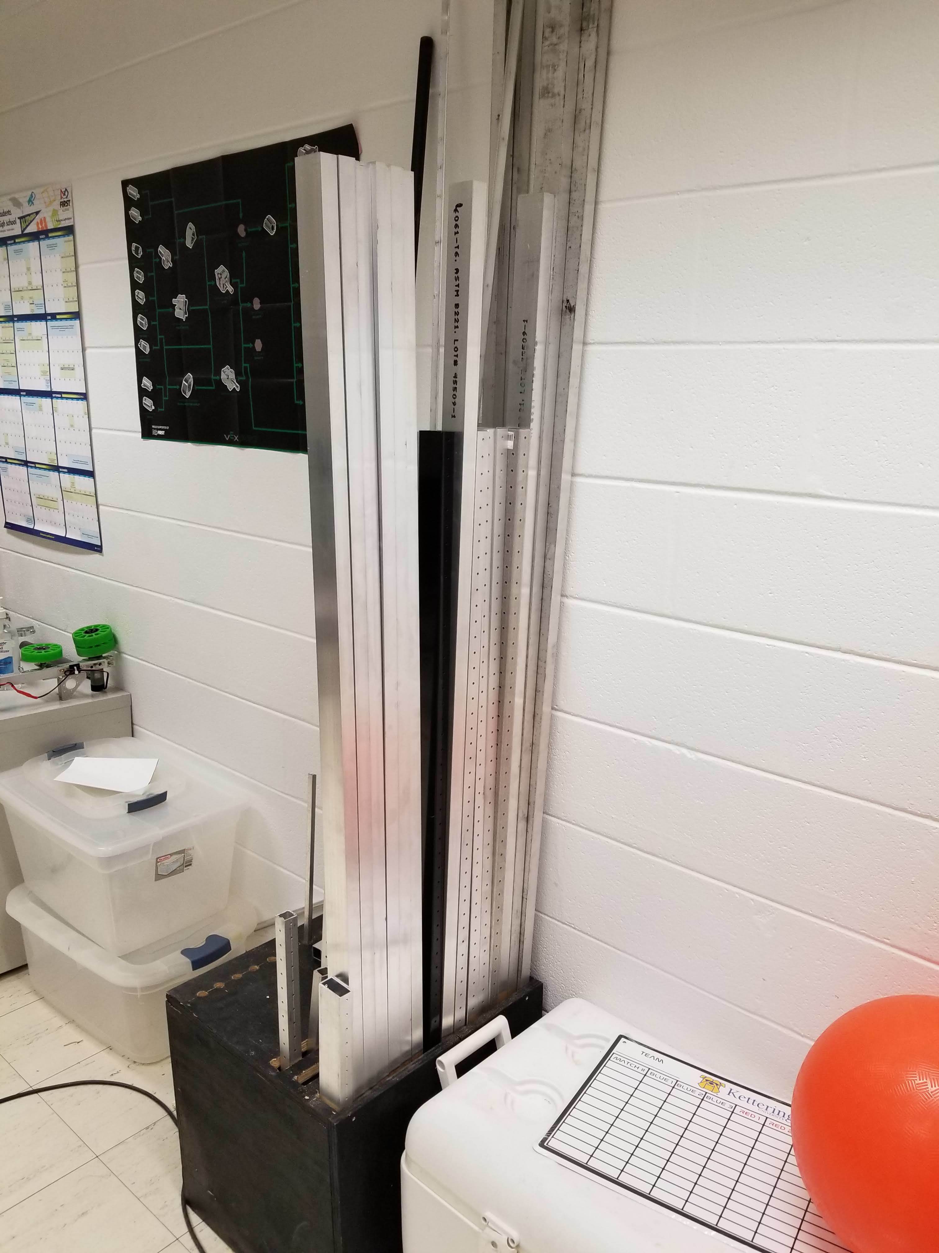

We ended up coming up with a solution for storing our aluminum tube and other building materials. It isn’t as elegant as what others have shared, but it gets the job done.
Basically, we had this wooden box from a project back in our FTC days. It was just taking up space so we decided to make use of it. We cut some slots out in the top to hold 1"x1" and 1"x2" aluminum as well as some holes to hold hex shaft and churros. It works rather well, and definitely helps us be more organized.
Here are a few pictures.
For the amount of space we have, this is a great solution! We’re needing a better solution too, and while I like a lot of the big wall storage and carts and such, it’s just not practical for us right now. I like this, and haven’t seen anything quite like it. I like how the slots keep everything lined up. I might have to build something similar.
