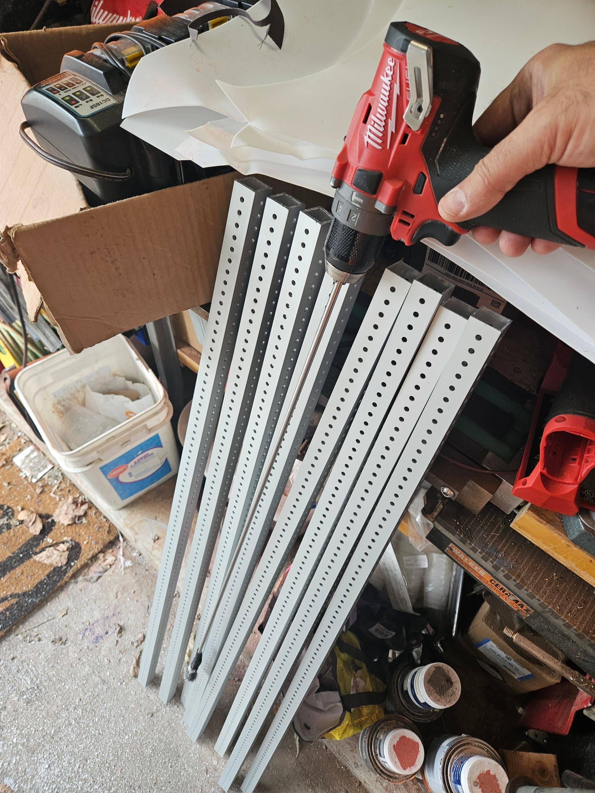

Round wire brush mounted on a long stem. Run it through with a power drill. Worked grrat on the Last Anvil tubing!

For slots, irregular shapes. I used this. Might need to dial in the CAM programming, but if you have lightning slots everywhere, this is way nicer than deburring manually.
Heres what i used on the gooped up Last Anvil clearance
sale tubes.
