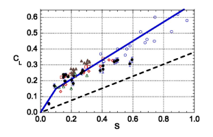

I’ll be honest: I’m not 100% confident in the equation the current version uses to calculate Magnus force. Tldr: I’m looking for someone experienced with advanced fluid dynamics to let me know if it’s right or not.
The current calculation is based on this paper by the University of Illinois Physics Department quantifying the Magnus effect on baseballs. Basically they determined that the force could be expressed as:
F_M = \frac{1}{2} C_L \rho A_c v^2
This formula matches that in @Ether’s whitepaper and it’s similar to the formula for drag (to which Magnus effect is directly related). The Illinois paper then takes their analysis one step further than Ether’s paper, characterizing the relationship between C_L and a new non-dimensional quantity called the spin factor:
S = \frac{R \omega}{v}
They provided this graph of the relationship:
Which approximately corresponds to the function:
C_L = \begin{cases} 1.6 S & 0 \leq S < 0.1 \\ 0.6 S + 0.1 & 0.1 \leq S \end{cases}
This is a much easier function to implement, so I was able to calculate it internally (as opposed to calculating the drag coefficient from the Reynolds number, which is highly non-linear and has to be done manually).
Something still seems off to me though. There’s no accounting for the surface finish of the balls, or whether the ball is in laminar vs. turbulent flow. I would assume both of those would make a significant difference, since they significantly affect the air drag and at the end of the day the Magnus effect is just the difference in drag on either side of the ball due to different surface velocities.
