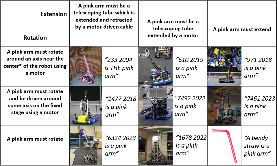

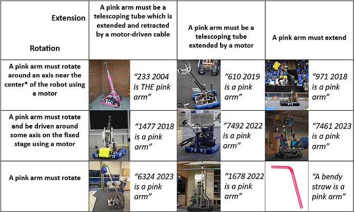

With this year’s game being a pick and place with a large horizontal extension, we have seen a lot of arms. Specifically, we’re seeing a lot of telescoping arms. To most people, these are just called “pink arms”. But defining a pink arm as “a rotating telescoping tube that is extended by a motor” means that 1678’s climber from 2022 is a pink arm. I don’t know about you but I can’t really call that a pink arm.
In this post, I will be outlining definitions for different types of named arm archetypes and going into detail about why these classifications are important. I am not going to include arm types that do not have a dedicated nicknames. My hope with this is to help clear up some of the confusion around terms like pink arms, 330 arms, an sushi arms. It’s also partly because I’m under the weather and have nothing better to do today. This is not meant to be a comprehensive classification of all arm types. There will be arms that don’t fit into the categories bellow (like 971 in 2018 and 2910 in 2019).

Pink arm
Definition: A pink arm is a type of Mid pivot telescoping tube arm where the axis of rotation is near the center of the robot. using motor power for both extension, retraction, and rotation of the arm. Pink arms generally have multiple stages of extension.
examples:
FRC 3847 in 2018
This is a really classic example of a pink arm. Instead of using extruded box tubes, they use bent sheet metal that is fastened into a rectangle. and they put the two motors powering the telescoping extension in the very back of the first stage tube.
FRC 233 in 2004
This is the first pink arm that team 233 built. They used it again in 2005 and most famously in 2011. This robot helped define what the pink team is.
Not a pink arm:
FRC 7492 in 2023
Cavbots design from this year is a mid pivot and it does in fact telescope but it does not have the nesting telescoping tubes that are signature of a pink arm.
FRC 125 in 2023
While this arm does feature telescoping tubes what keeps it from being called a pink arm is the fact that the pivot is an end pivot and the pivot is not near the center of the robot.
Image credit: @Boomie
