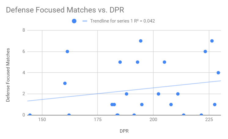

xRC simulator has been running multiple full scale 2020 frc game events where this has been the case for may events that a virtually full time defender is the norm (one per alliance). We also have perfect data on who did play essentially full time data, and who did not.
This format also normalizes the robot connection issues/robots getting better or worse over time. Will investigate some of these and see if it looks better than traditional events. (paging @cobbie as well)
Brennan and I ran some analysis on the most recent full-scale xRC event, we have relatively high amounts of data for this event because we know exactly who played defense in each match and exactly how many points each robot scored in each match. When we compared the number of defensive matches played with DPR we got a positive correlation of r=.205 (which is very unexpected because if better defenders are supposed to have lower DPR then playing more defense should result in a lower DPR which should result in a negative correlation.) This data was not statistically significant with H_{0}: r=0 and \alpha = .05. We then ran this against the average score of each player’s opponents throughout the competition, this resulted in a much stronger correlation of r = .578 which was statistically significant with H_0: r>\frac{1}{7}* and \alpha = .05. Defense was played in all 28 matches and \frac{1}{3} of players focused on defense in the majority of their matches, which eclipses the 25% threshold mentioned by Karthik.
The raw data for this event can be found here and some of the basic analysis can be found here.
*Note: the reason it is H_0:r>\frac{1}{7} and not H_0:r>0 is because since each player played seven matches, one-seventh of the correlation can be assumed to be dependent.

In games for which DPR is at least somewhat effective, CCWM will also be somewhat effective. 2018 is the only game in recent memory in which DPR was something other than essentially noise. In that season, all teams effectively were playing “defense” just by playing offense since the vast majority of points you could earn came at the expense of your opponent’s points. This made DPR an actually somewhat usable metric and because of that CCWM was the best it has ever been, although still demonstrably worse predictively than OPR.
There could hypothetically be future games in which DPR/CCWM has more value than OPR. One such hypothetical game would be a modified version of PowerUp in which the only ways to score is from switches and scales (no auto line crossings, endgame parks/climbs etc…). If penalties added to your opponent’s score, you would likely end up with a game where DPR and CCWM would be superior metrics to OPR (depending on how the penalties are earned).
One last thought, I suspect that DPR (and thus CCWM) actually has some value for teams that are consistently defended. The standard usage for DPR is to look at the team playing defense, but any team playing defense will not be scoring for their own team, and thus any team that consistently draws defense should also get a low DPR and a better CCWM as a result. I haven’t tested this theory rigorously, mostly due to lack of data about which teams are defending/being defended, but I’ll probably research more as Zebra Data becomes more prevalent.
The real problem with DPR is that the proposed formulation doesn’t actually measure defensive effect unless all of the teams play all of the other teams. A true DPR would measure how much the OPR of the opposing teams is reduced by the presence of that team, so you need the OPR of the opposing teams in the calculation. That’s not the case in this calculation. The “DPR” is actually the OPR of the opposing alliances that were faced–if a team faces weak alliances, the DPR improves regardless of whether there was any defense.
