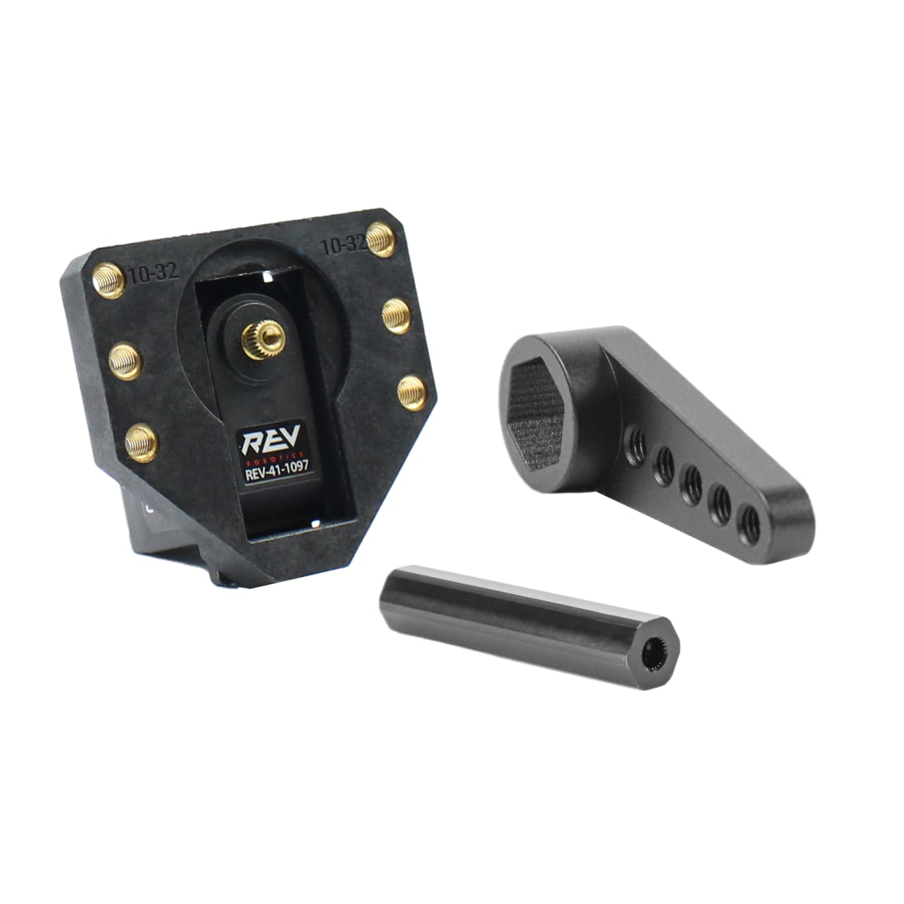

REV also offers, some specific FRC servo mounts and shaft options, that while they are not compatible with the servos you linked to, they are compatible with the REV Smart Servo (which was the basis for the AndyMark one) and is still sold by AndyMark. if they are your preferred vendor.
I think you should check out REV’s ION Servo accessories Which give you 1/2in hex, 10-32 threaded mounting options, along with support for bearings. ION Servo Accessories - REV Robotics
