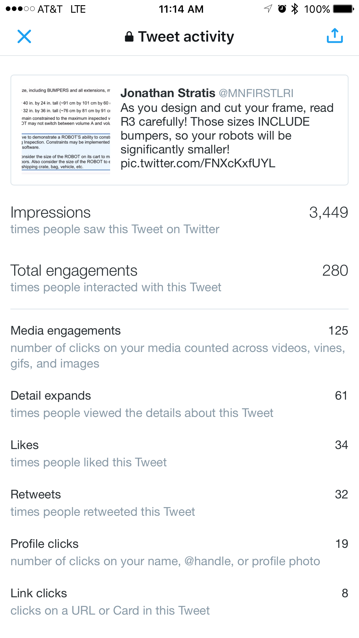

I expect the community can do much better than my pitiful little tweet from the day after kickoff! I wasn’t even a little bit creative :slight_smile:
https://twitter.com/mnfirstlri/status/818276563842199552
