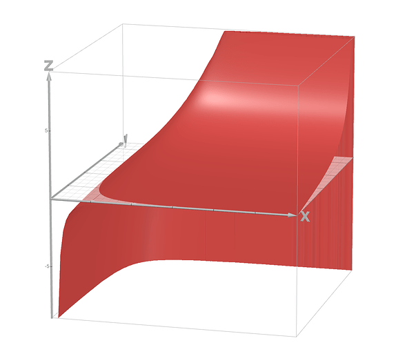

We can actually graph this equation in a graphing calculator such as Desmos | 3D Graphing Calculator! We’ll have to modify it a bit so that the graphing calculator will accept it.
z = -\dfrac{1}{2}g\left(\dfrac{L}{\cos(y)x} - \dfrac{R}{x}\right)^2 + \sin(y) x \left(\dfrac{L}{\cos(y)x} - \dfrac{R}{x} \right) + R\sin(y)
For the graphing calculator we’ll use the x axis to represent the shooter velocity in m/s and the y axis to represent the angle in radians. The z-axis represents the height of a point projectile (obviously the note isn’t a point and this complicates things but let’s just assume that the note is a point and spherical cows). This is a wacky shape.
I’ve modified the graph below to be in degrees. I’ve also used some constraints to avoid the periodicity of the angle and capped the max speed to 30 m/s (which is around 60 mph… there’s no way you’re shooting a note that fast!) You can play around with it here.

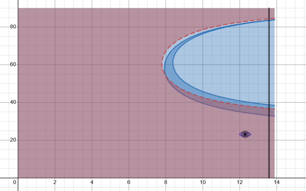

The set of (v_0, \theta) that satisfies these constraints is the intersection of three 2D surfaces in the plane. We can graph these using regular old 2D desmos. You can find it here.
I draw constraint (1) as the intersection of the two blue regions (indicated by the dark blue band). Constraint (2) is the intersection of the dark blue region with the red region (indicated by the purple band). Again I graph \theta on the y axis (in degrees) and v_0 on the x axis (in radians).
I also indicate the max velocity with the black line.

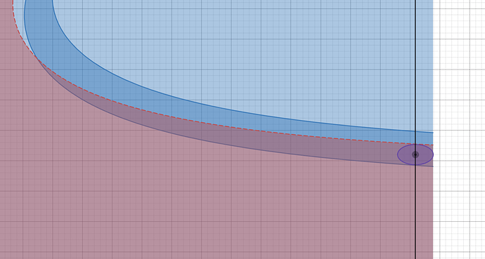

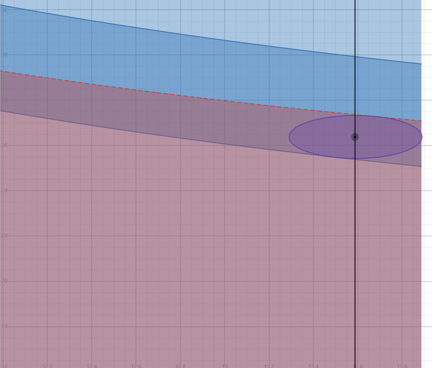

Any of the points in the purple band work. However, not all points in this region are created equal. Why? Because we also have uncertainty about how well we can control our angle \theta and our velocity v_0. We can visualize this uncertainty with something we call the “uncertainty ellipsoid”.
In general, we want not only the (v_0, \theta) to be inside the purple region, but also its uncertainty ellipsoid. We depict this below.
So we have a new problem. What’s the “thickest” part of the band? It turns out, the higher your velocity, the thicker your band is. You should aim to select an angle in the middle of the thickest part of the band.
Another question we can answer with this is figuring out how much tolerance/uncertainty we have in our shooter velocity and angle at various distances from the speaker. Say we want to make a shot at the maximum legal boundary at around 5.877m from the speaker. How much tolerance can we accept in each? Well we can play around with this a bit and see that we can have around 0.3 m/s of uncertainty in our velocity and 0.95 degrees of uncertainty in our angle. Whew, that’s a tight tolerance!

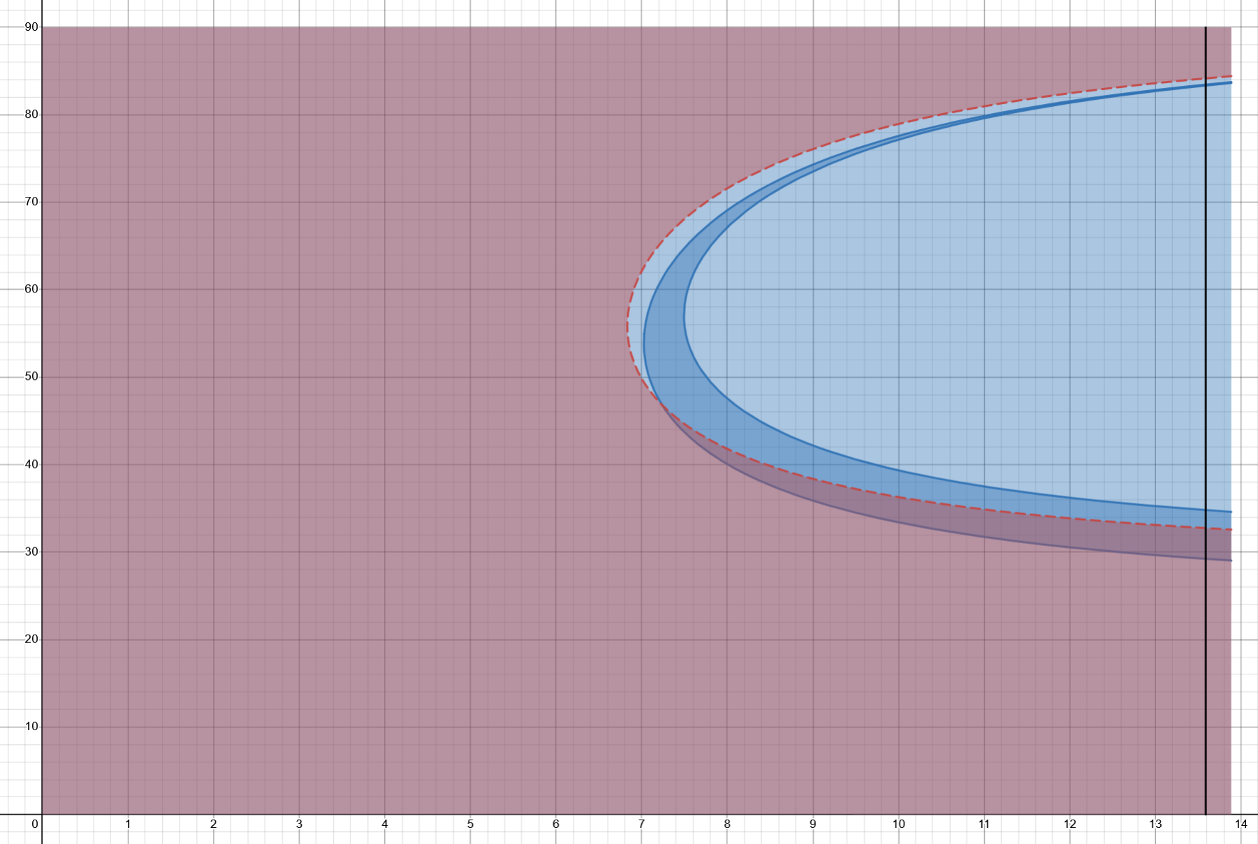

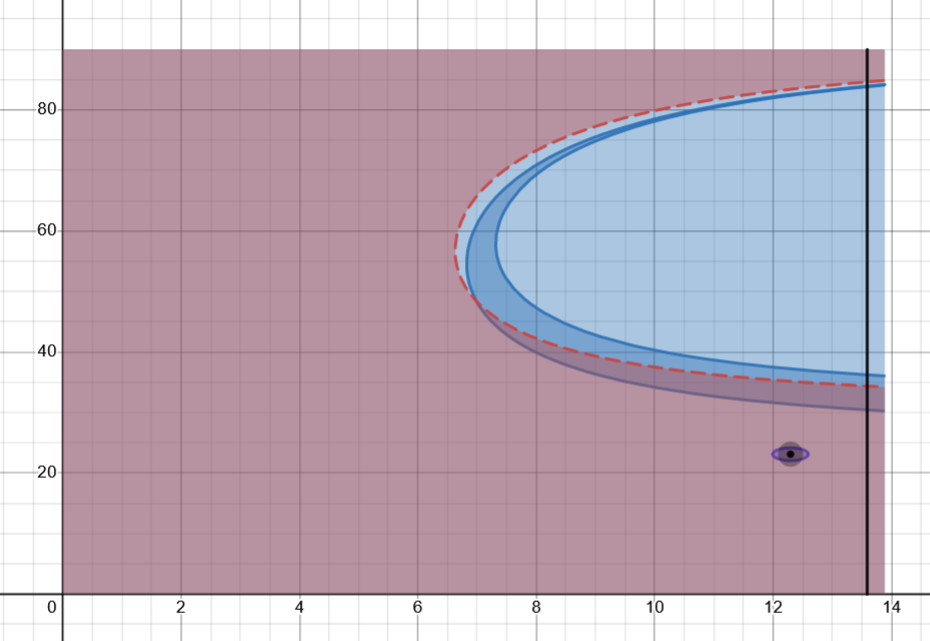

R \approx 0 is not a good assumption. Check how much it changes the graph in the ones I posted.
R \approx 0
R = 1
R = 1 is a reasonable length for most shooter arms. Notice how the edge shifts down by a lot if your arm is 1m long. Every variable matters at a distance. Close-up, maybe not. I realized the graph I posted had my previous version without accounting for the length of the arm. I’ve edited the link and you can play around with it.
Can’t seem to edit my post for some reason so I’ll just post the updated link here for the 2d graph: FRC 2024 Crescendo: Shooter Math 2D | Desmos
