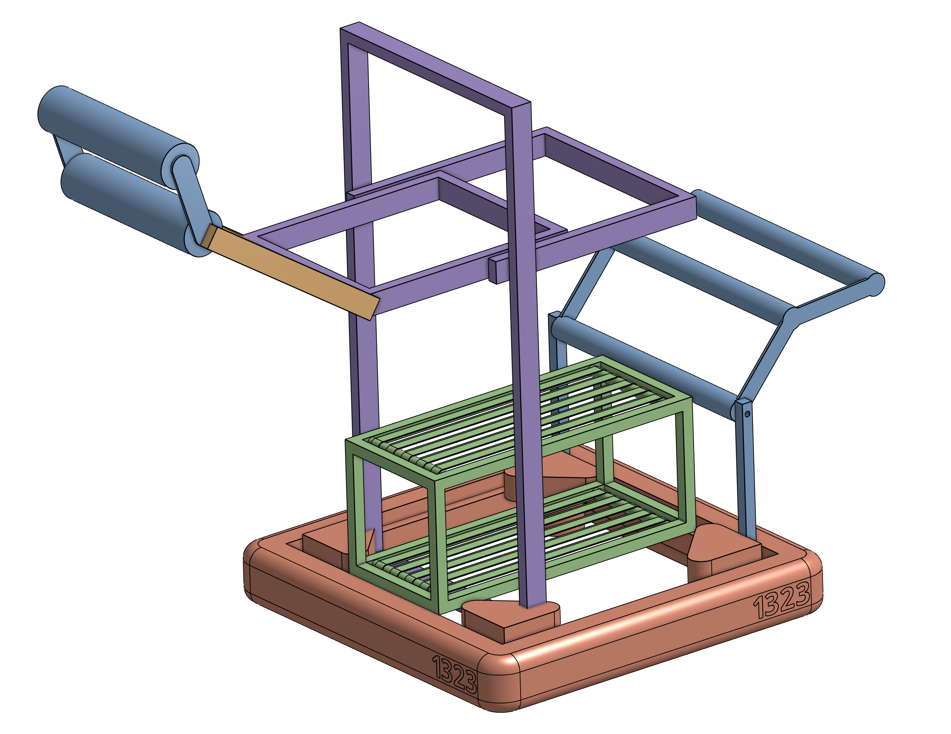

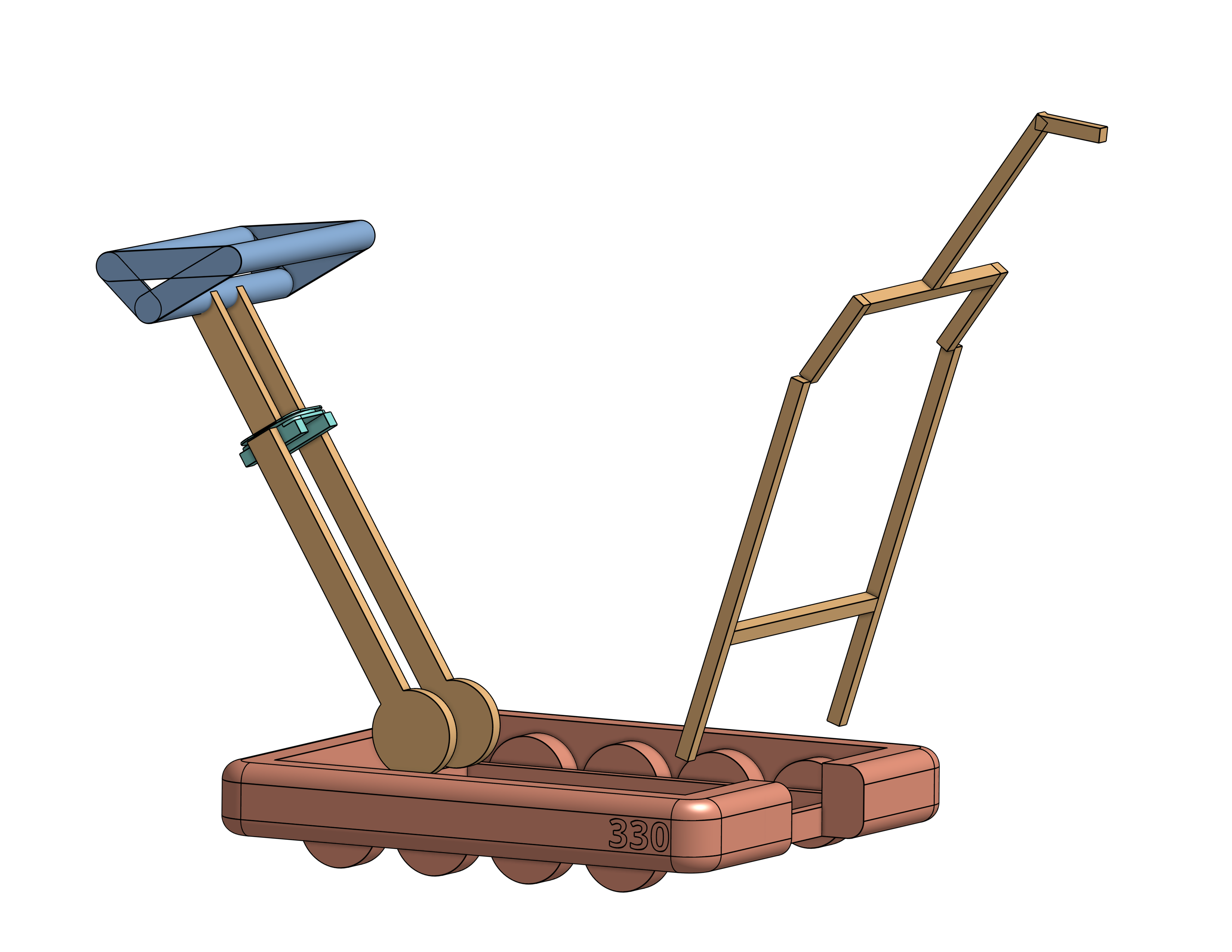

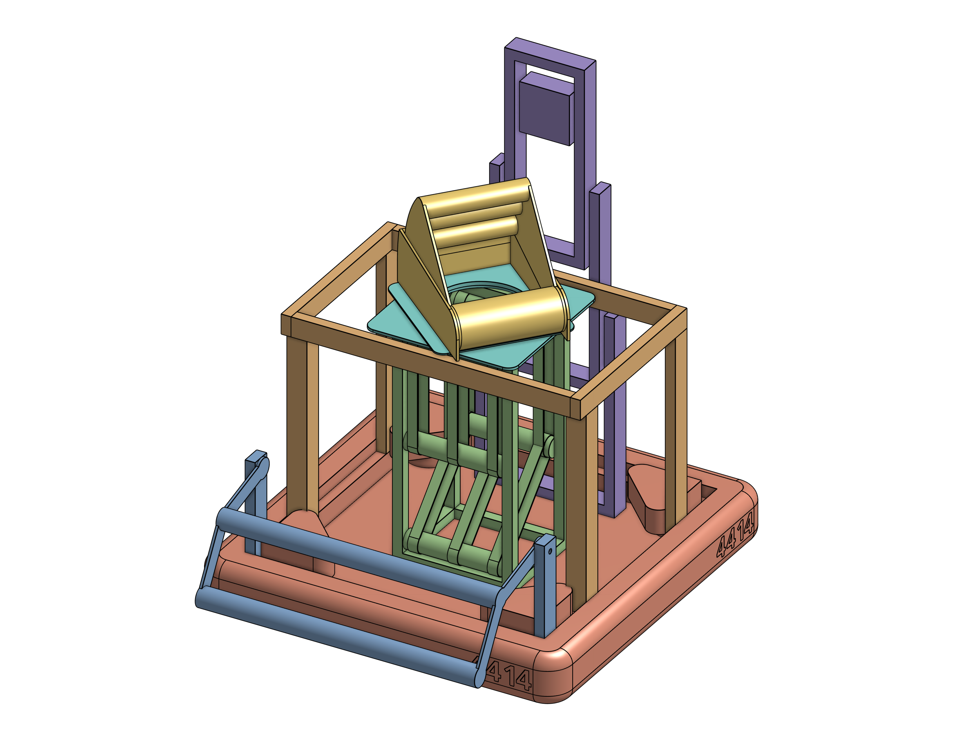

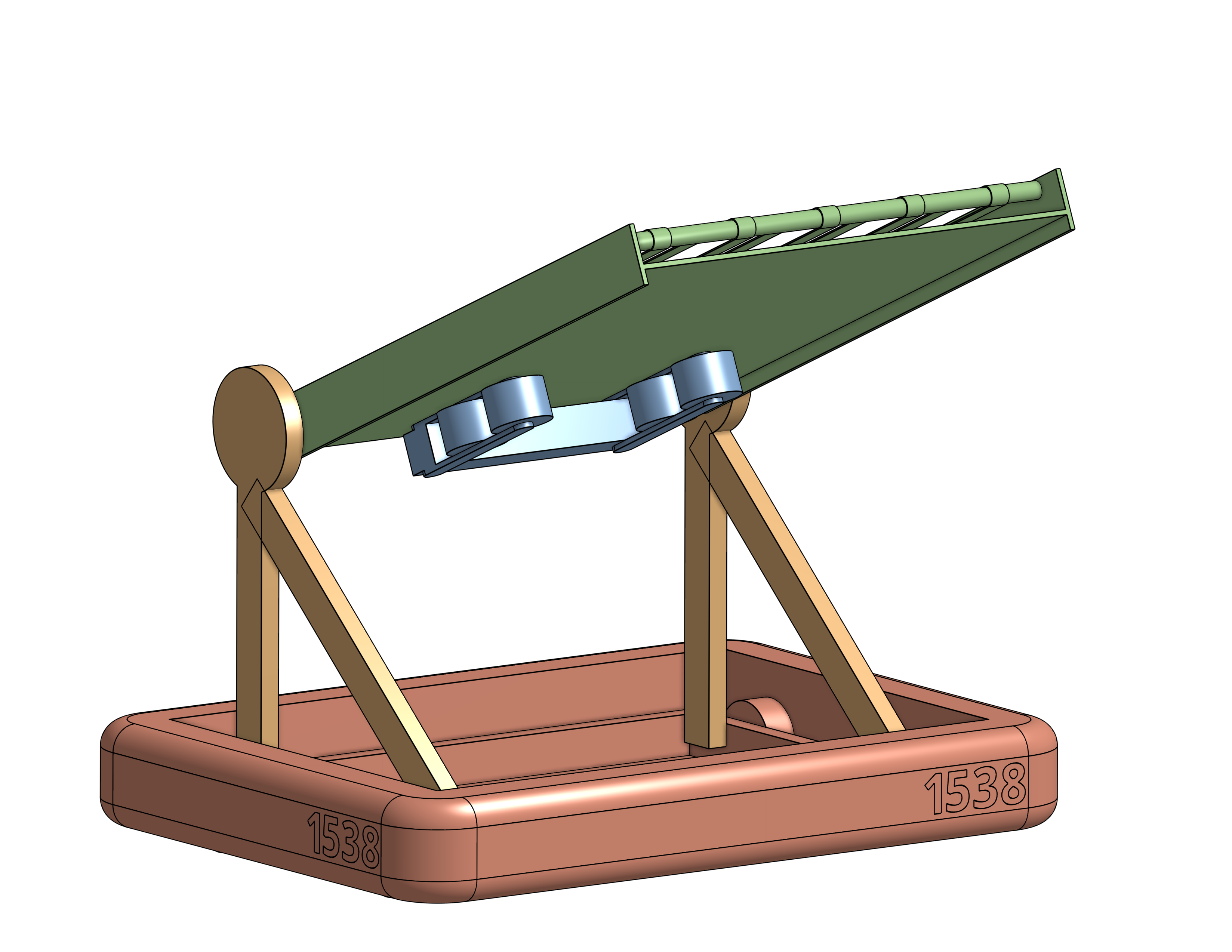

KrayonCAD Example Robots

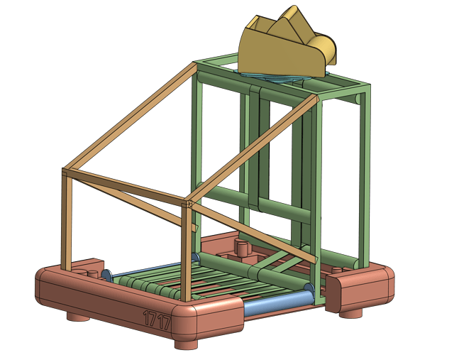

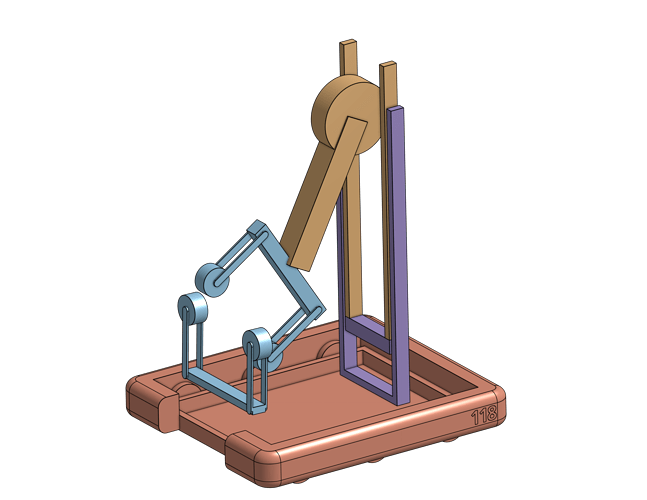

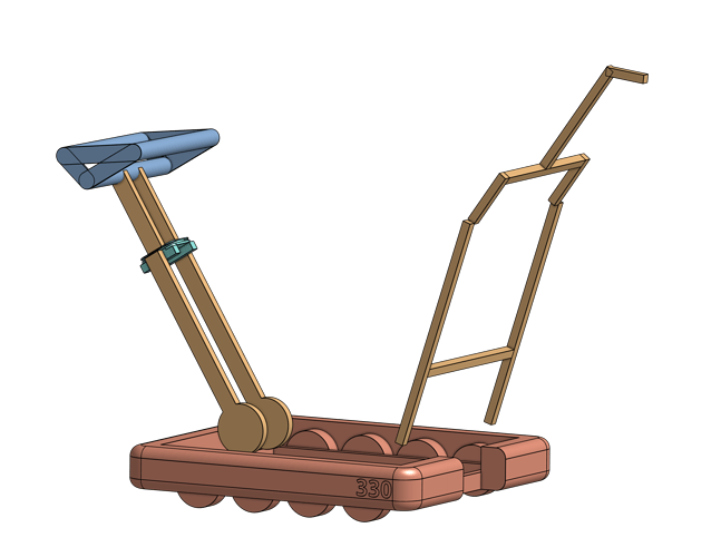

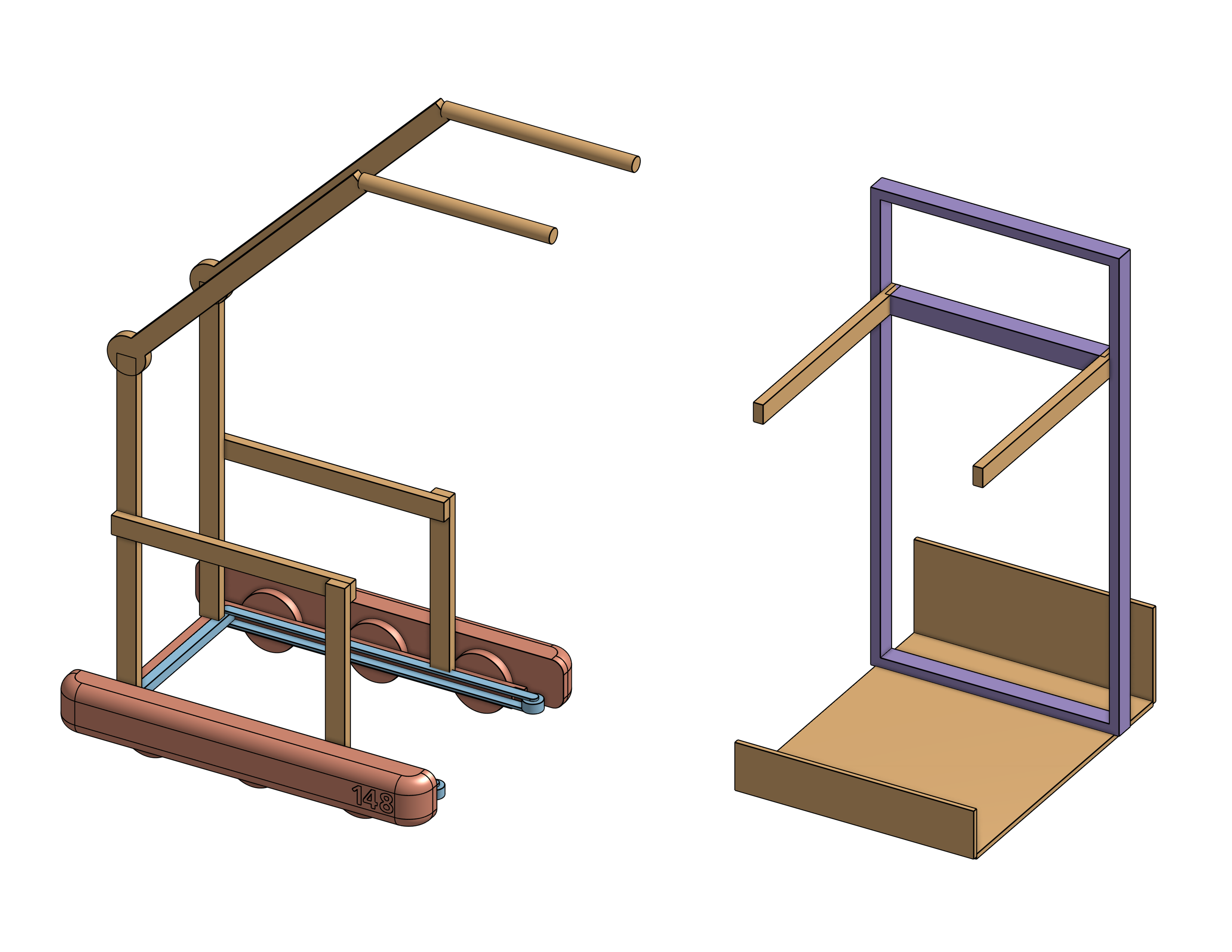

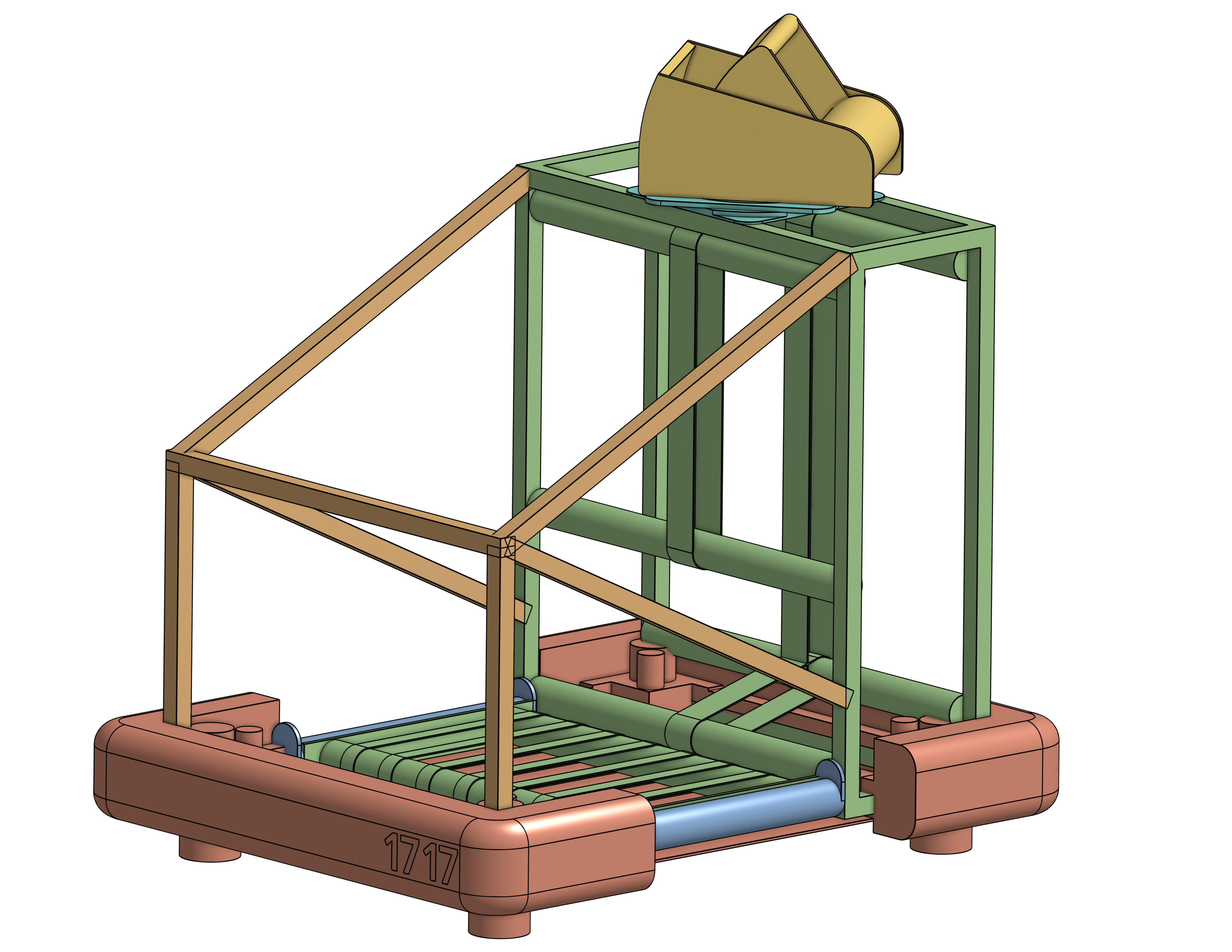

In order to demonstrate the versatility of KrayonCAD, our development team recreated iconic robots every year from 2011 through 2023. Click the link in the title above to check out these example robots for yourself!

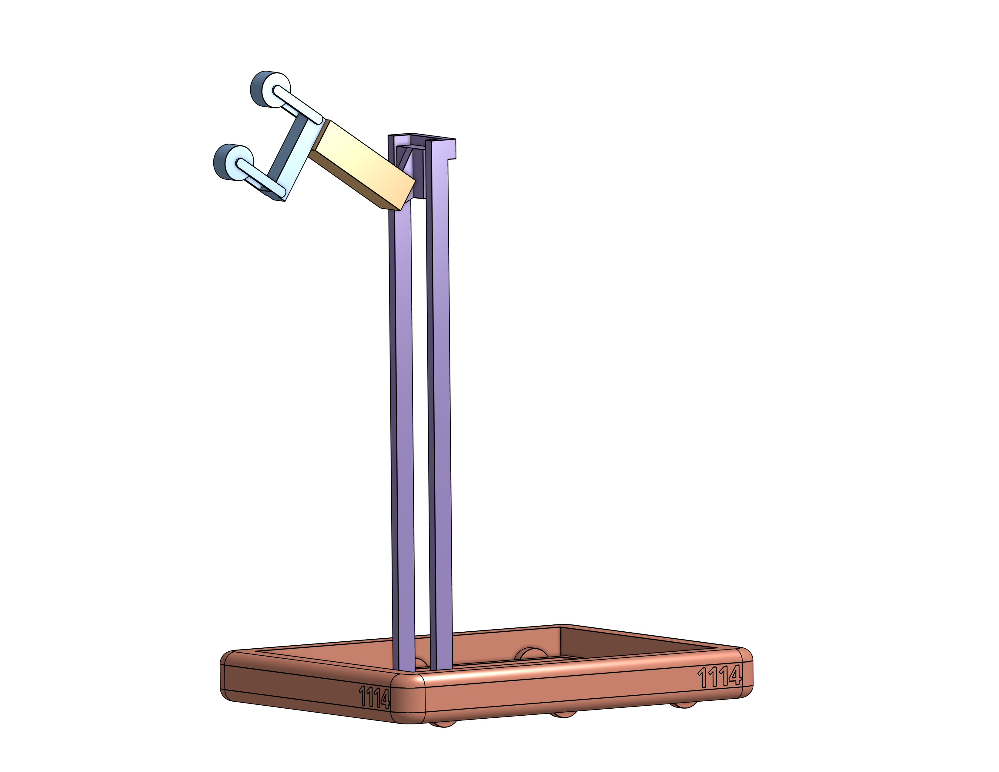

2011: 1114
2012: 1717
2013: 1538
2014: 254
2015: 148
2016: 330
2017: 125
2018: 118
2019: 971
2020: 1690
2022: 4414
2023: 1323

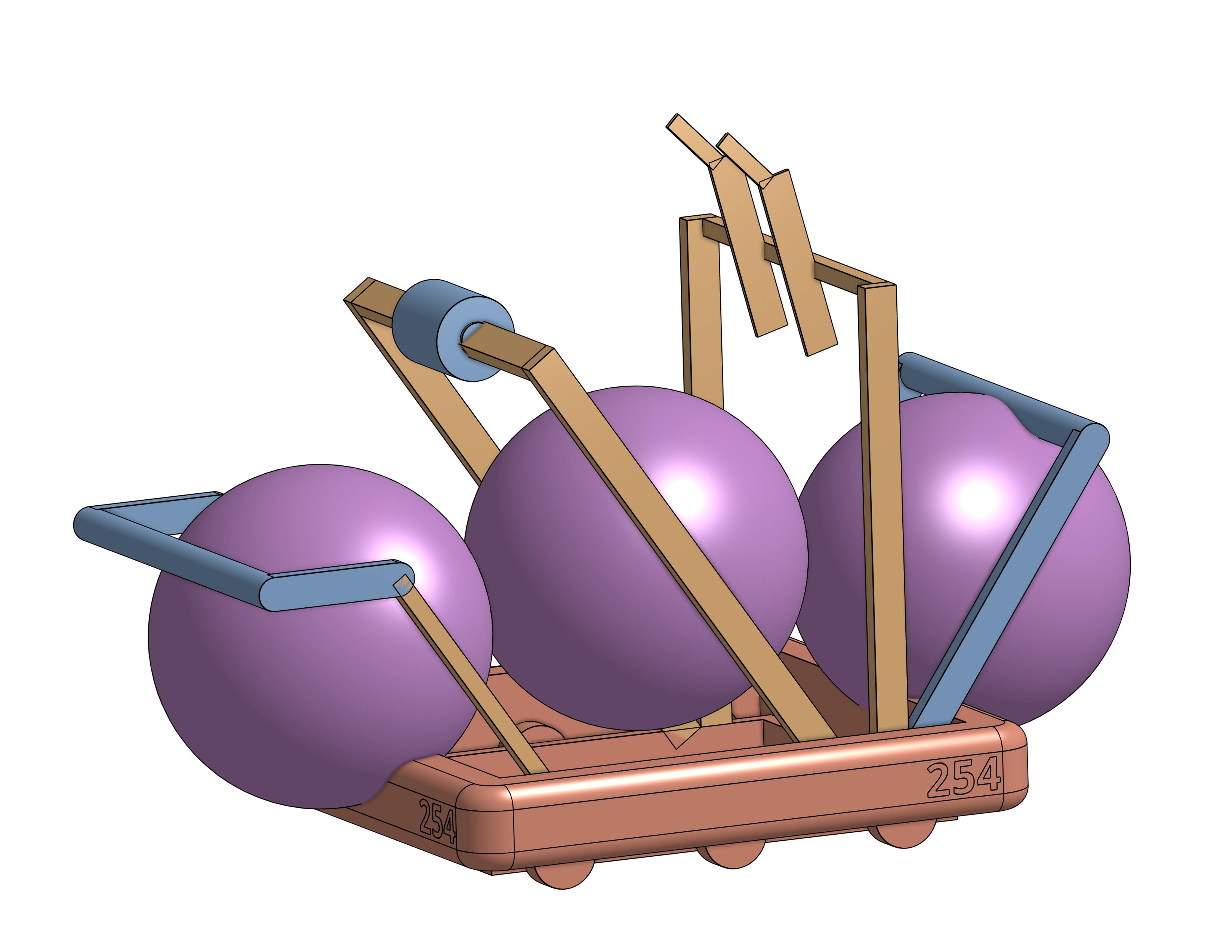

KrayonCAD Demo: 254 2011
In this video I demo the KrayonCAD workflow by recreating 254’s 2011 robot.

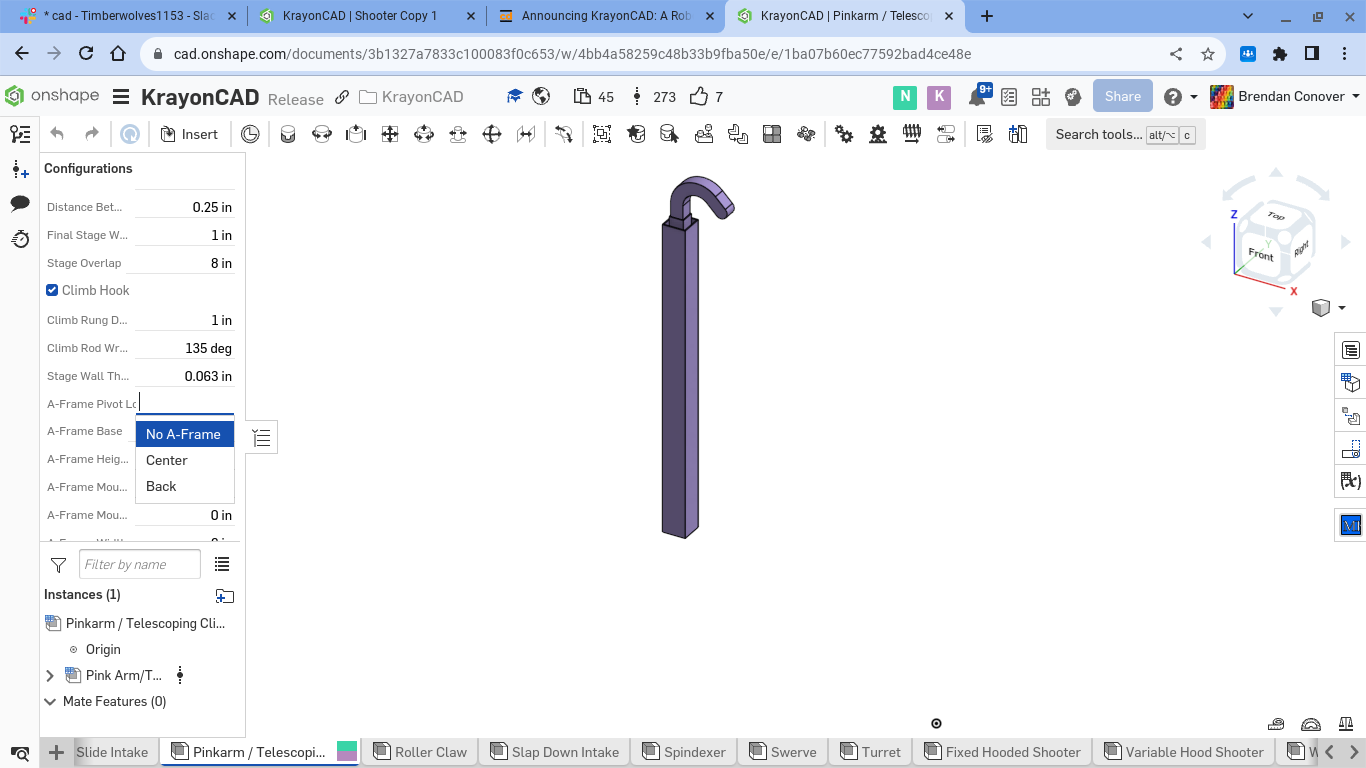

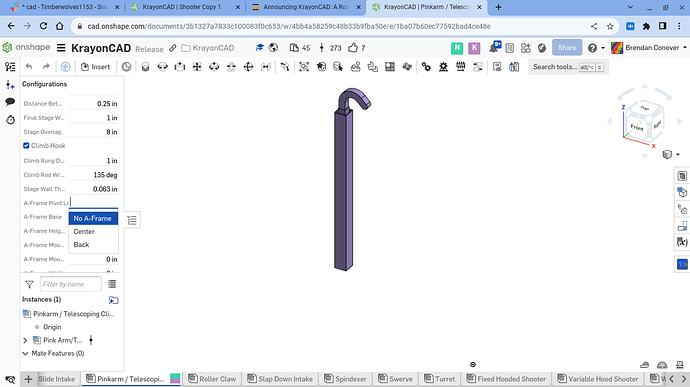

Feature request:
Pink arm pivot without the A frame. Have the pivot part of the arm but allows for easy integration with a custom frame.
Thanks for creating this tool. This should be a valuable resource for teams. I will ask our CAD team to try it out.

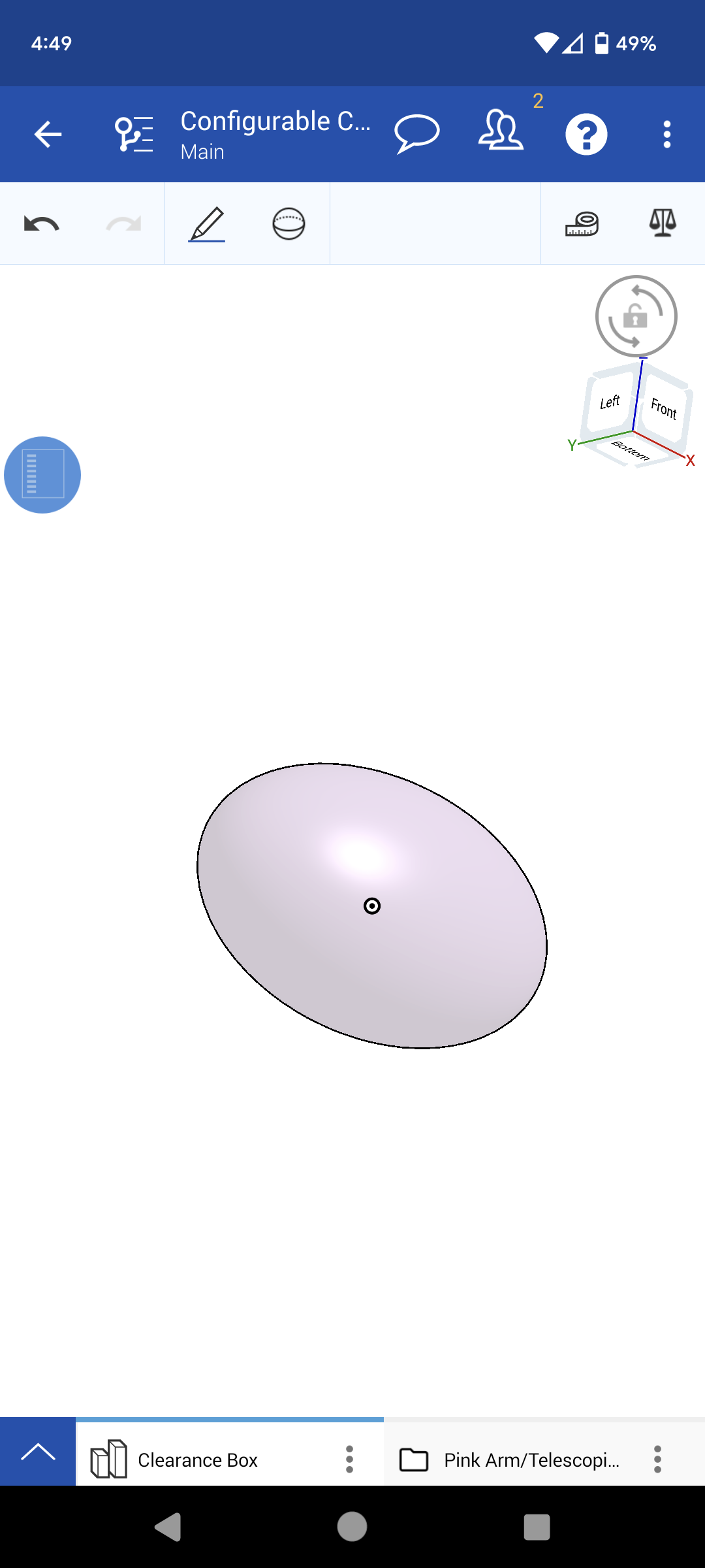

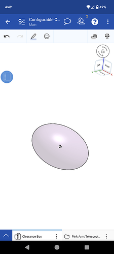

What function/mechanism is “8. Zoning”?
I could’ve sworn we have this. let me check
yeah @ElliotS if you scroll down in the configs you can make it so it has no A-frame.
These are meant to help figure out height/extension restrictions. They are transparent so you can insert them into a KrayonCAD Assembly without obscuring the robot.
Or you can make an egg:
Technically the No A-Frame option doesn’t have a pivot in the middle, but functionally you can do a revolute mate, select a face of the outermost tube, which should allow you to click a mate connector in the exact center of the selected face.
