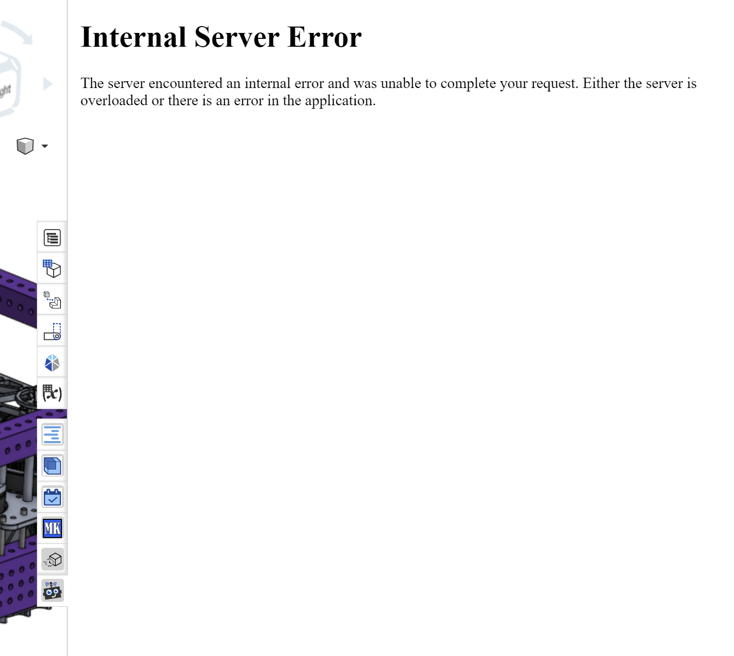

I tried to install and get this setup but I’m getting an error when I use the flyout.
EDIT: Well, it works in a different browser, so it’s likely a cache issue somewhere.
EDIT 2: Only seems to work in Firefox. Chrome, Chrome Incognito, and Edge all have the server error.
Issue should be fixed - thanks for the detailed report. I suppose that’s what I get for not doing a proper beta :sweat_smile:

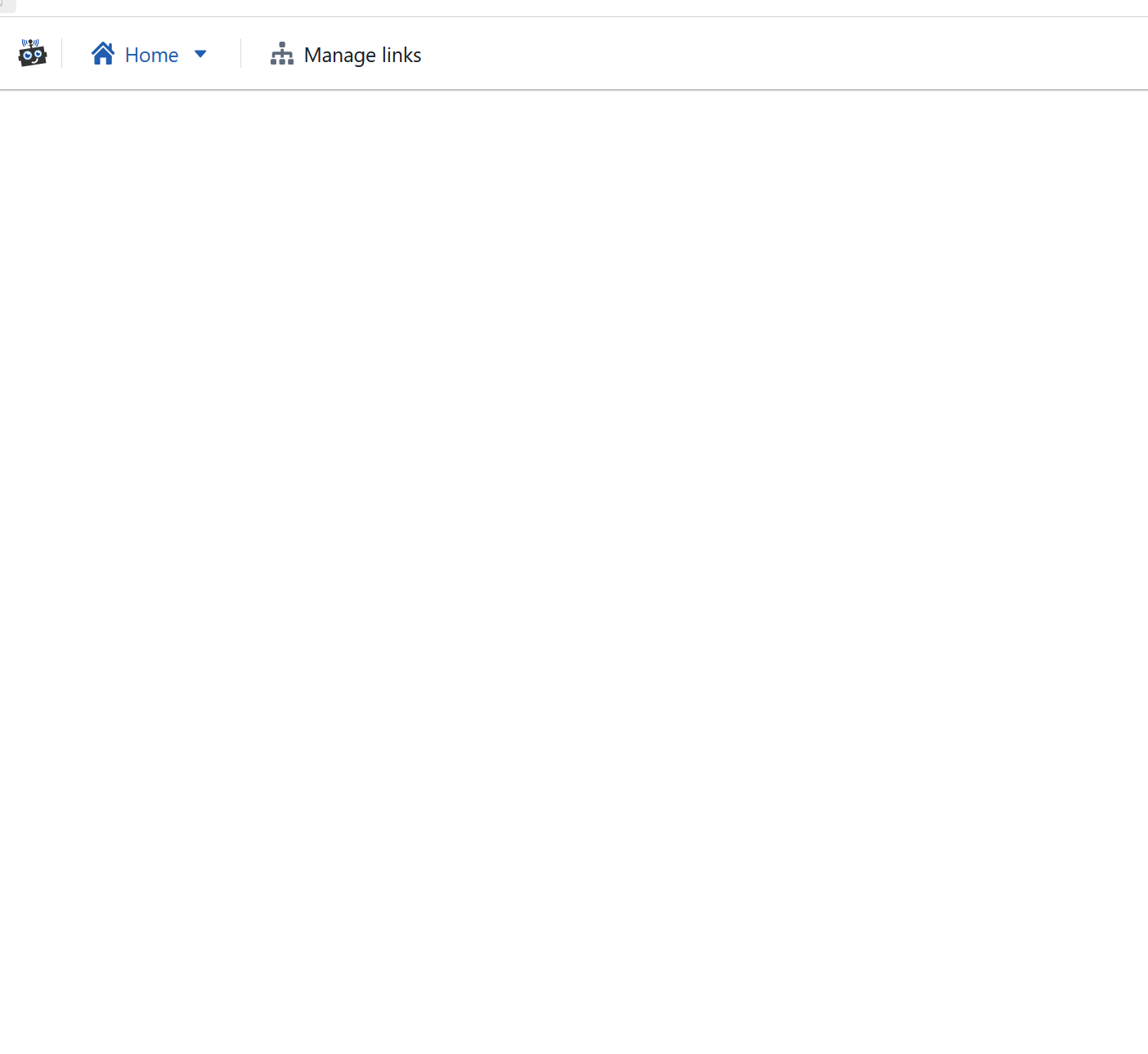

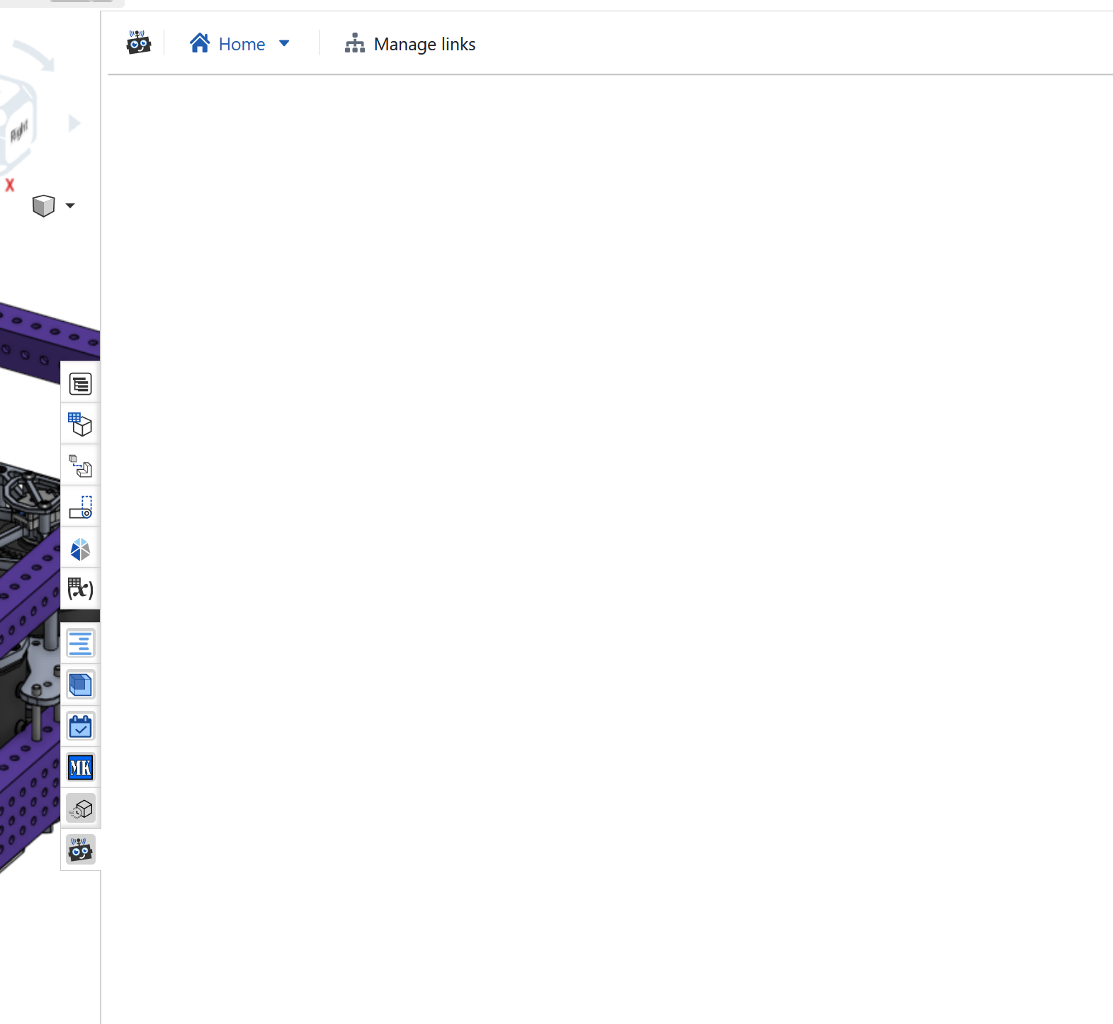

Is there supposed to be anything on the “Home” tab? It seems like the actual work is done on the “Versions” tap and home is just blank.

Home tab wasn’t blank for me, but after interacting with it a bit it became blank…

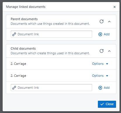

Hey Alex, really cool app. I’m looking at the manage linked documents window in my parent document and the listed versions keep glitching. The should be “1. Drivetrain”, “2. Carriage”, and “3. Arm”, but it keeps duplicating and removing things in the list.

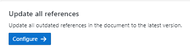

Also, the “Update all references” option seems very unlikely to be used in any team that’s also using MKCad, since they are regularly working with dozens of inserted parts and assemblies that have newer versions. Given the risk of breaking a lot of things with a blanket update of MKCad inserts, is there any way to have this tool only update the top level documents (“1. Drivetrain”, “2. Carriage”, and “3. Arm”)? Or some other solution that avoids automatically trying to update all MKCad inserts.
The Home page was intended to contain Assembly actions when open in an Assembly, and Part Studio actions when open in a Part Studio. Since there wasn’t actually any assembly specific actions, it was blank in assemblies.
The update I just pushed addresses this by renaming Home to Part studio or Assembly based on context. I also added a WIP message to the Assembly tab and changed the behavior so the Versions tab is the default when opening Robot manager in an Assembly.
It looks like some async logic I had was breaking things. It should be fixed now - please let me know if you’re still seeing problems with this.
Here’s a couple different ways of improving Update all references I’ve been thinking about:
  • Add a document selector to Update all references to make it possible to select specific documents you’d like to update from.
  • Add a tab selector to Update all references to make it possible to only update specific tabs.
  • Add an Update child references action to make it possible to only update references to linked child documents.
Let me know if any of them seem particularly useful, since I probably won’t implement all of them.
