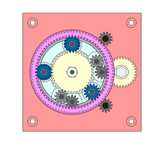

So apparently I can’t quit thedifferential swerve stupid idea. The problem I saw with the previous designs is that the steering ratio is too fast, which leads to twitchy modules. So in response, I’ve designed a gear train that adds another stage to the steering train after the differential. The result (if I’ve calculated correctly) is a drive ratio of 4:1 on 3" wheels, and a steering ratio (with one motor stopped, and one motor spinning) of 35:1 which is right in line with non-differential swerves, so it should be more controllable.
Of course, it still has entirely too many moving parts to be reasonable, but after a day of CADing, I figure I might as well share it in case it inspires someone else. Hope it does!

Can someone please explain how the differential part actually works. I’ve been trying to understand for many weeks now and I am still completely baffled.
This video explains it pretty well. Same concepts apply, just instead of a single input driving two outputs, it’s two inputs for a single-ish output.

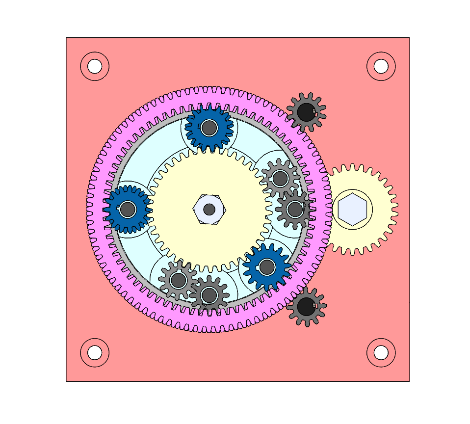

The planets (dark blue and gray) act like little balance beams, measuring the difference between each input ring gear (pink) and then:
  • Outputting the average of the two input speeds to the carrier (light blue), and on to the steering fork (green). So if both ring gears move the same speed in opposite direction, the average is zero, the carrier doesn’t move and the module keeps the same steering angle.
  • Outputting the difference in the two input speeds to the sun gear (yellow) and on to the drive wheels through the central shaft and miter gears. So if both ring gears move the same speed in the same direction, the planets don’t turn relative to the carrier. The carrier and sun gear turn together, causing the module to steer without* driving the wheels forward or backwards.
(*Without driving the wheels much anyway. The extra reduction between the carrier and the steering fork complicates the “turn in place” ratio in a way I haven’t fully thought through yet)
Sorry if that description doesn’t help. I’m much better at visualizing mechanisms than I am explaining them in words.
I’m pretty sure I just realized a flaw in the design. You can’t control the carrier speed independently from the sun gear speed, since birth sets of planets are connected to the sun gear. I think the doubled planets (gray) have to connect the ring gears only without touching the sun gear, like this: https://upload.wikimedia.org/wikipedia/commons/7/75/Spur_gear_differential_(Manual_of_Driving_and_Maintenance).jpg. If so, fixing the flaw would only require a slight modification to the carrier.
