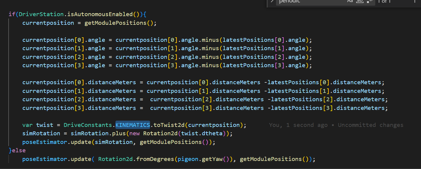

i am using this code and the robot just goes crazy when activated

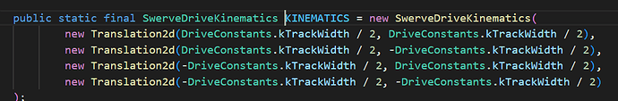

this is the kinematic object
You need to give module deltas (change in position) to the toTwist2d method, not the current positions. So for each module, its delta is current position - last position
Can you please give an example using those functions from the pictures of my code?

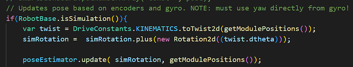

I use this code now; but the robot loses it begining angle every time
