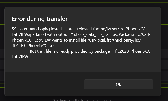

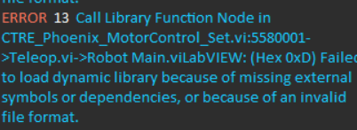

Anyone knows why FRC Driver Station shows this error message?
Our team is programming in LabVIEW. Only one Talon FX motor connected via CAN is used in our program. We use the CTRE motor library. We tried with Phoenix Tuner and it doesn’t recognize any connected device, neither the PDP nor the Talon; we also tried with Phoenix Tuner X, which does recognize the devices, but when running the program it doesn’t enable the motor.

Did you install the Labview libraries from Tuner X?
You’re going to need to be a lot more descriptive in what you’re doing. A screen shot of an error msg isn’t going to be able to help me understand what you’re doing or what you did.
Hello, my team is going through the same situation, I would like to know if you were able to solve this problem, and if so, how?
In case no one responds. The above error seems like a complaint that a previous year’s version is installed.
