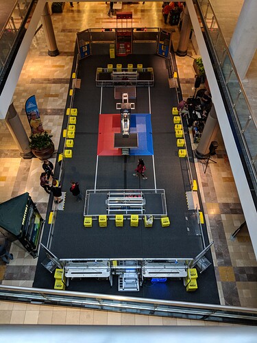

We and 3928 often end up doing something like this every year (minus this year ) at the Des Moines Maker Faire. Highlights have included a Stronghold Assist, stacking Power Cubes, and cross-game shenanigans:

I would totally play a season on this field
