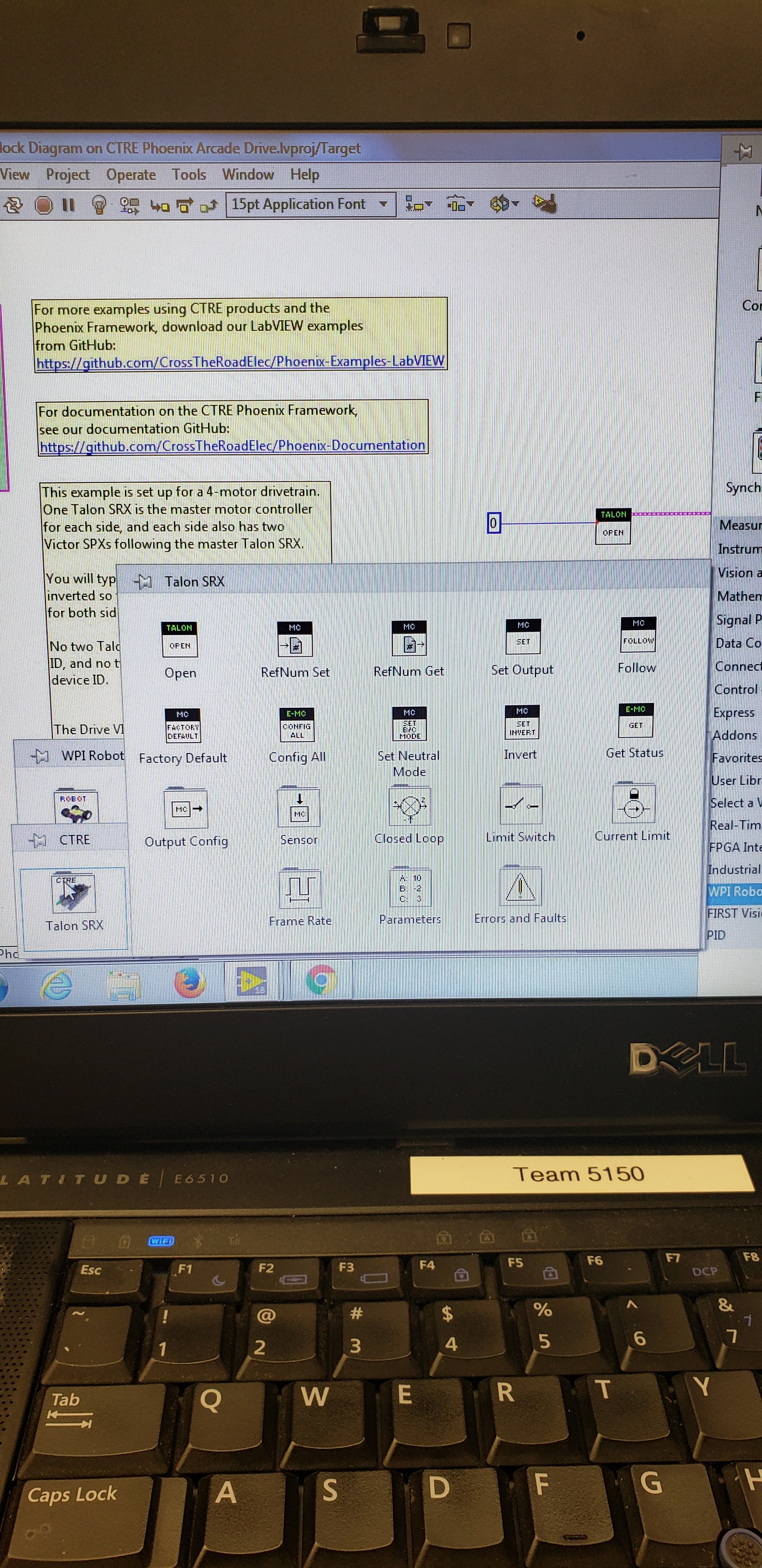

Arcade drive
I went into WPI robotics library
Third party
Ctre
Talon SRX
I had to download these blocks
Maybe I’m just wrong, that seems like the right place.
Why are they giving you the little red arrows where you’ve connected the numbers (first photo)? Maybe the data type is off?
I don’t know why those red arrows are there that’s suppose to be for device number but I’m not exactly sure on where to get the device number from

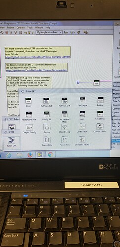

Delete one of the blue numbers and wires you’ve put in, and try the single best piece of LabView advice I can give you
Right Click - Create Constant
It may come up with something different.
They are numeric constants
If not idk, I no longer have LabView access post-graduation
Did you put them there yourself though?
Or did you right click on the Talon block ports and then hit “create constant”?

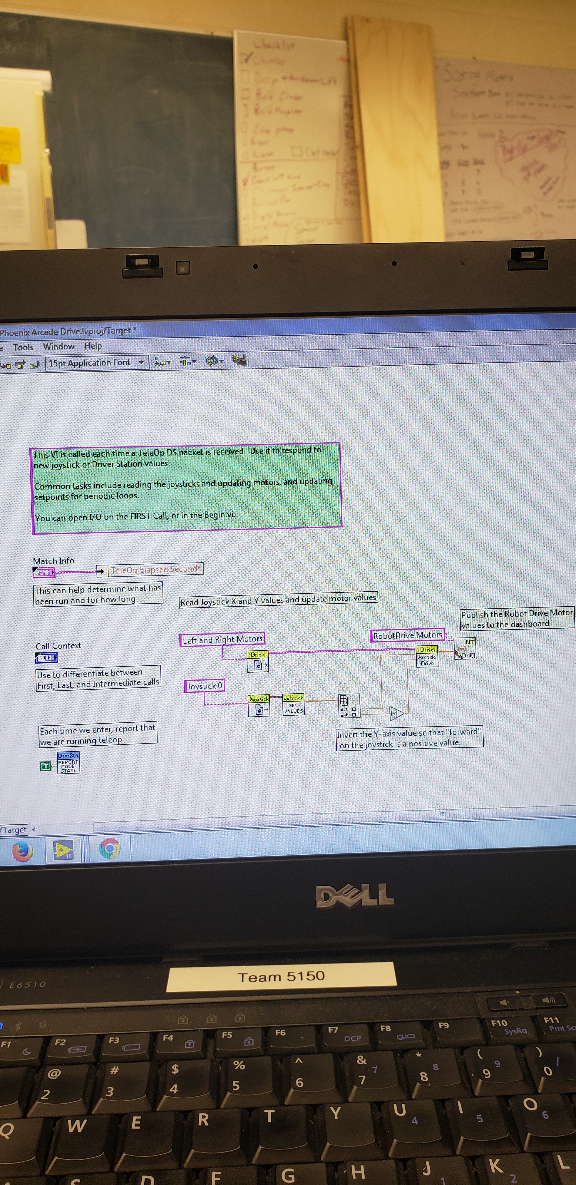

Can you show us what’s inside Teleop.vi?

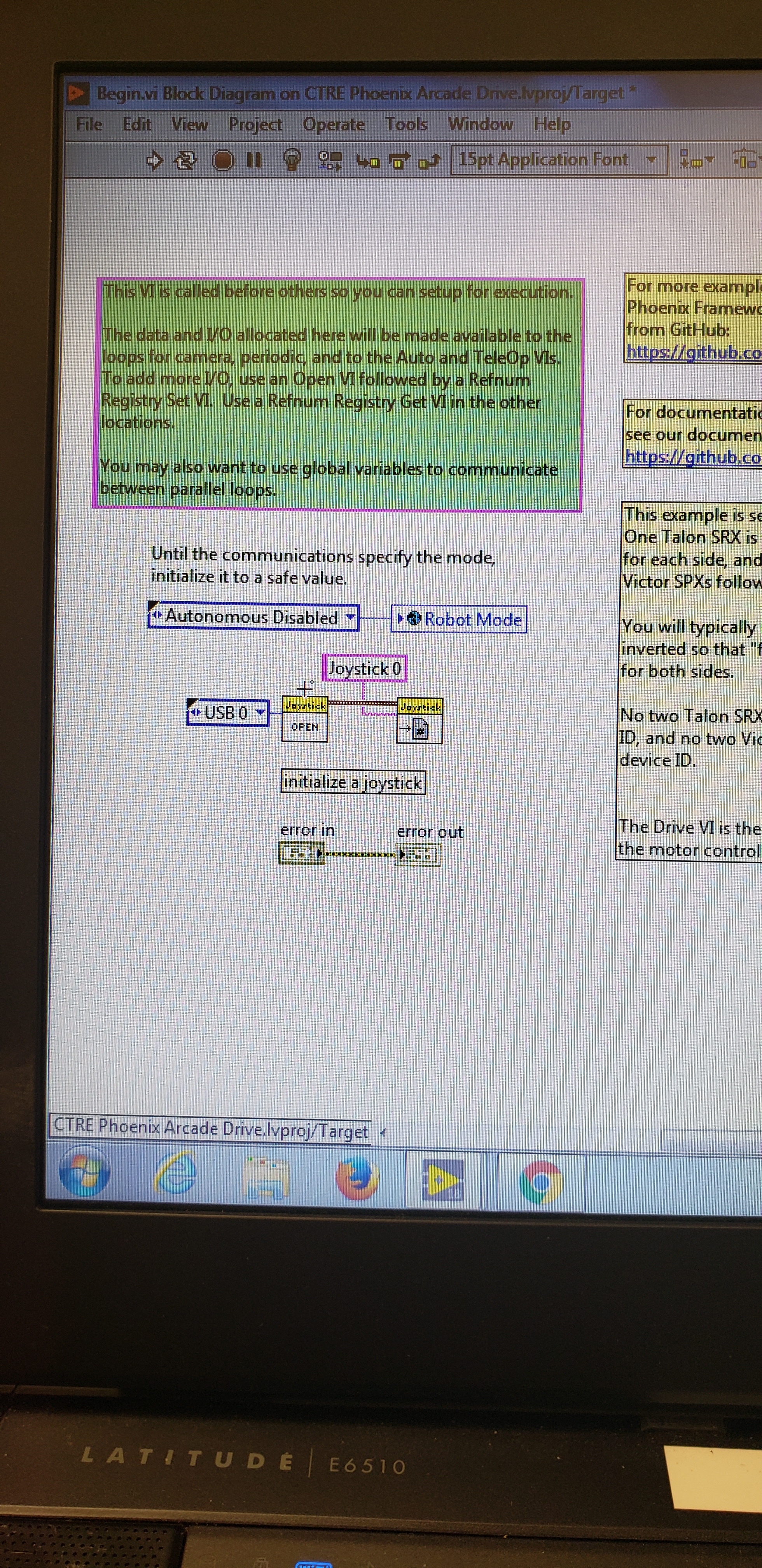

Your Begin.vi needs to also create Joystick 0, and save the reference. There should be some default Robot Project you can look at that shows how to do that.
This is in the beginning vi it was just out of frame
