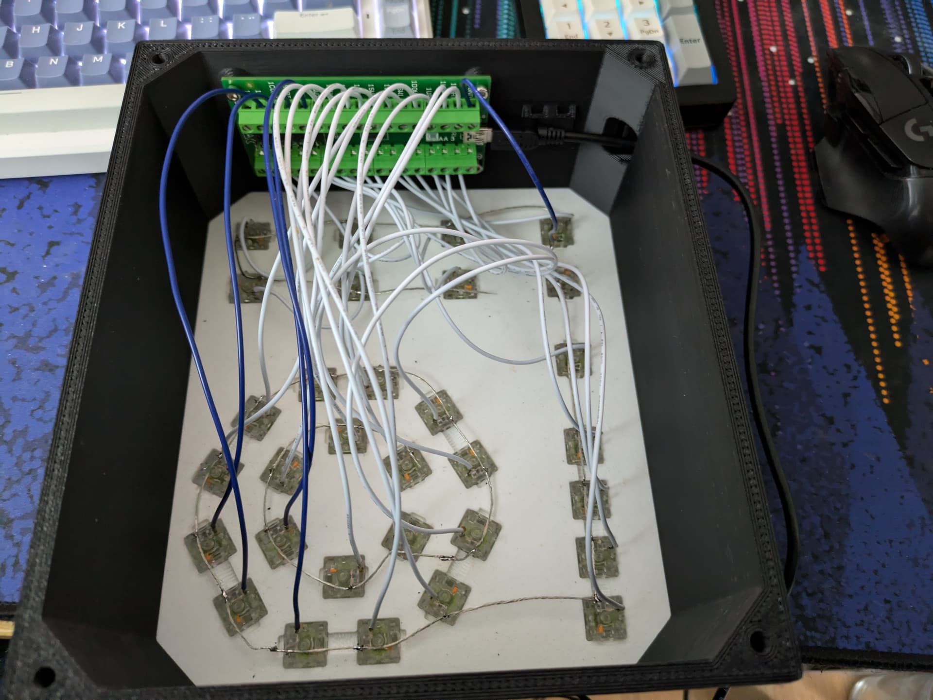

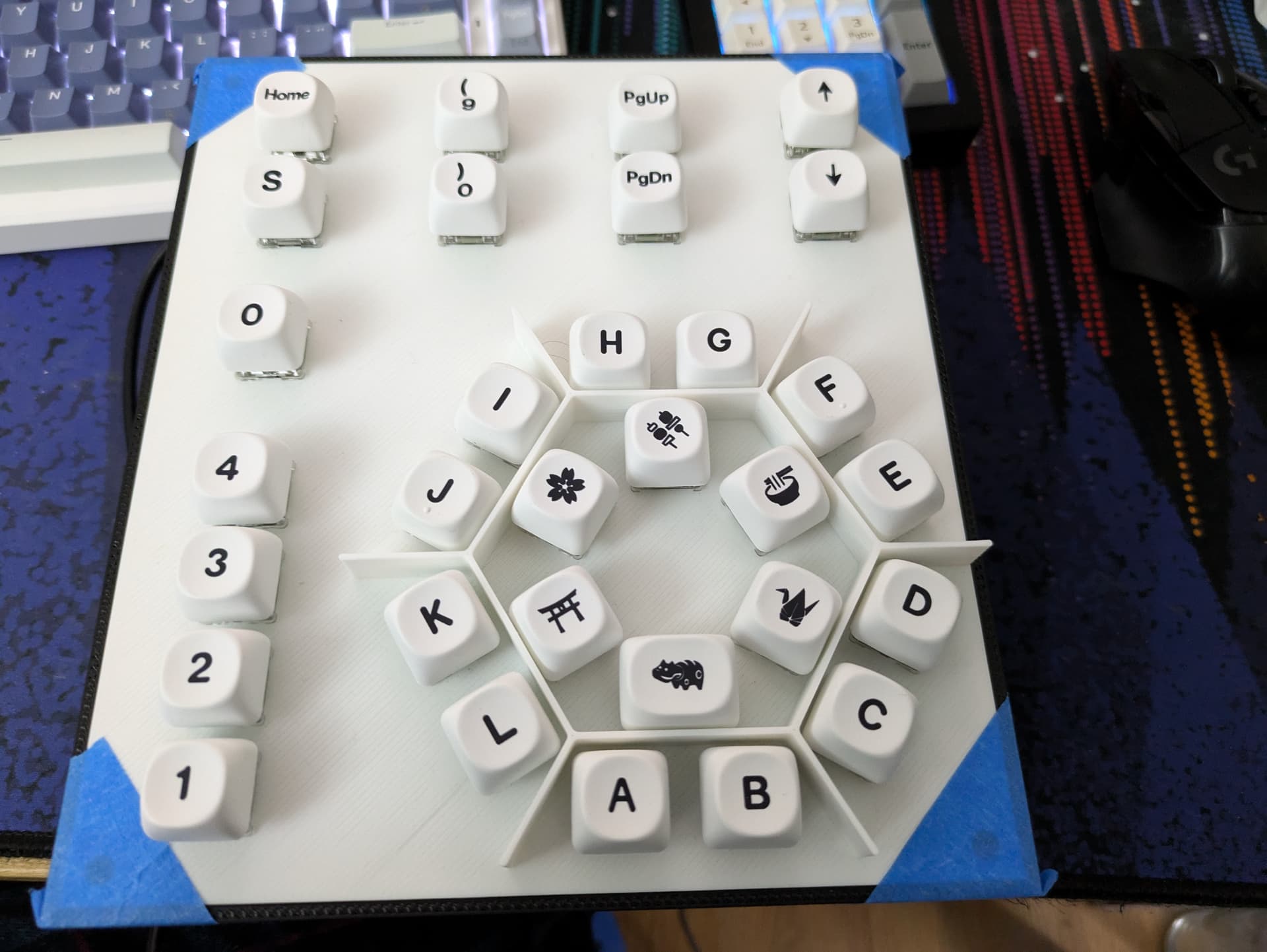

We bought an Ultimarc IPAC-2 USB arcade interface board as the basis for our control board. It allows you to wire up 32 separate buttons or switches and map them to gamepad buttons/axes using their configuration software.
From there we created a layout we liked using mechanical keyboard keyswitches purchased on Amazon, 3D printed an enclosure with sockets to hold the keys, and then performed the tedious task of soldering wires to each key that are installed in the IPAC terminals (a common ground is run between all switches). This has worked out great for us and been very reliable. I actually highly recommend keyboard switches instead of cheapo arcade buttons since the quality, durability, and feel when used are far superior even for inexpensive switches.

the soldering!
we used buttons with real solder terminals, but the buttons aren’t great. did you do anything special to make the soldering to those tiny pins work well?
A dab of flux and a good iron makes it easy. The pins aren’t tinned so flux helps a lot.
