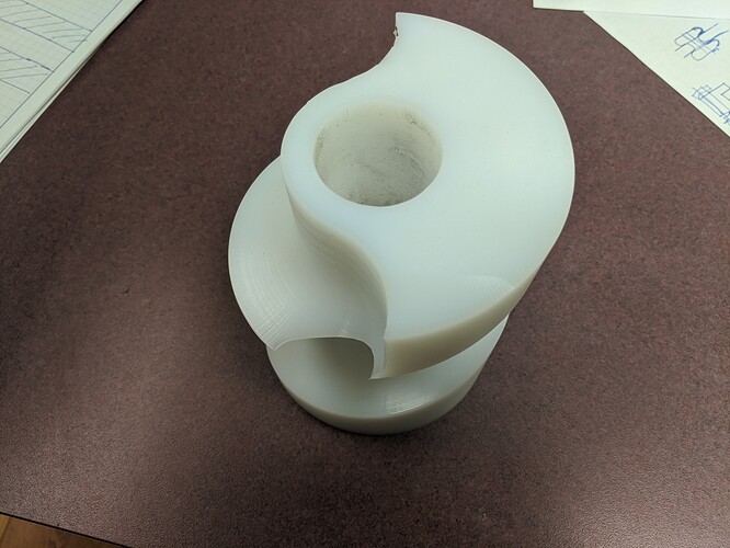

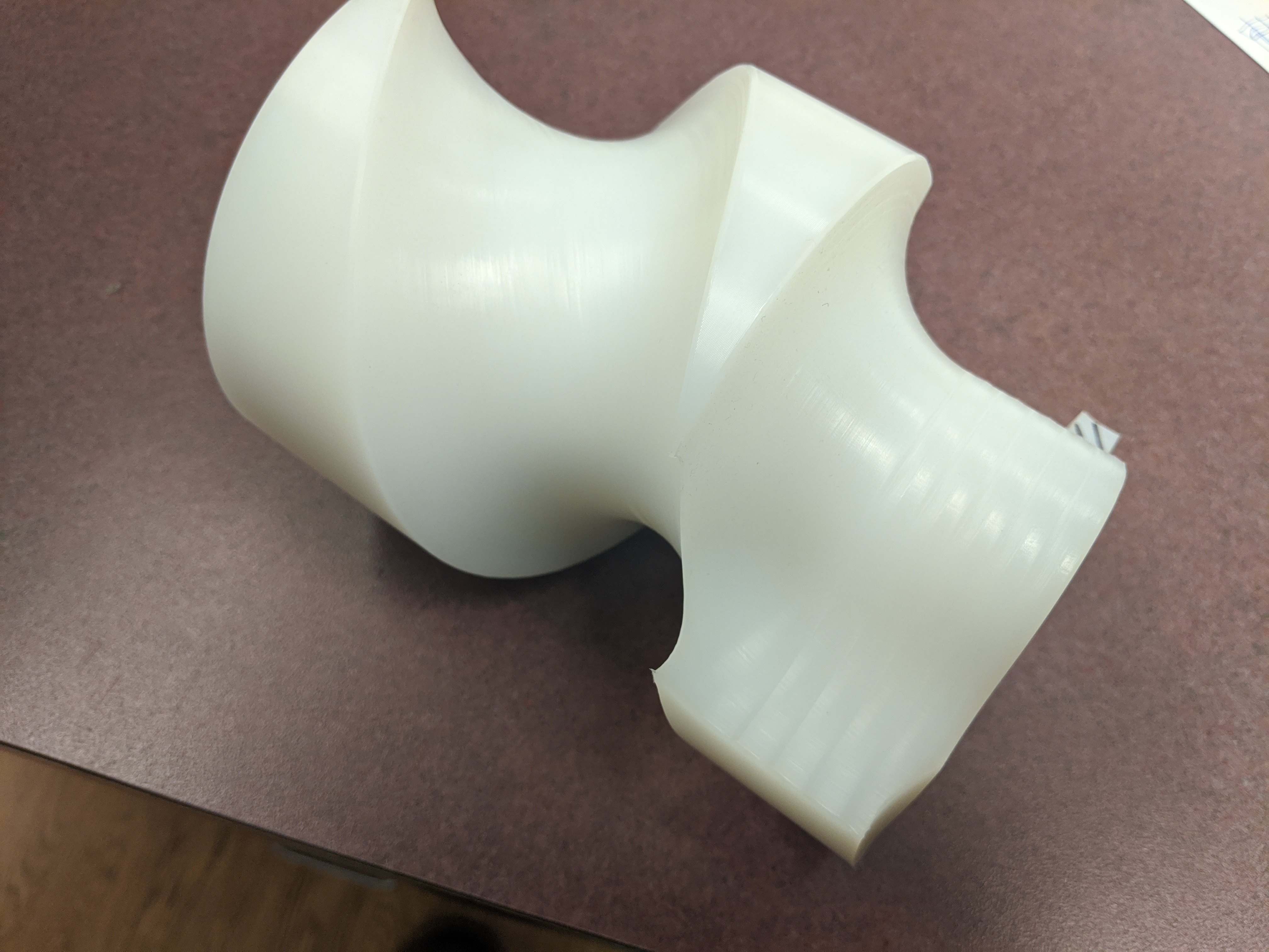

These screws are generally made on a CNC 4-axis mill. My company uses these in various applications and they work very well for objects that are rather rigid and have at least two differing dimensions.
We’re currently using them on an application with a certain popular chocolate manufacturer for their mould trays, and have also used them extensively with a certain popular brand of soup for transporting their cans. They are incredibly neat and mesmerizing mechanisms. The capability of them to both reorient and merge at the same time is heavily coveted in the material handling world.
Below is a picture of some test pieces we had made for the chocolate application.
