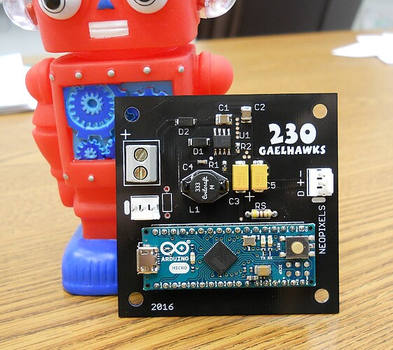

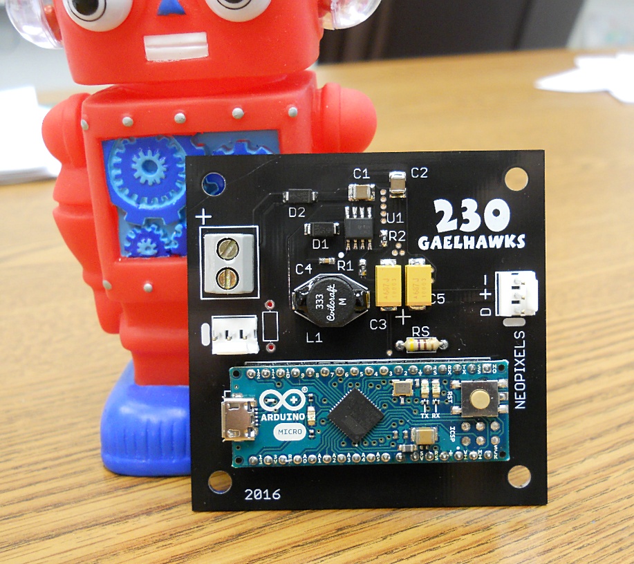

#11
This is what we use to drive our Neopixels:
We use more Nano clones than Micros, though.

#13
Nice board!
