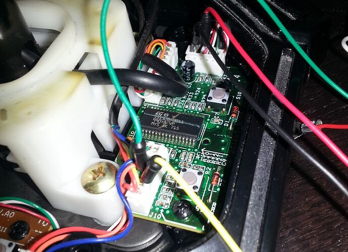

to answer your question, i took apart the attack 3, where the usb comes into the housing there is a red and a black wire, and a few more but dont worry about those, so i ran the red to the 5v supply on the arduino and the black to the ground. then on the right side of the stick there is a 5 pin connector. Red, yellow, green, orange, and blue. The red and blue are power, the yellow and green give direct analog output though, so does the orange but that is for the throttle control on the back of the joystick. So since I gave the entire joystick power through the wires on the usb, I can really get all the buttons to work, but I connected wires to the green and yellow wires and was able to get an analog read on the arduino

Your link is broken or requires a log in.
that should be better, sorry
