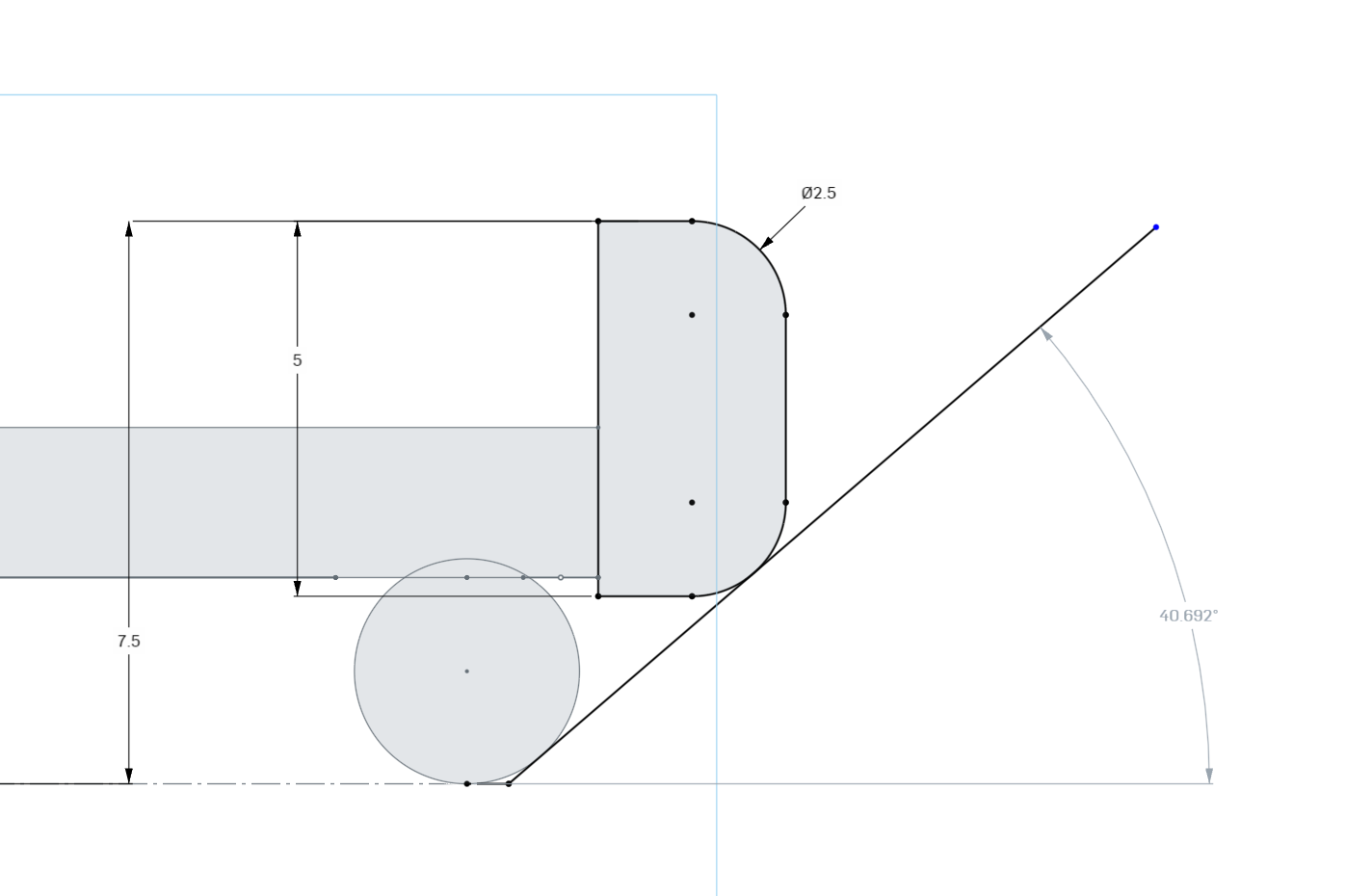

You can mount the plates on the the tubes for another ~1’ of clearance.
You still need to account for the bumper zone. At minimum you will have lower points of bumper on the corners.

I think any drive train will make it up. Heck I think 2008 or 2009 or something like that we made it up a much steeper ramp like that with mecanums As long as whatever wheel you have has enough grip on PC you ought to be fine. As for 3 and 4 in wheels - you need a bumper to clear it you have about 2 in max under the bumper to have a legal bumper within the bumper zone so that means a 3 or 4 in wheel should make it as long as you start of slow and dont hit it at a 100mph.
It would be possible, I mean if it simply takes a little bit of pressure (weight of a drivetrain alone even) to lower it, it should be feasible, the ramp only has an incline of 11 degrees where the ramp meets the charging station, the station itself will be at 15 degrees

MaxSwerve is fine. 26" long robot shown.
You can get yourself unstuck too.
SDS MK4i is fine (bumpers at 6.5" to top)
swerve_chassis_clearance_1
swerve_chassis_clearance_2
