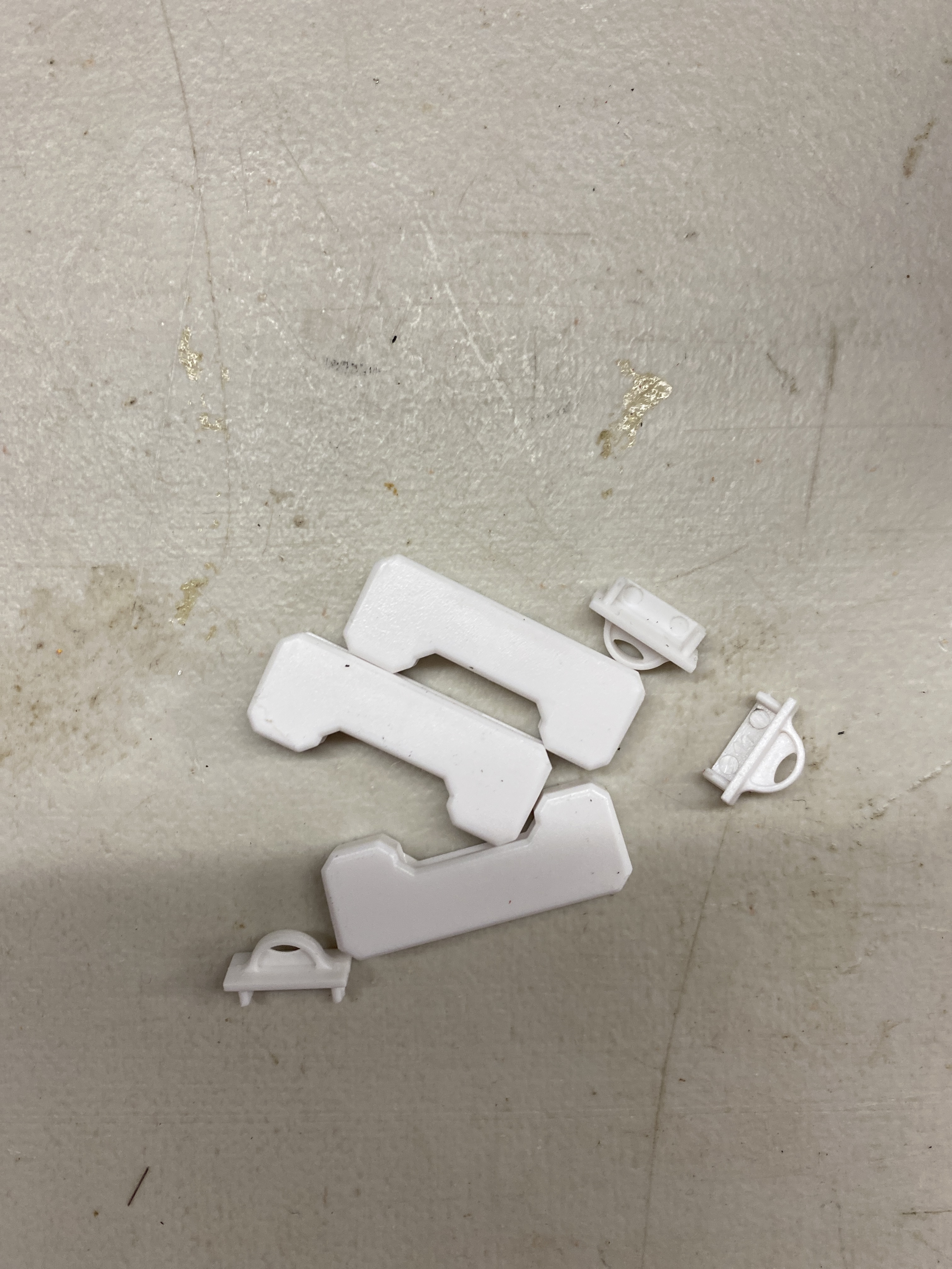

Are these useful?
These came with Spark Max packaging, but idk what they are for
The larger ones can be used to hold pwm connections together. Plug one PWM cable into another, then clip it over them. It helps keep them from coming apart on the robot.
The smaller ones are dust covers for the ports on the sparks. They prevent things like metal shavings from the robot getting stuck in an unused port and causing issues.
(note that the large ones also fit over the CAN connectors that come with the SPARKs)
