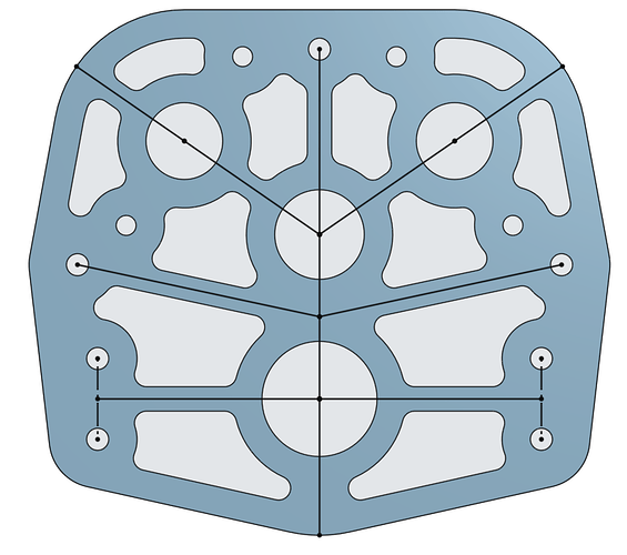

Gearbox Plate Extruder
Extrudes a plate of your desired thickness that encloses the gearbox entities of your choice. You select the points or circles defining the holes that you want to be “enclosed” in the gearbox. For each point or circle you select, you choose an offset defining the minimum distance between the point or circle edge to the outside of the plate. The featurescript automatically finds the tangents connecting the outside circles and extrudes a solid plate. Note: circles/points must be selected in order (CW or CCW) and only the outermost circles/points should be selected.

I added the ability to select sketch regions to cut out of the plate. It won’t do recessed flanges, but it will do the basics.

I just pushed an update with the gearbox lightening featurescript:
Gearbox Lighten
Hollows out the plate on the face selected, except for the ribs you select and a margin around all edges. For FRC gearboxes, It’s a good bit easier to use than the regular Lighten featurescript. The regeneration time is around 1-2 seconds, depending on the number of pockets.
