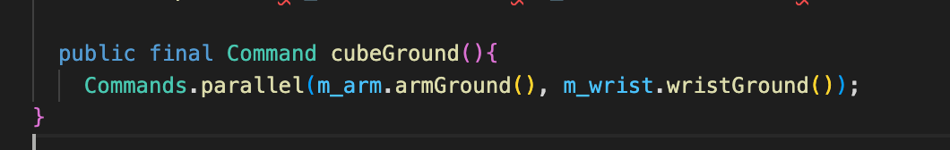

Ok, is this how I would name the command in RobotContainer:
And then for joystick I can just call
new JoystickButton(operator, 9).onTrue(cubeGround());
You need a return statement there, since you have to return the command from the factory method - otherwise, yeah, it should work just like that.
