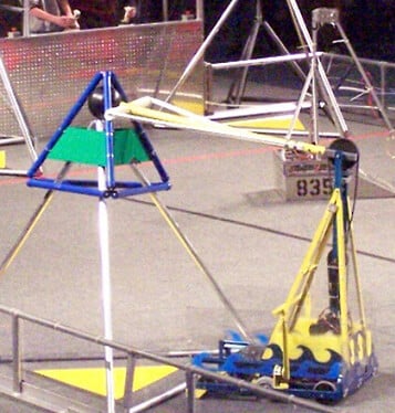

Pulls out the 2000, 2001, and 2004 BeachBots… We got away from elevator to arm, and went back again… (Actually, the joke I make about 2004 is that it was the most BeachBot of them all, one blue elevator topped by one yellow arm. Gotta see what I can do with getting it operational once we can get back into the shop.)
The part I always found funny was that our 2005 L.A. Regional winning alliance had three robots that were of the same type: single-joint arm, passive gripper, skid steer–all different robots, though.
