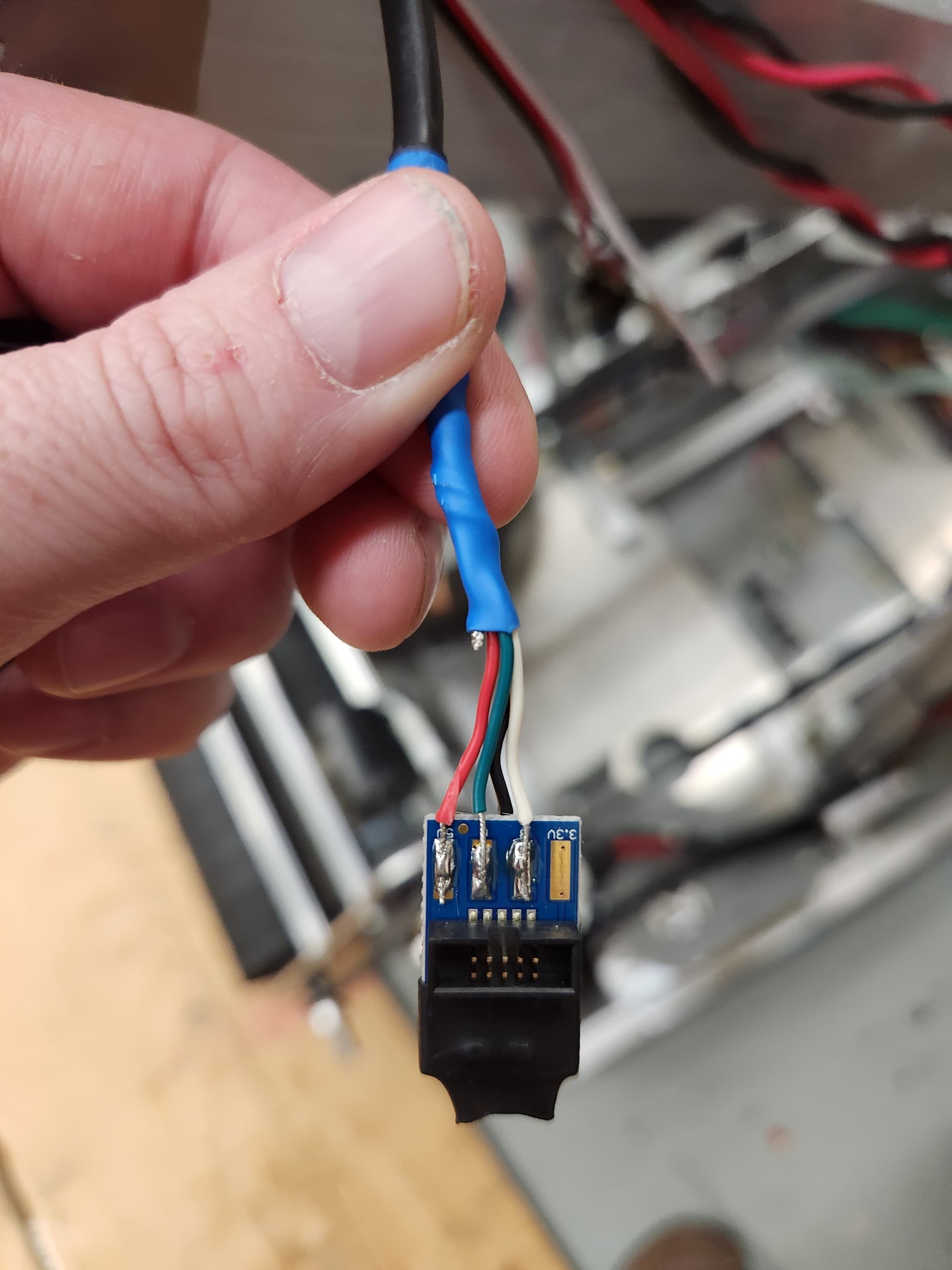

Specifically we are using a breakout board to wire the Armacoder to a TalonSRX. The sensor values only ever change between 96-100 regardless of amount of rotation.
We are trying to read the values in Phoenix tuner.

here is our breakoutboard wiring. Still not seeing any changes to sensor position in phoenix tuner.
Thanks for the clarification. The quadrature encoder values all read zero.
Maybe something happened to it, please email us so we can send you a new one.
