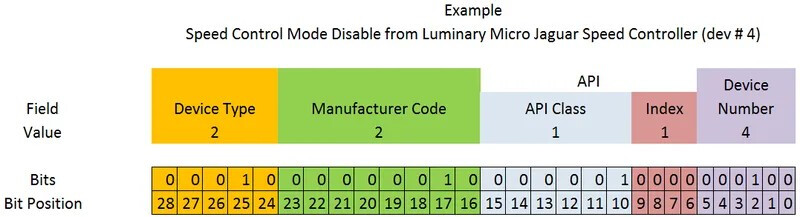

I believe the exception to this is in the case of a CAN sensor, as that would likely require an ID reservation from FIRST for the CAN network.
I’m not sure what you mean here? CAN ID is set on a per-device basis, not per device type. I am not aware of any reserved IDs on our networks, can you share more information on what you are referring to?
You can get reserved manufacturer ids from FIRST that you use to address your company’s products.
Gotcha. So in this image from that link, the CAN ID that is set on a device (motor controller or whatever other device) is the “device number” field value? Do the device type and manufacturer code get inferred from the class instantiated in the code?
Yeah. So when you make a new LittleEngineThatCould(4) in code and set something, IThinkICAN’s vendordep would send out a message with a Device Type corresponding to LittleEngineThatCould and a Manufacturer code corresponding to IThinkICAN. Apart from listening for the universal heartbeat and the disable message, I don’t think rest of the fields have to actually be followed.
