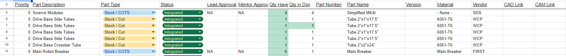

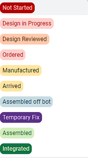

  • BOM/robot tracker: my team is having some success with what we call a “robot tracker”. It is basically a BOM (bill of materials) mixed with a to-do list and a barebones inventory. It has (almost) every part on our robot, broken down by subsystem, with a bunch of info about it. this helps to highlight next steps or areas that are running behind as well as keep everyone on the same page. It can also be referenced for ordering or machining. here are some screenshots:
There is a LOT that I cant even begin to cover, but 971 has a good overview here and there is lots of advice for project management and fabrication in other CD threads.
