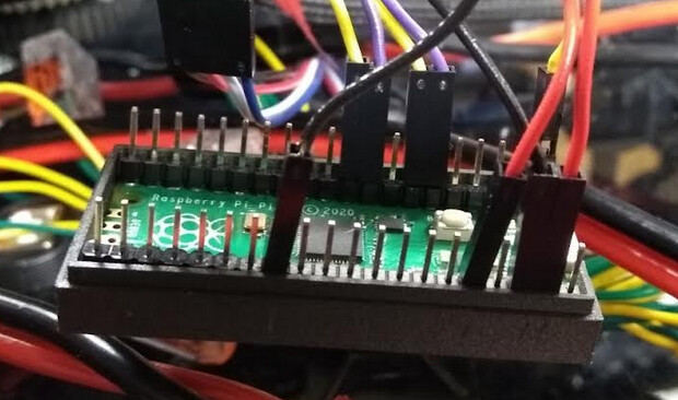

A picture of our Pico wiring. This is actually from our attempt a couple weeks ago, but this is the same setup on our newer (slightly neater) board. The yellow cable in the back right is the signal out to the NavX (plugged into the NavX’s TTL UART Rx pin) and the other yellow and purple wires are the SDA and SCL wires going to the sensors. The black and red cables are ground/power. Since the lights on the color sensors turn on, and the Pico is receiving 5 volts from the NavX, we believe those are fine. The Pico is outputting 2.9-3 volts to the color sensors, checked by voltmeter.
I don’t have the navx in the mix, but it seems that is least likely the issue, from my recollection of how it connects.
I did have the first pico I wired were the second color sensor didn’t work (it still had the light, but no signal when running code). I suspected that I shorted a pin. I also had SDA and SCL swapped initially, but I think it was not that for the persistent issue.
But later I didn’t seem to have any intermittent issues on our second pico. I don’t have a good reason that it should not be working in mind.
That’s a great write up! It sounds like you’ve tried all the obvious things.
I know you said you checked the conductivity of the connectors, but it’s possible there’s a problem there that you’re not detecting with the multimeter, say because the probe is longer than the GPIO header pins. I’m not sure exactly which type of connector you’re using there, but with some of them it is easy to get a bad connection if you don’t push the crimped connector all the way in. For example, is that bare metal visible on one of your ground connectors?

Thank you all for the responses. Perhaps we are continuing to short the boards somehow. The Picos are shockingly inexpensive and, while this is speculation, a hostile environment like an FRC robot is probably outside of what they were designed for.
@bovlb yes, there is some exposed wire there. This is an older photo and I’m not sure if our current wire has that same issue or not. I do believe if the ground connection were broken then the sensors would not receive power but again I will re-iterate that this is not my area of expertise so perhaps I am wrong about that. I will double-check that, and try your suggestion regarding the header pins.

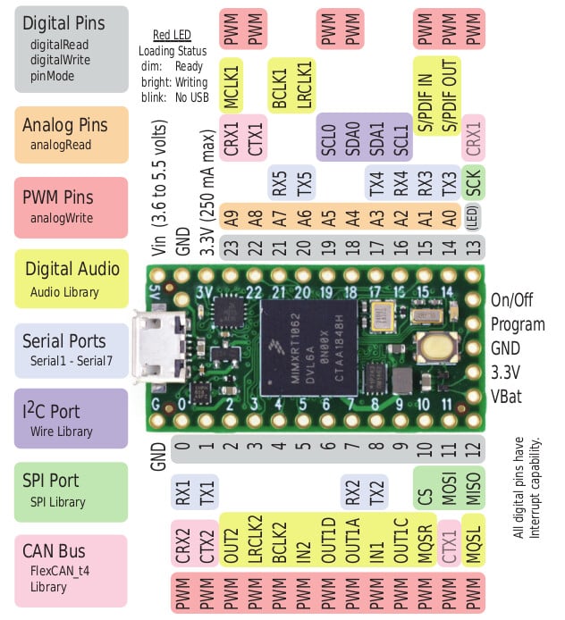

You shouldn’t need the ethernet adapter just for color sensing, we simply have it plugged into the Rio USB port with a micro USB to USB cable. Make sure that the cable you’re using actually has the data pins connected; we found that a lot of the micro USB to USB cables lying around our shop were power only.
Our Teensy came with this on a printout as a handy guide. We have the REV Color sensor plugged into the GND, 3.3V, SCL0 (19) and SDA0 (18) pins.
