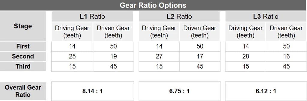

You are going to notice really quickly if the gear ratios are incorrect, I recommend looking at the way other teams have their MK4i constants, as they are bound to be similar in some sense. Our MAXSwerve constants can be found at our github.

Here is an image with the gear ratios for SDS MK4i modules.
