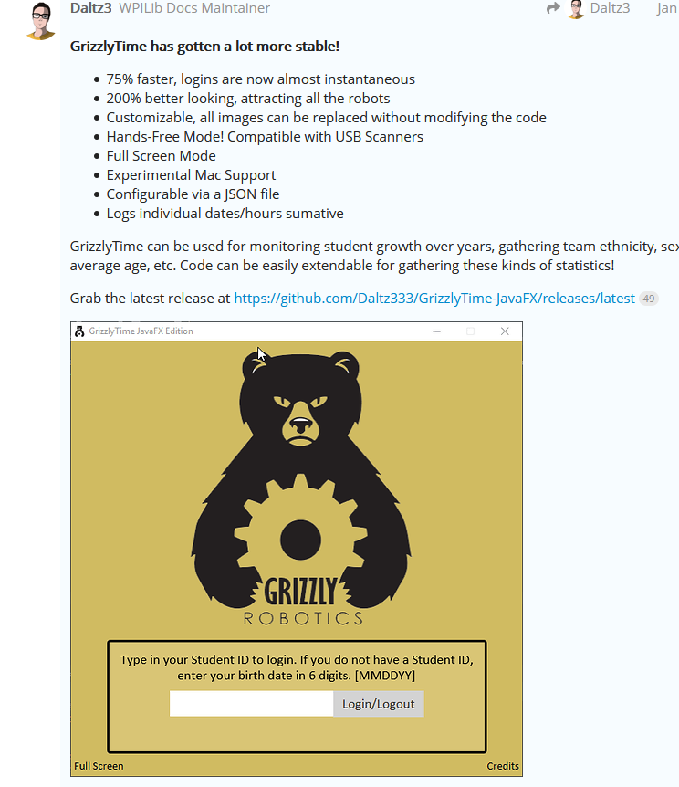

We use FalconHours, our fork of GrizzlyTime by Team 66. We run the program on a Raspberry Pi, connected to an old spare monitor:

I’m just gonna shill GrizzlyTime. It’s an extremely portable time tracker and even gives you some pretty nice analytics and graphs compatible with Google sheets.
Additionally the registration for each new team member is done in-app and takes an average of less than 2 minutes.
