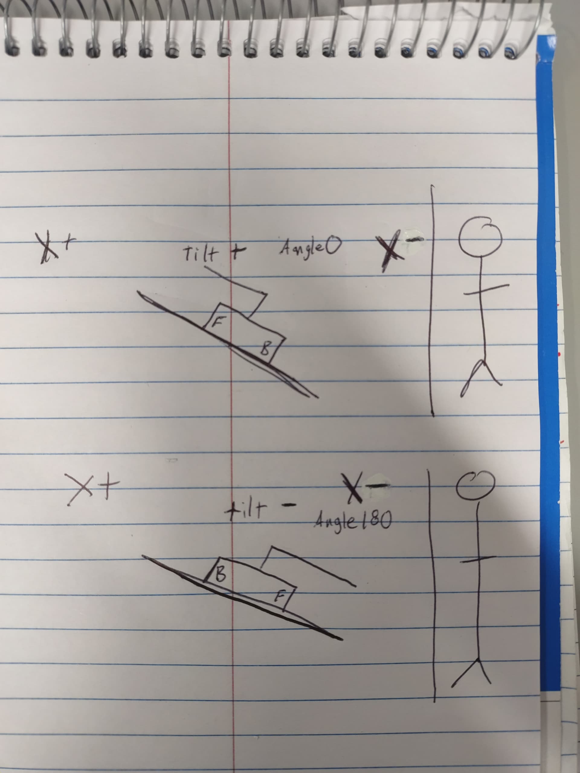

I’m sorry I just can’t wrap my head around the fact that +x driving would always be away from us but positive Gyro tilt may not be. How does this translate to driving towards positive gyro tilt?
Like I said I think I am over thinking this.
so assuming you are driving in field relative, at least ours is setup that +X drives you down field, -X drives you up field. +X towards the other alliance wall, -X towards your alliance wall
Your going to use pitch off of your sensor. If the nose of the robot is tilted up, that’ll correspond to one sign. If the nose of the robot is tilted down, that’ll correspond to another sign.
It just depends how everything works, you may find that when your robot nose is tilted upwards (implying you need to drive forward to level), it gives you a negative pitch, in that case you’d have to flip your sign. But this should always remain consistent. If your robot is facing upwards via pitch, you’ll drive +X, if its facing downwards via pitch, you’ll drive -X. The trick is to just make sure your pitch’s sign agrees with that, and if not add a *-1 or something. You can probably also invert it in some of those sensors if you want to too
Right but what if you do this in teleop and drive up the station backwards? the sensor reading are going to be inverted but the field relative driving would not be.
Facing away from drivers front of robot up equals positive gyro tilt and then facing towards drivers with front up still equals a positve gyro tilt but you have to tell the robot to drive positve X in one example and negative x in the other example.
Auton would be easy because we can know which way the robot will be facing but in the heat of the match the driver is going to drive up which ever way is quickest.
I suppose we could say if gyro tilt is positive and gyro angle is closer to 0 degrees drive this direction and if tilt is positive and gyro angle is closer to 180 degrees drive the other way?
the sign of the gyro tilt will dictate which way you drive. I think you might be overthinking this.

Sorry for the crude drawing but this is what I mean.
Wouldn’t you need to drive the robot differently in these 2 cases?
I think the gyro angle is the part I wasn’t thinking about. That is still going to be 0 in one direction and 180 in the other.
Maybe this is a pigeon thing but your gyro should be smart enough to understand this. Just try it out. I see what your concern is, from my understanding it will handle this for you
We can approach the Charge Station from either direction. Write the balancing assuming one side only. Then add these for complete robustness in case you decide to approach from the other side. We assume gyro yaw 0 is down field and we backup from the grid to the Charge Station (yaw 180). Adjust for your circumstance.

Yeah that’s the part that I wasn’t thinking about at first. I think that will work for us.
