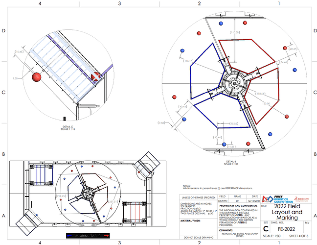

My team and I are struggling to find the specific measurements of each of the 12 cargos that are staged in the auto period.
we need a reference point to the center of the field or (preferred) to the bottom left corner of the field.
Figure 6-2 tells you the radius of the circle they sit on, if you already know the size of the Tarmac.

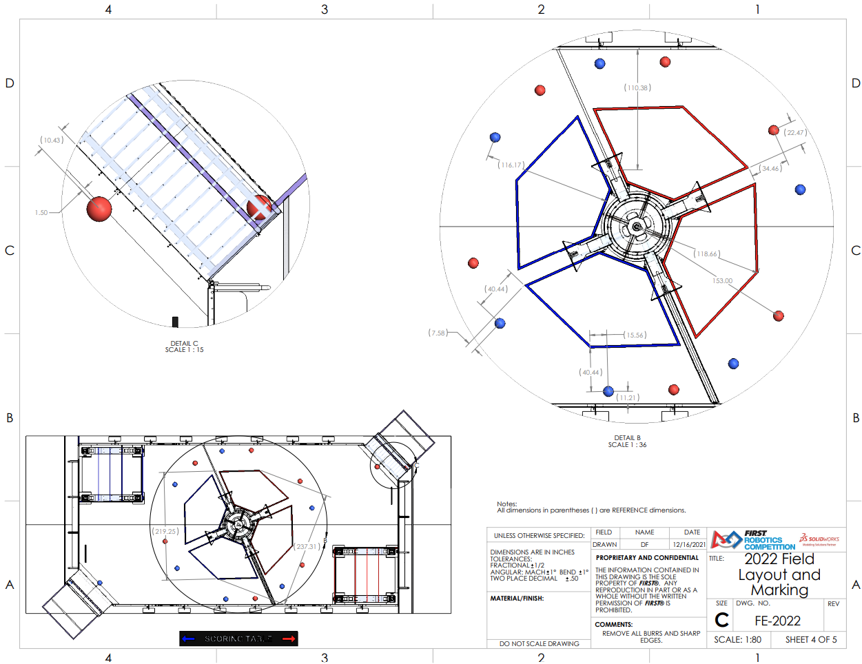

It’s not on the Layout Markings Diagram here? Drawing FE-2022 Sheet 4?

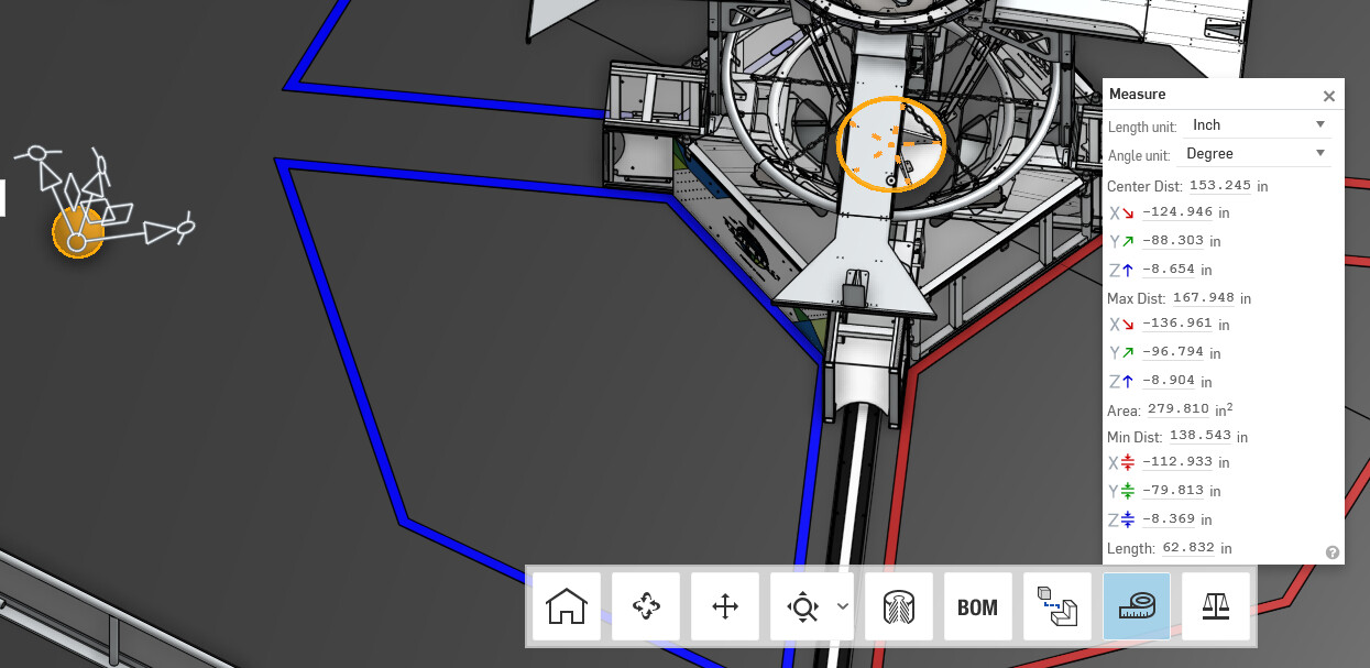

It was easiest for me to use the Onshape model.
Basically, click a cargo, then something central to hub. I’ve been using the lower hub circular base edge. Then click the tape measure to pull up the center-to-center distances for x and y. I have a tape line with the hub that is parallel to the field walls, that I use to measure along for y and perpendicular to for x, to make the placements.
This is also how I taped the tarmac by selecting the tape corners.

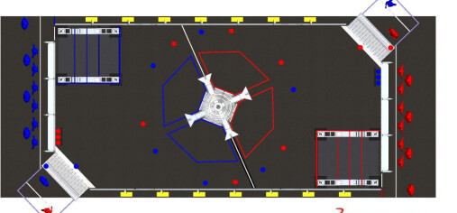

OP can correct if I’m wrong here, but I believe they are referring explicitly to the 12 cargo placed around the hub on the 25’ - 6" diameter circle at the beginning of a match (so 6 red, and 6 blue).
yes, that’s what I was referring to in my post above
I actually ran the FIRST drawings and rules thru an AutoCAD drawing, trying to recreate the Field for my team. I then sprinkled a small amount of pixie dust to make it resolve to actual locations. (This is typical every year for converting engineered drawings to real life imperial dimensions.) As far as I can tell, the Cargo are 30-inches apart on the 12’-9 radius circle, starting at 15-inches off the center lines of the four dividing quadrants. (30" on the arc or 30" straight?) Take that with a grain of salt – I certainly will. (Some of the dimensions were off from each other by < 1/2".) Hopefully by the time I have to actually build a Field in March there will be easier specifications.
