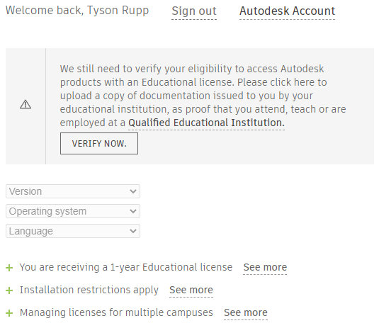

Hi, I’m Tyson from team 5413 I normally work on CAD for our robots so I wanted to upgrade to Inventor 2021. The only problem is that now for some reason I cannot get a free student copy that Autodesk normally provides. Ever since 2017 I have been using the free student copy of whatever current year it was, but this time when I went to upgrade it prompted me with a new message I haven’t seen before. It was asking me to “verify your eligibility to access Autodesk products with an Educational license”. This is problematic because the rest of my team hasn’t gotten this message and has upgraded to 2021. When I go to verify my eligibility it takes me to this screen where I have to upload something showing proof that I am enrolled and or work there. In previous years or even a couple months ago this was not a thing to my knowledge. I have seen that “First Robotics” is one of the options you can pick for an institution but I still have to verify myself. In past years I have used my teams name and that worked perfectly fine. Getting down to what I need to know is if anyone else has had this problem and if so how did you go about fixing it or working around it?!

They said that they are now taking eligibility more seriously by using SheerID and that I must contact SheerID to handle any verification issues.
I am doing that and will relay what they have me do.
I have an existing (institutional) Autodesk Account, and have previously been validated by SheerID.
All I had to do today was login to Autodesk, verified the information they already have on file (name, institution, etc), and I was automatically approved via SheerID verification.
