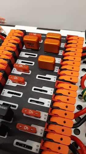

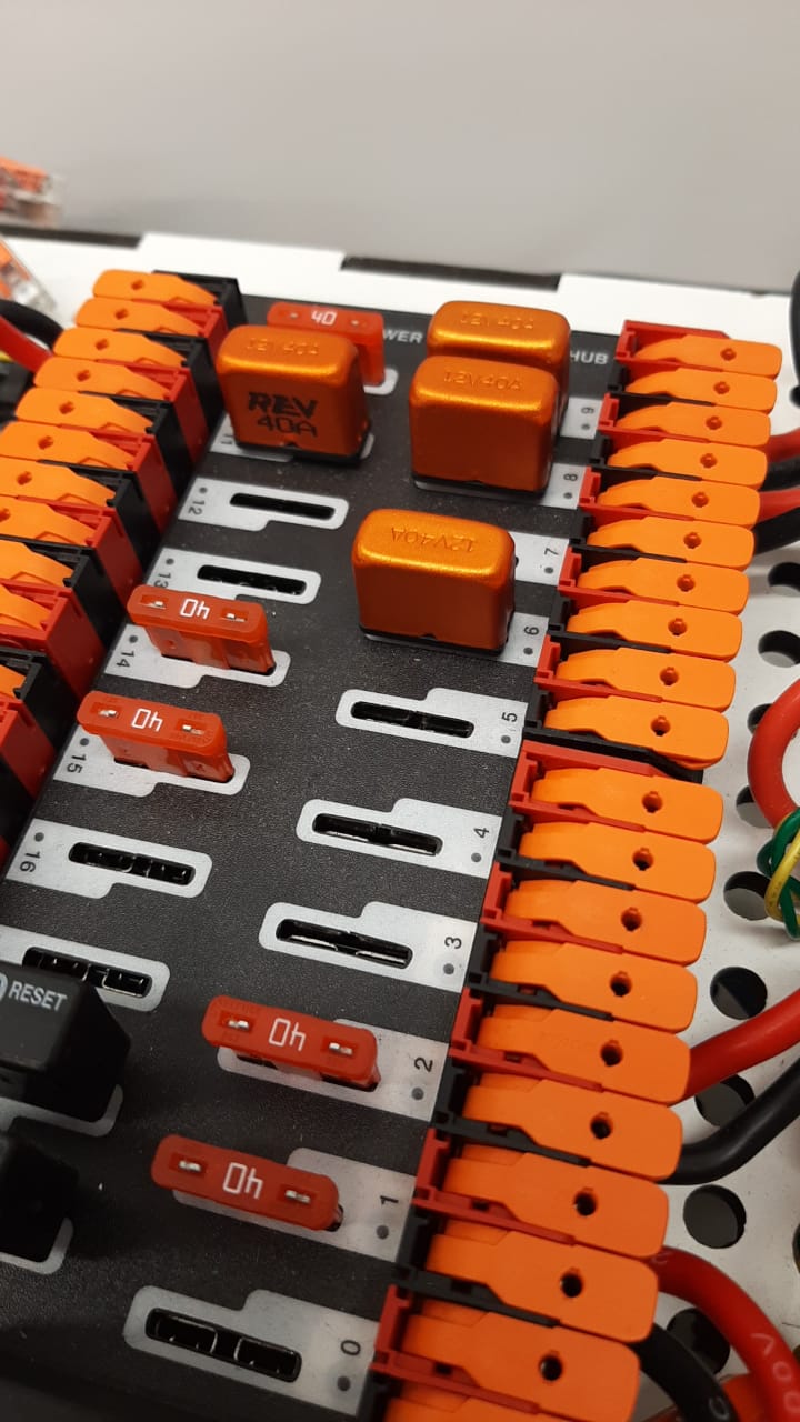

Hello ChiepDelphi. I have a doubt regarding the fuses that can be used in the PDP REV.
We don’t have quick access to the official 40A ATO Auto-resetting Breaker REV.
So we use a commercial automotive fuse.
Is it possible to use these fuses in official competitions?
If they aren’t listed here then no.
They are not on the allowable list per the rules.
On top of which: if one goes, that circuit is done for until you can get in and change it.
