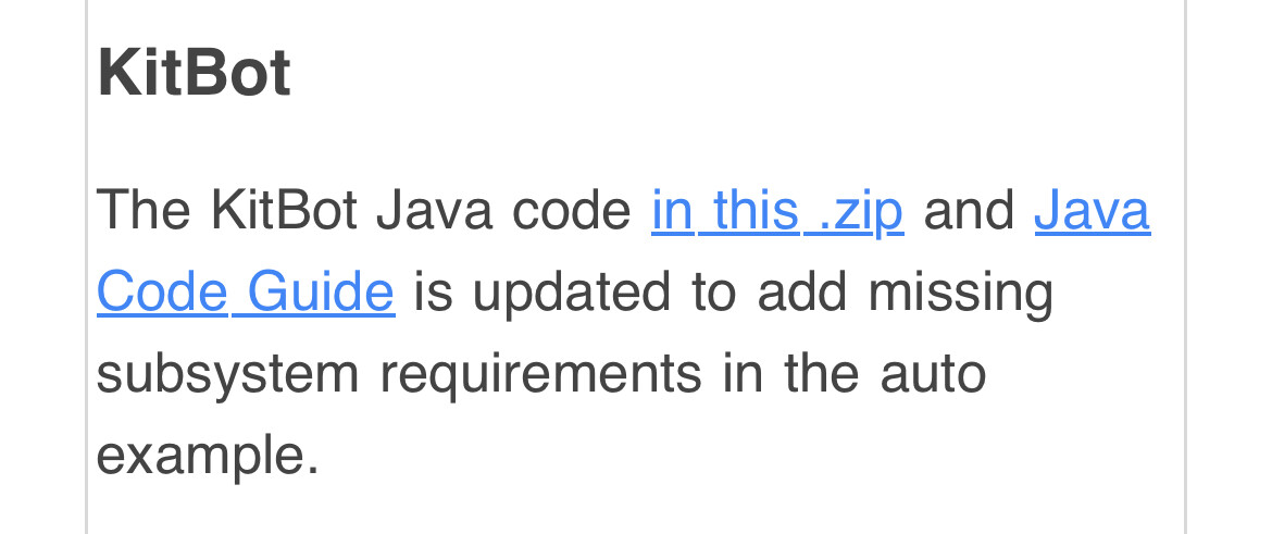

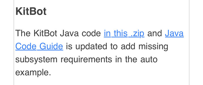

Looking at the code again, I believe the lack of requirements in the created RunCommand is a mistake in the Java code provided by FIRST (it appears correct in the C++ kitbot code). I’m not sure whether this is causing OP’s issue or if something different is going on, though.

In Team Update 05 they fixed this!
