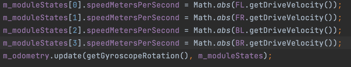

I’m a programming mentor for FIRST Team 5804. This is the teams first year using swerve drive and it’s been a great learning experience so far. We’re using MK3’s and got things driving using the SwerveDriveSpecialties swerve-template as a starting point. Now we are trying to implement PathPlanning for autonomous and are having some challenges.
We are using PathPlanner 2.0 to generate our Trajectory and the PPSwerveControllerCommand to make the robot drive the path. We have had some success with this so far - the robot drives the general shape of the paths generated, but isn’t being consistent on the distance traveled. Some runs it will be spot on, others won’t go far enough or will go too far, and sometimes it drifts, sometimes it doesn’t (all with the same code starting from the same starting spot). Has anyone experienced this before or have any tips for making path planning autonomous more consistent?

So we are doing pretty much the same thing and the eureka moment is when we added these lines:
Hope this helped!
Eureka! That was it! We weren’t updating our odometry correctly. Once we added this in things fell into place. Thank you so much for your help and speedy response! You saved us a bunch of time and we have working path following now.
Np! Good luck at your comps
