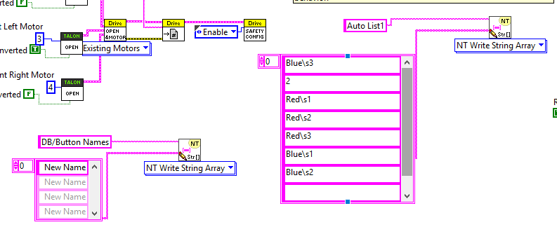

We have an array that is supposed to define our autonomous options, however driver station appears to be stuck with old options! Any idea why this is happening?
Auto List 2|690x310
It’s the “1” in the key to the write. The DS uses “Auto List” no 1.

That worked perfectly thanks so much
