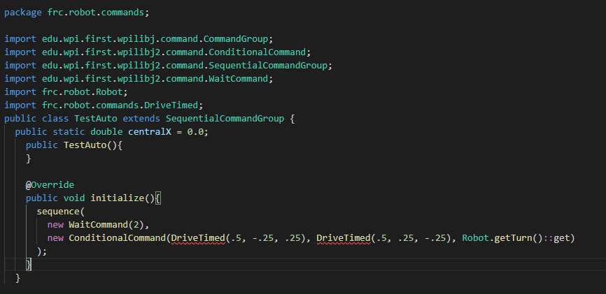

Autonomous program won't recognize another command
I’m currently updating my autonomous code to the 2020 “convenience feature” setup. I ran into a problem where it can’t use a command with parameters (double, double, double) even though it has been imported. Any ideas? Also, am I formatting this autonomous code right or should the sequence be inside the TestAuto() constructor?
also, DriveTimed() extends SequentialCommandGroup, don’t know if that matters
nvm figured it out
It would be great if you put the solution here for reference to people with similar issues in the future.
The solution, I expect, is that it is missing the new keyword, I.e. new DriveTimed().
