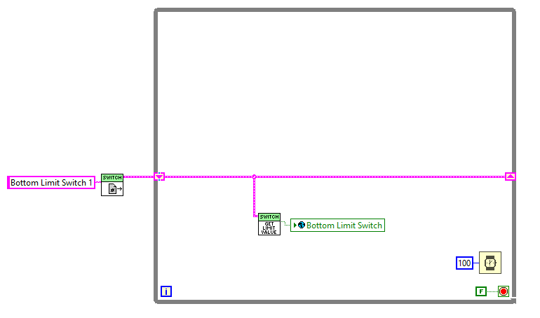

Ok, not a rookie, but for sure no expert. Is there any way to access limit switches that are set for arms in Teleop during Autonomous? We have limit switches that work during Teleop perfectly and would like to move the same arms to a position and have them stop. I thought…limit switch in auto…hmmm. I tried and the switches didn’t stop the motor. Can this be done? Maybe I just made a mistake in creating the Auto program. Any help would be great.

Are you opening the switches in begin?
If so, they should be accessible in auto. Put the sensor “get” with the correct refnum name in the same loop that you’re using to run your auto mode.
Something that might be tripping you up, in the Autonomous VI you have to add while loops yourself where they make since.
If you post a screenshot of your code (ideally showing all cases of case structures) we can help you better.

In periodic tasks query your limit switches and set Robot Global Data Variables to their values.
Then in Auto or Teleop just look at the RGD variables and not directly at the limit switches.

I’m not sure why you see more complexity. We do the same. We have a single loop that polls our sensors and saves the results to globals. This allows you to use them in both teleop or auto, and doesn’t require you to put gets in both to use the sensors. It’s quite clean and simple. It also has the benefit that your sensors are polling in disabled so you can feed them to your dashboard and probe them for troubleshooting, all without enabling the robot.

So your periodic task would look something like the attached image. “Bottom Limit Switch” comes from a Boolean you put into “Robot Global Data.vi”
Then you can just get the value in Teleop or Autonomous
Here’s a snippet of what it would look like in Teleop
