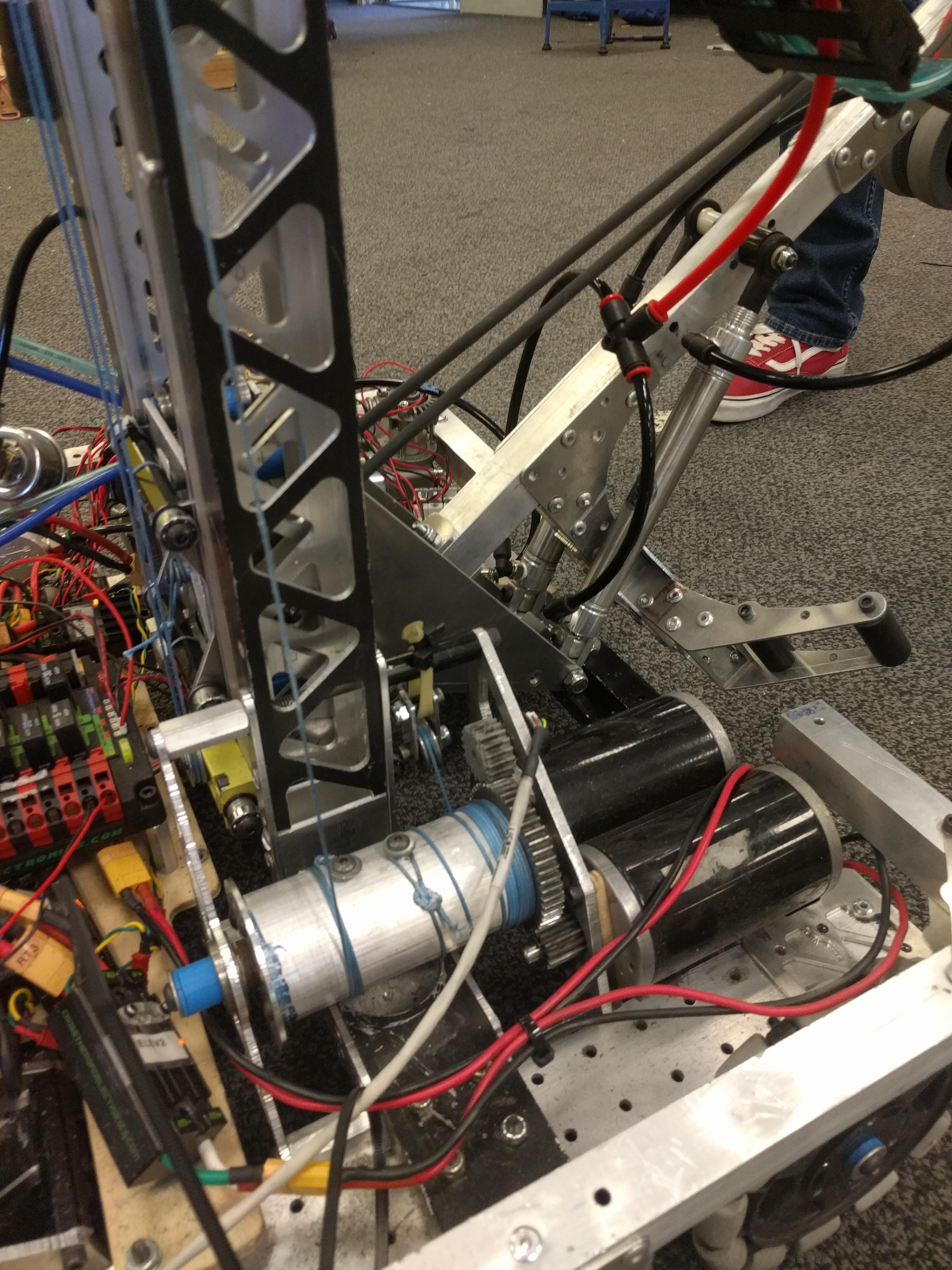

Typically you want a nice wide spool with a somewhat optimal Fleet angle. But our spool was incredibly thin this year with rope spooling on itself 2-3 times and we never saw any issues.

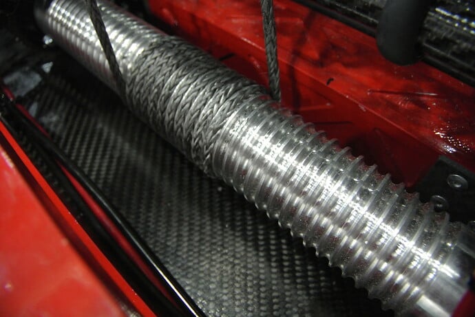

If there’s enough packaging space a grooved spool with a fairly small fleet angle will cleanly wrap only a single layer of rope which won’t allow the rope to bind on itself.

I don’t have any experienced with the grooved pulleys that some teams have used, but they do look pretty slick (2471 here):
I can confirm that a threaded spool is super nice, we never had any binding or tangling problems. However machinability can be a limitation of this design. We were lucky enough to be able to machine it on a four axis mill at our local community college.
